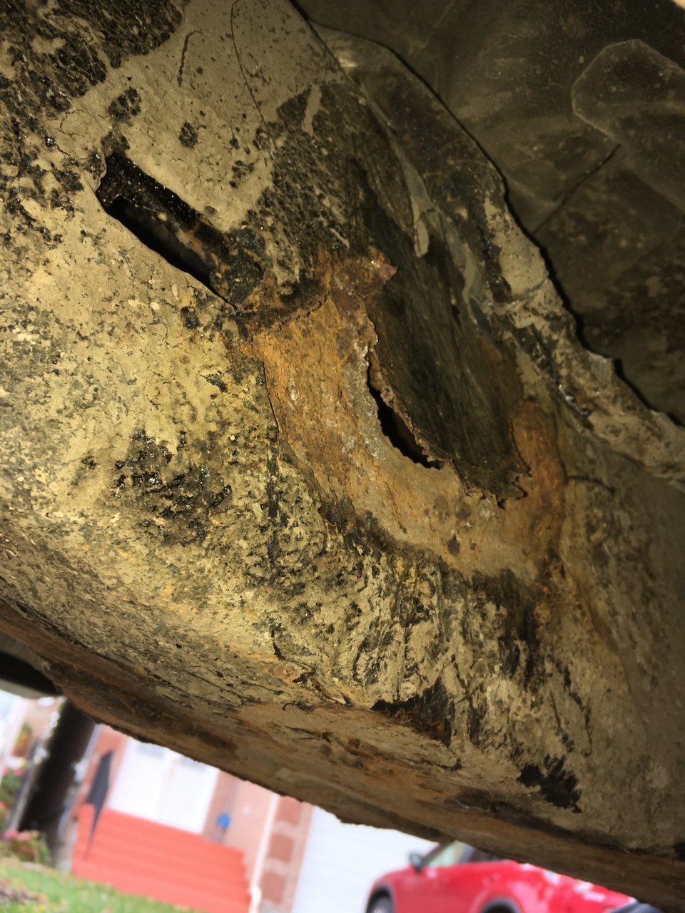

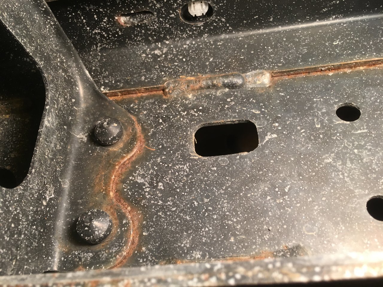

    i plan on bringing mine in after this winter. im a tech at a honda store in a automall here in jersey, that luckily has toyota store and i know a few of the guys over there. im hoping to get a new frame! this here was the worst part on my frame when i last had it on my lift doing the oil change. drivers side next to the cat converter. 64,500 miles on my 2010
  2. Dec 24, 2017 at 2:31 PM
    #22
    Doogz
    Doogz Well-Known Member
    Apr 23, 2017
    #217122
    768
    Bryce
    Western MA
    2009 MGM AC
    yep..
    I'd be willing to bed there's some hidden carnage on that frame. But you never know.

    Smack that spot with a hammer/chip at it with a screw driver for a bit and see if its hollow underneath.
    I had a very similar looking mark beside my cat coverter on the passenger side of my truck, I chipped at it for 30 seconds with a screw driver and the top layer peeled off and revealed a gaping hole about 1.5" wide in the frame. Had it inspected at toyota and qualified for a new frame, im supposed to be having the swap done in a few weeks. The rest of my frame was immaculate, it was only that ONE spot that qualified me for a new frame

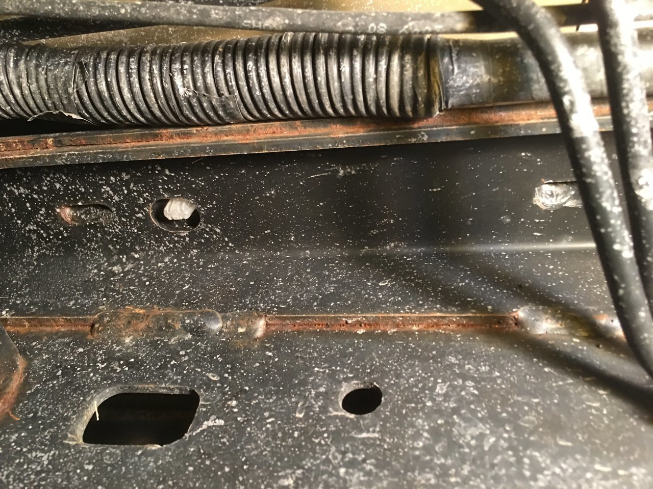

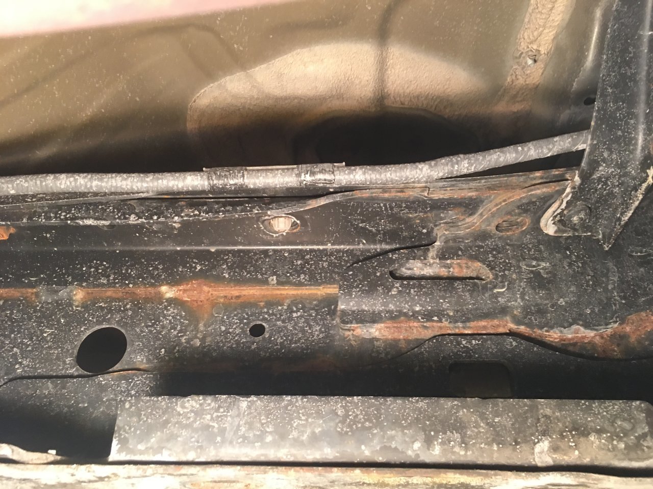

    Here’s my worst rust spots. Not really too bad yet considering the amount of salt Pa uses on the roads. 2013 with just over 70k mikes. Bought new in October 2013. I will not treat the frame. If it’s going to rot, I would rather let it rot at the ‘normal’ rate and have Toyota replace the frame during the normal warranty period. I worry about treating the frame and extending the time it takes to rot, putting it outside the warranty period.D33906F6-B267-42CE-9C4F-C9386A428B84.jpg 3F080961-B2F2-4D23-9DE3-2A8E7B3DE1B3.jpg6705ECA5-0BA2-4087-93E2-93D49BD64686.jpg530132B7-B470-47DC-AE32-0EAF7841C61B.jpg972C0263-0B11-413A-A4B2-27C8FA2AB809.jpg352298CA-74F6-4EBE-9EA0-C6E60A9B1DCC.jpg21CEE4C3-A214-4AC6-912E-3CCDF5522D2F.jpgD33906F6-B267-42CE-9C4F-C9386A428B84.jpg

    This whole frame replacement fiasco with Toyota is only happening because Toyota had a different manufacturer build their frames years back (and they screwed up with the spec on the frames and didnt apply proper corrosion resistance compound). I dont believe 13's have the same issue as the 05-10s in terms of rotting right through regardless of application of oil spray or not
    The rust youre seeing is completely normal for a 5 year old vehicle in an area that salts its roads in the winter. I cant see it rusting like crazy that quickly like some of the older trucks. So purposely not getting it rust-proofed in hopes Toyota will just give you a new frame in a few years probably isnt the best idea. The whole swap runs around $16,000 or so ive heard, they dont just give these things out. It took a lot of time, lawsuits, and customer complaints before they even started the initial recall.
    Some of the original 07's that were sold 10 years ago had the frames rotten right through in only 3-4 years. So the fact that youre seeing barely any rust after 4 years makes me think that you shouldnt be expecting the same treatments us older trucks got.. :rolleyes:

    The frame is no different than a 2010, 2011 or 2012. If Toyota had miraculously changed the frame, then there would be no need for me to treat the frame anyway.
    You must be new to the Toyota frame issue. :)

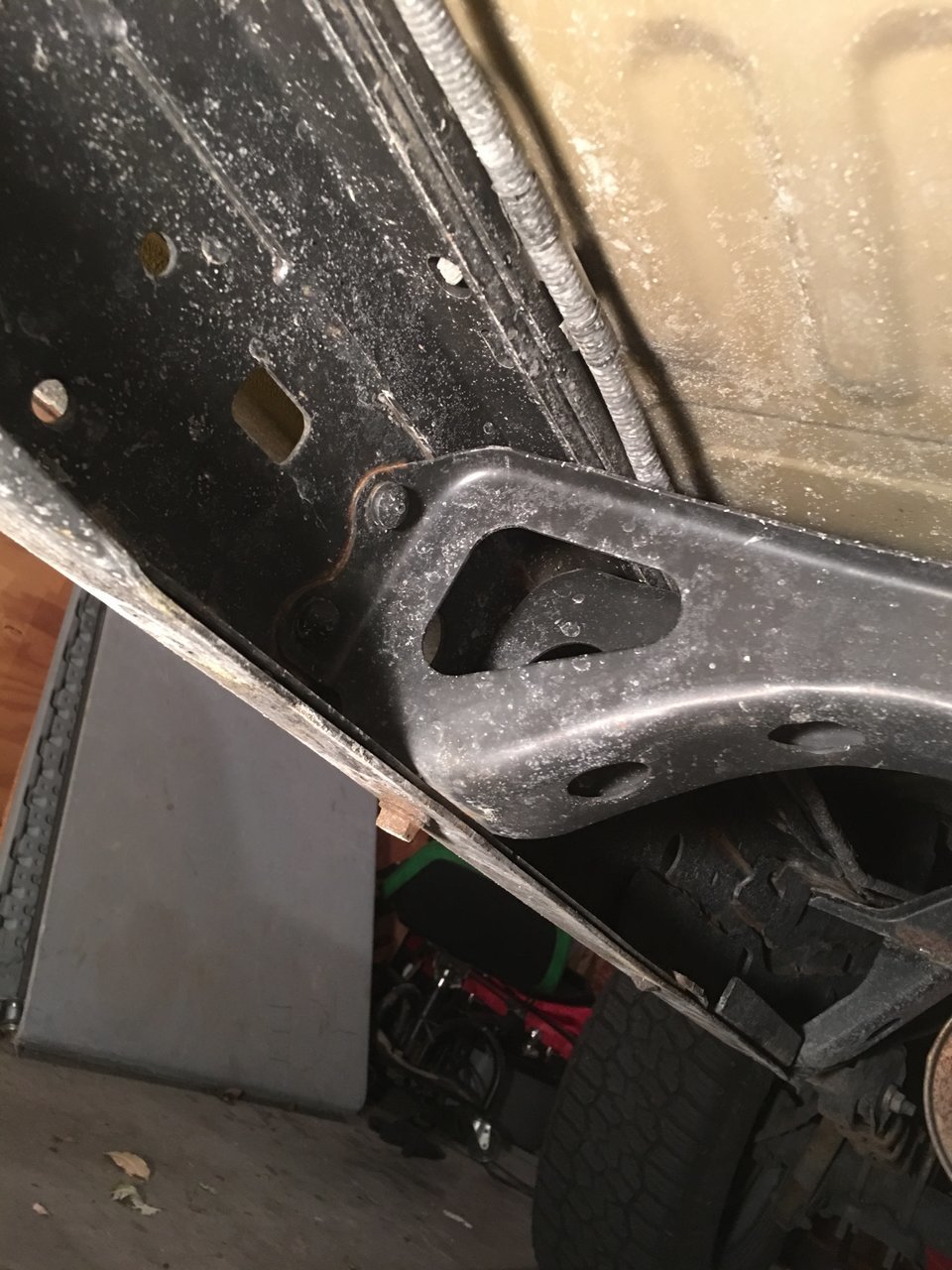

    I agree the frame on the 2013 is mostly on the weld seams which I considered normal for a salt state. My 07 rotted at catalytic converter location and some seam area in rear. I took care of my frame but I don't think it mattered. Yet my brother in law had a 14 and did nothing to care for frameandhad zero rust so I think the older frames are different. Good lick and Merry Christmas
