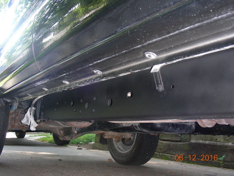

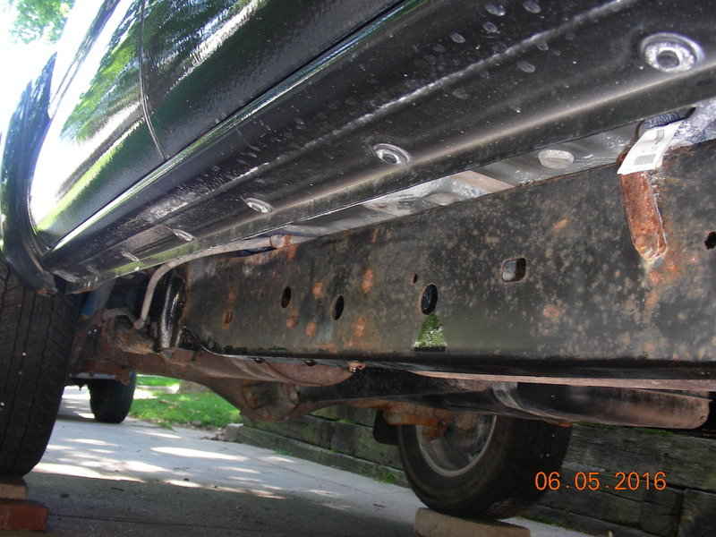

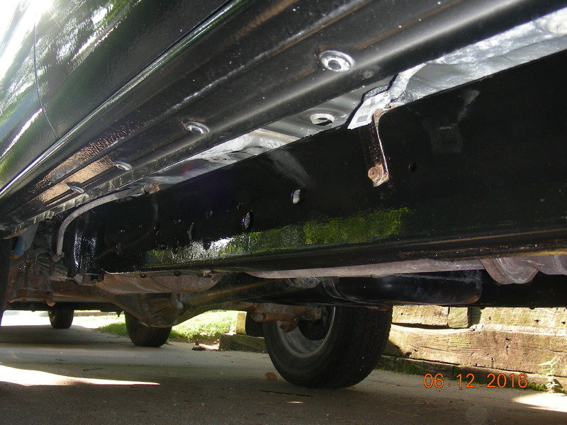

    I'll find the other post that someone wrote up on POR15 but here are a couple pictures of my job.
    Before:
    After POR15
    BTW I wasn't on who was constantly painting it when it was 'tacky' as the instructions imply or say to do but I did try. I am still touching places up with the rattle can paint.
