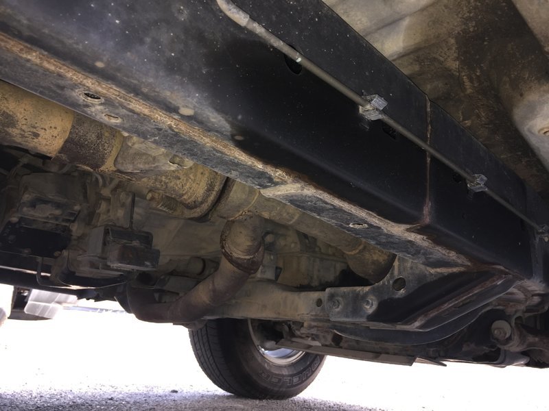

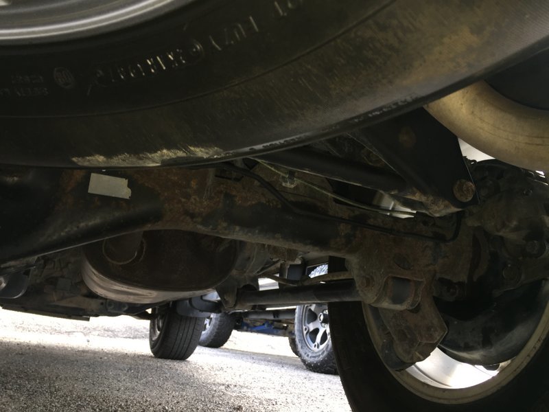

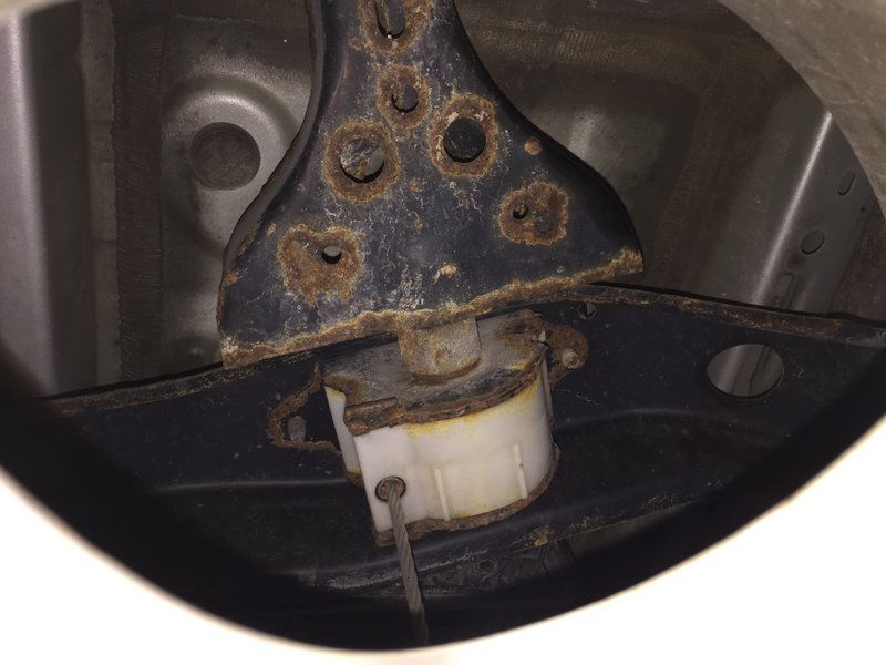

    im checking out a 2006 4runner with 137,000 miles & the frame looks pretty good minus a few spots. Any opinions would be great! I'll attatch some pics.

    Not too bad, but not great either. The 4Rs don't have near the rust issues as the Tacomas, which is good. Most of that could probably be wire wheeled and then painted. Where is this truck and where do you live?

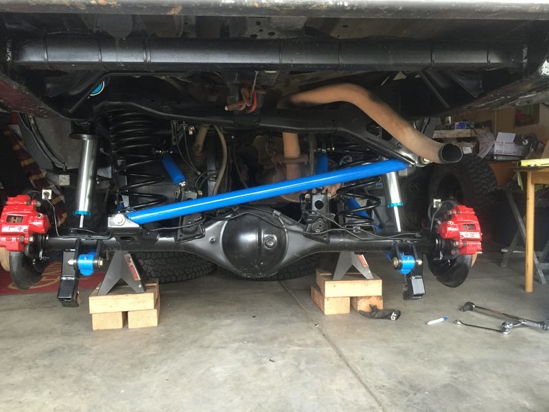

    If you are willing to spend the time to clean it up, it looks like it should hold up, not near as bad as the other one you posted. Here is what you can do with a little determination and elbow grease, mine had a pretty good amount of surface rust prior to this.

    How much? I think that looks typical for a 10 year old Toyota. Wire brush, paint, and fluid film.
