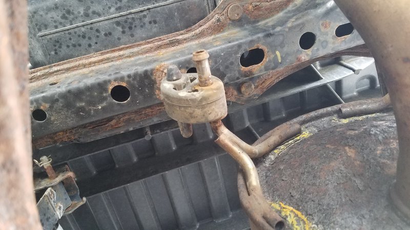

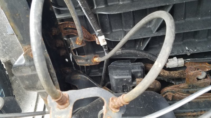

    Thought I would add pictures of my 2010 with 14K miles on it. The truck spent its life in Rochester, NY where they salt the roads like crazy.
    TRDSport10 and tomwil like this.

    Lol, I think "screwed" is an exaggeration. And you know its not realistic for the average person to take the frame off and dip it in epoxy...

    Yeah, except you have to sell the rusty truck to another unsuspecting person. I'll make a decision after the lawsuit is finalized and they deny me the frame....

    Just got back from getting the frame inspected. Surface rust. Treat it, Use the Eastwood internal frame treating, move on with life.
