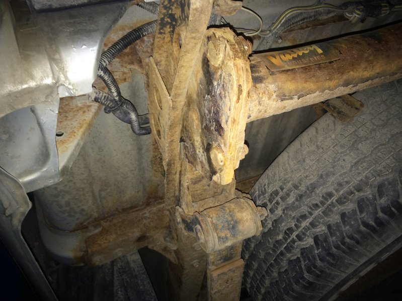

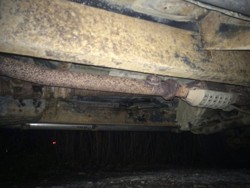

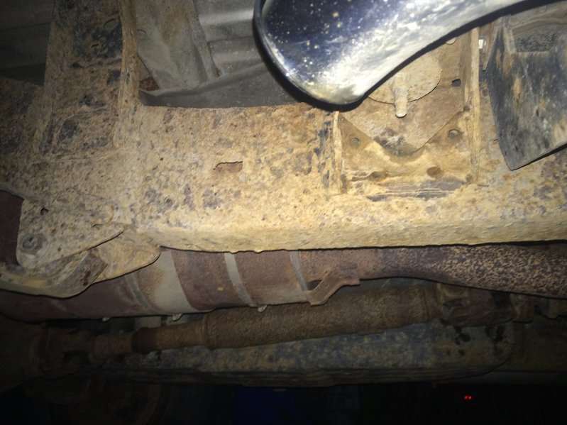

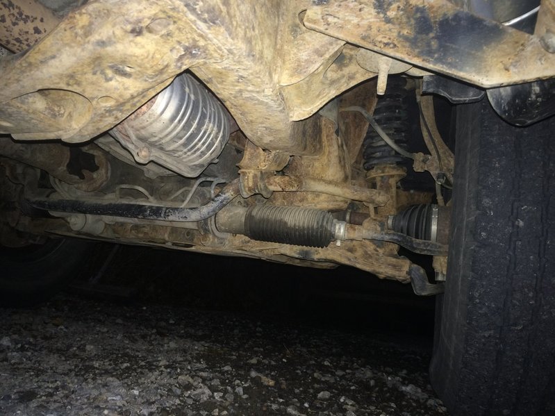

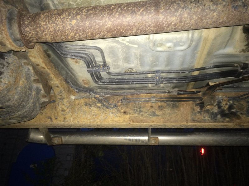

    I've been looking for a tacoma for a long time now. Found one that looks decent and good price. 2003 w/272 000kms. I have researched a bunch on what to look for, but I'm unsure about what to look for regarding frame rust. Says the recall was done, or at least it was looked at by toyota. I'm gonna check it out tomorrow anyways but wanted people's thoughts on these pics. Keep in mind this in interior BC so some rust is expected.image.jpgimage.jpgimage.jpgimage.jpgimage.jpg

    I talked with him again, says Toyota didnt do the frame recall on this one, just inspected and rust proofed. Perhaps not a great job..
    Im now wondering if it was done by Toyota, if they would look at this frame again if it was sprayed. Maybe I will call them with the VIN?

    Go to the My Toyota website and put the Vin in. It will give you service records. If Toyota looked at it, it would be listed there.
    Toyota looked at mine and sprayed it a couple months before the deadline...I still needed a new frame. Looking at the pics of this one, I'd a new frame is definitely in the future. Make sure the truck was looked at by Toyota and is eligible for frame replacement before you buy, unless you have the ability to fix it yourself.

    Thanks. I will try the VIN number and see what it says. Looking at the pics, my gut is telling me don't get it unless Im sure that a frame job would be done by Toyota. Hopefully its not too much work to figure out, as I know if I leave the truck after my viewing tomorrow it will sell quickly. But I don't have the means to repair a frame myself, and I would like to own the truck for a while.

    Well after looking at the frame in person, I trusted my gut and walked away from the rust. I talked to the Toyota dealer and realized I had no options on that frame. Best to wait for a better vehicle. The search is killing me slowly though ):
