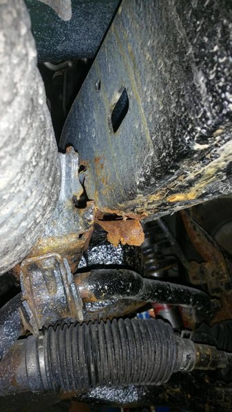

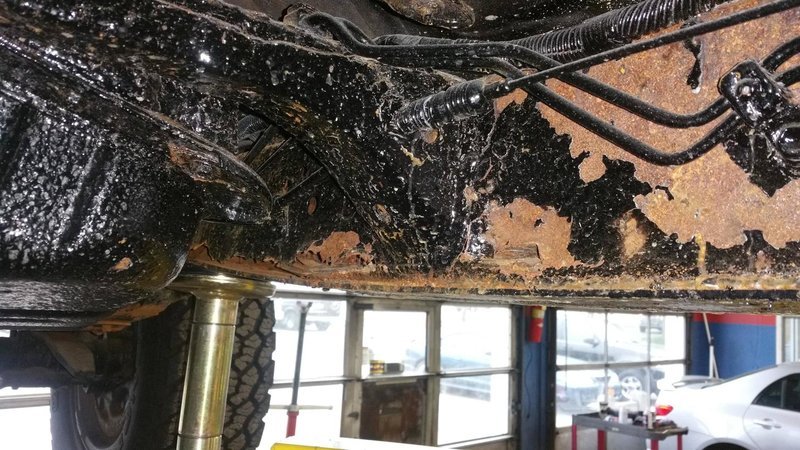

    I have a '98 PreRunner Extended Cab. It's live its whole life in the San Francisco Bay Area, probably less than 50 miles from where it was built at NUMMI in Fremont. It barely rains let alone snow.
    Now I see all these photos of these horribly rusted out frames from the salt belt states and it's a little terrifying to see it like that. My frame isn't perfect, it has a little surface rust but it's seems normal. Nothing like the rust that I see that eats through the frame from the mid-western states.
    Is there anything I can do to protect the frame from failing? I don't want to have to replace the frame one day. Since I don't live in the salt states I don't qualify for a frame replacement. My frame is fine other than the light surface rust, but I don't want it to rust out in the future.
    I saw a post over on Reddit with a '98 someone bought at auction, the whole frame is basically swiss cheese. It was kind of a shocking wake up call for me, lol.
    Here's that frame (not mine thankfully):

    There's a reason Cali isn't included in the recalls. It's just not a problem (that I've seen) here, even on the coast. Yes, there is salt in the air in SF, but it's orders of magnitude less than the salt being thrown on your car from the road salts.
    If you're worried about it, though, it get under there, clean it up, and rap a hammer along the frame. If there's significant rust, you should hear a big difference in the tone.
    If not, rattle can some black primer on the frame and you're good to go.

    If the frame looks like that there is NOTHING that can be done. The metal is delaminating from the inside out. The lovely paint they applied just makes rust fall off in bigger clumps... trust me I dealt with all of it. Fluid Film is a good product but needs constant application for surfaces that see any road spray from rain or snow.
