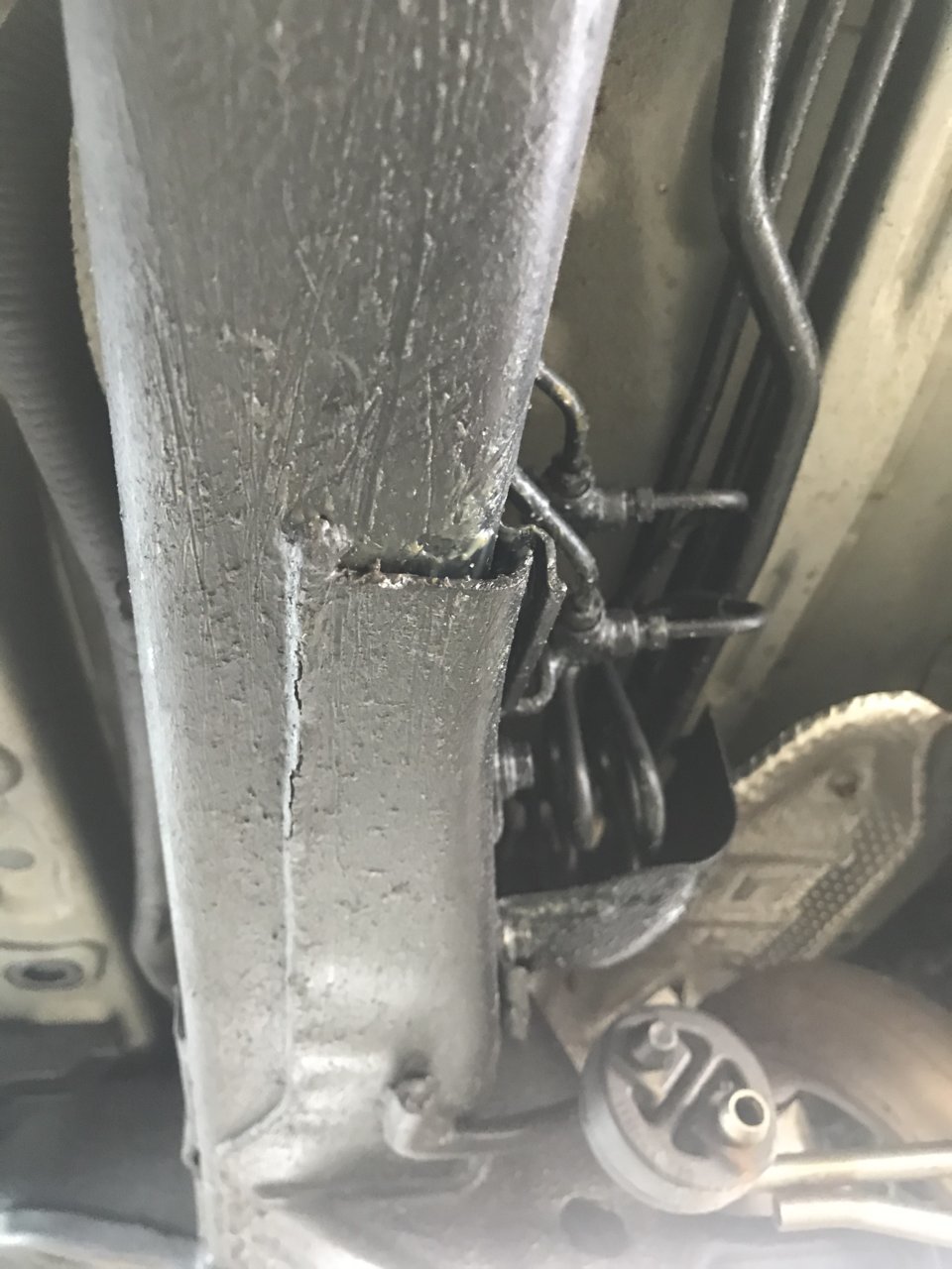

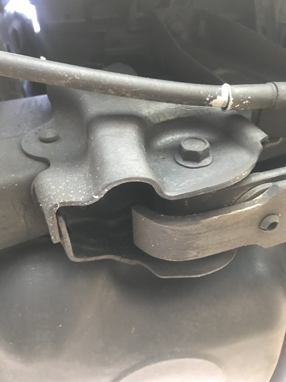

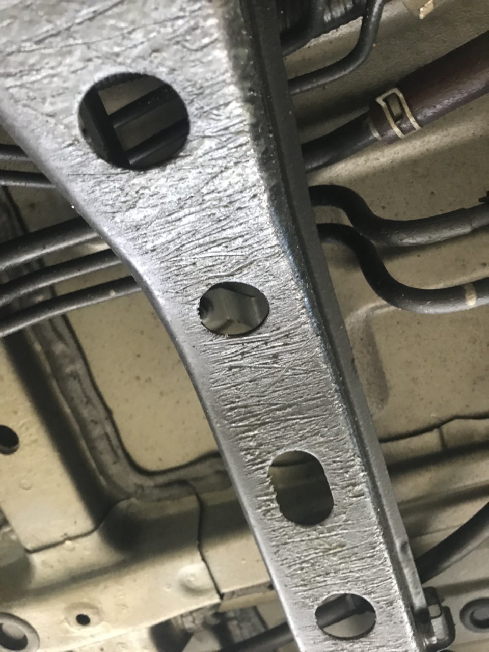

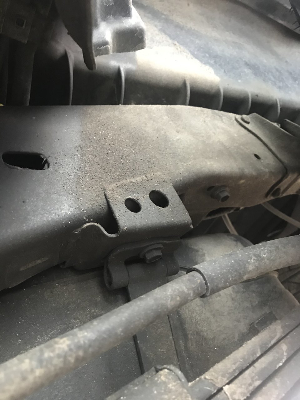

    Hey guys,
    I know this is an old thread, but I just went through a rust abatement/prevention for my sons 2nd gen and I though I would update anyone looking for some real-world results.
    I started by using a foam sprayer and several coatings underneath the truck of degreaser (purple power and brake buster) followed by intense scrubbing with tire brushes, wire brushes in power drills and pressure washing. We specifically targeted the frame and areas where the multiple previous Toyota frame treatments were applied and now flaking off. We probably did this 3-4 times until we had used the entire gallon of degreaser and were comfortable we had removed all foreign material and rust we could. We then let the truck sit for a day or so to let all of the water and condensation evaporate and drip off of the truck.
    Next, we started applying product to every surface underneath that was visible. I looked at a lot of different products and was struggling to make a decision. I tried contacting the Eastwood company as I've seen some positive comments around their products, but their pre-sales support had absolutely no interest in helping me pick an appropriate product... and honestly it was not a good experience. Thinking back to my military days, I remembered we used some cosmoline products... so searching I went. I found a product called RP-342 on Amazon and decided to take a chance by purchasing an entire case not knowing how much we would need. We ended up applying 3 fairly heavy coats and used 5 cans to coat the entire truck (frame, body, f+r suspension, rear bumper). The product applies from an aerosol can with the included straw and was very easy to spray into crevices and coat large areas with just a creeper and some cardboard underneath the vehicle. It can be a little messy, but the results were much better than either of us had expected and each can sprayed for much longer than we expected. It dries to a very dark brown (somewhat translucent) color and seems to provide very nice protection once cured. The real results will be understood next year but the process was so easy that I decided to apply RP-342 to my new Tundra just as an extra preventative measure. We had his Tacoma completely done within a couple of hours.
    Not sure if this will help anyone else, but the results were satisfactory for us and we're pretty particular with our Toyota trucks.
