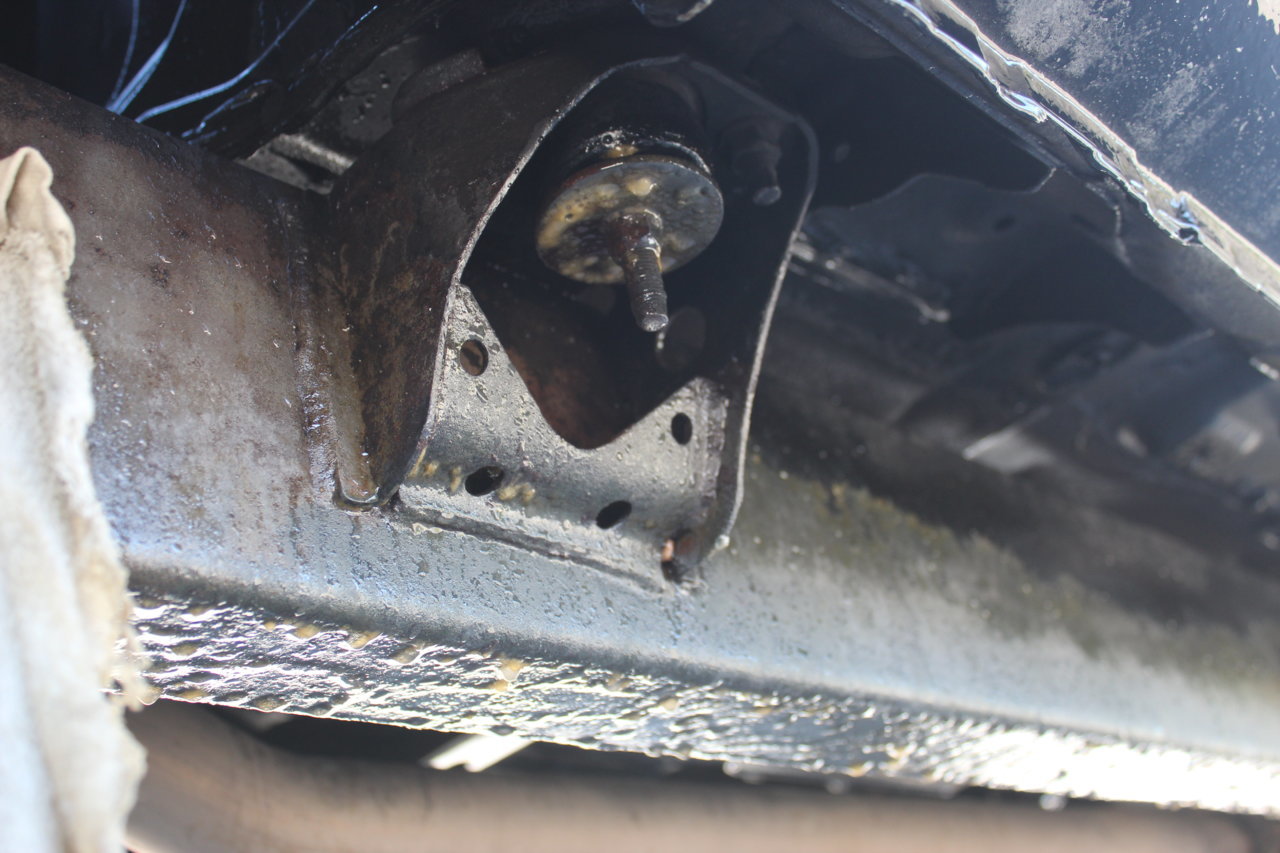

    ran my truck through the auto wash with pressure under carriage spray for the 2nd time (in 2 days) to check the durability of the FF
    is it coming off quicker than it should?
    what do i need to look for
