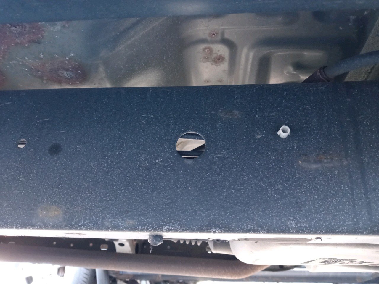

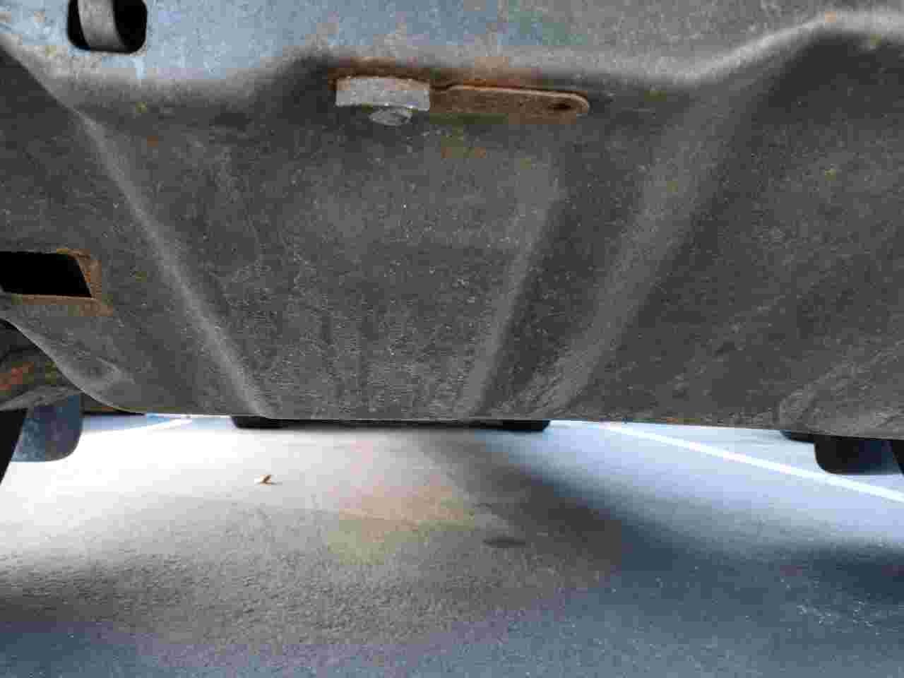

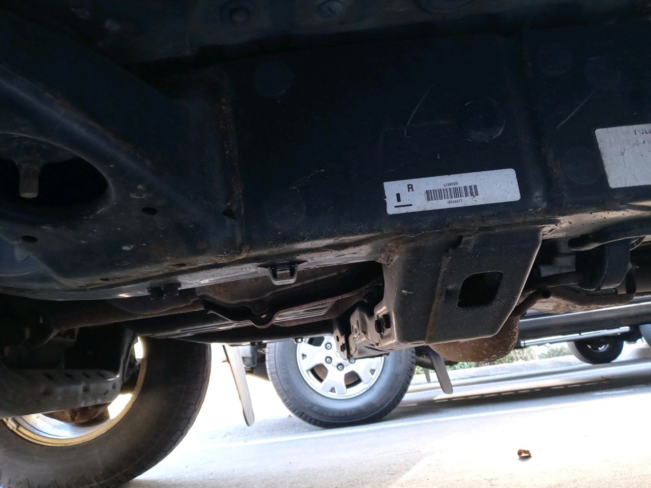

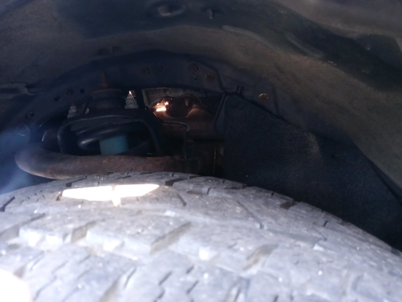

    just checked the VIN. it's had the frame replaced in 2018. just got these pics from the dealer

  5. Feb 2, 2021 at 12:35 PM
    spitdog
    spitdog Well-Known Member
    Sep 2, 2014
    #137440
    3,995
    2015 Access Cab V6 4x4 SR5 MGM
    Well that’s like a new truck then.
  6. Feb 2, 2021 at 12:43 PM
    ABNFDC
    ABNFDC Well-Known Member
    Aug 29, 2016
    #195902
    978
    Granite State
    2008 4WD Access Cab TRD OR "Rugged Trail"
    265/75/16 Wildpeaks, Dakar rear, HS 2.5" front coils
    It will get the same rust damage west coast or east coast. The thing that causes the problems is road salt in northern states. The pics you posted of the new frame look fine, but could have been prevented with woolwax or fluid film.

    thanks for the info. what do you think about the rest of the components. those UCAs look about done for.

    Why do you say that?

    looks pretty rusted... maybe it's just the outer later

    Rust happens. It doesn't look horrible.
    You won't be able to tell until you put hands on.

    why people get a frame replaced and then continue to not treat said frame right afterward is beyond me. Probably was just ready to sell not long after replacement and didn’t give a shit about protecting it.
    PO probably opted to not replace any optional components during frame replacement. Which is why UCAs have more surface rust than the frame.

    those UCAs do look pretty bad as far as rust goes, my 2013 UCAs with 7 Canadian winters on it did not look that bad before I put on the ICONs.
    You can pick up almost new UCAs on here for almost nothing, keep an eye out for some used ones. 2nd or 3rd gen will work.
    But the new frame is a good thing.
