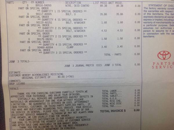

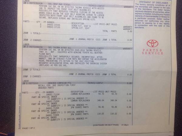

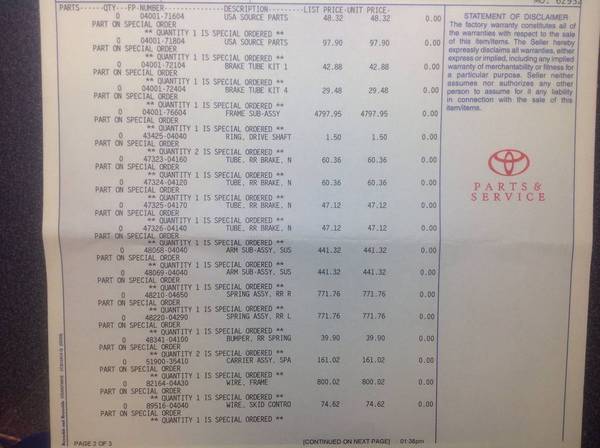

    What I got from the dealer:
    I've googled a few of the part numbers but not many pictures pop up.
