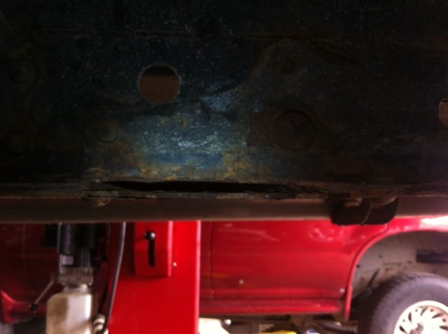

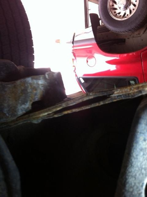

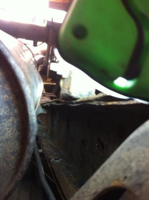

    3,115
    Do you think these pictures of my frame, with ballooning on the lower outside rails, with the worst being next to the muffler, should be enough to fail the LSC inspection, even with no hole in the frame?

    2018 Tacoma DBL cab 4x4 TRD Sport, Premium and Tech Pkgs
    Toyota says you have to have a 10mm hole. Your dealer may be able to find/produce one with aggressive inspection. I haven' heard of anyone being approved for "ballooning" alone. Although my frame had ballooning and a gaping hole.
    Check near the catalytic converter and behind the front wheels.

    3,115
    That is what I thought till I read this posting on a different thread, this looks just like mine and doesn't have the 10 mill hole either and his failed:
    ok i figured out how to post pics so here are a few. keep in mind i didnt have the same problem as most people. i dont have any holes going through my frame what I have is the 2 piece C channel frame bending from rust in-between the 2 layers of metal and this failed it
    Interesting. My letter said there had to be a perforation. Must be some dealer discretion allowed on what can be turned in to Toyota?

    05 Speedway Blurple V6
    I found the hole they were talking about on mine. This would be right under the passenger seat.

    '83 CJ7 '19 MT 07
    Is that right by the cat on the pass side?
