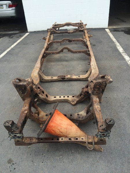

    FUCK YA YOTA! You stand by your truck and I forsure thought id pass this frame inspection but waited to the very last minute...SHE FAILED, unbelievable, im getting a brand new frame! Any ideas of additional costs you guys have had to pay? The dealership said there might be some added parts not covered but hell I dont mind at all.
    PS i just had surface rust, no major penetration that i could find.

    Interesting, i just got the news today im geting a new frame. You think I can source my own parts such as aftermarket upper control arms and they will install while its being ripped and replaced? Trying to get the most out of this stealership win while i can. Im guessing some of my parts will be siezed/rusted up but hard to tell what those could be. If anyone here has insight from there frame replacement that would be great. Probably best for me to just read through this 113 page thread to start.

    I don't see them giving you any issue with providing your own parts. Generally, whatever they need to remove/replace during the swap anyway, they won't charge for. If it's going to be extra labor, such as assembling struts/coils, they will charge you.
    I would guess that they wouldn't charge any extra to install UCA's, since they would have to swap over the old ones anyway. Obviously ask them to be sure.
    Also a good time to replace the remaining suspension parts as well.
    They should also do a preliminary inspection/walk through with you, when you drop it off, and give you a heads up on anything that may need replacing.

    Honestly I thought the dealer saw it as a win for them aswell. Either the guys in gray work gear where drooling over my truck or they saw it as more work for them as this is a weeks worth of work for 2 guys. Which i noticed on my reciept today is 125$ an hour paid for by the manufacturer i believe or im guessing these recall claims aren't paid for by the dealer. You definetly should file a complaint as this was a surprise for me they said it failed when all it has is surface rust. Its a colorado/wyoming truck so no east coast salt and not a spec on the body.

    If you check the inside vertical section by the cats, I'll bet you find something there. That's the trouble spot. They need to find a 10mm or larger perforation to fail the frame.
  11. Mar 29, 2016 at 6:15 PM

    Mine, when you factor in cost of 3 months of car rental, was ~$14,000

    Interesting ya ill check that area out tomorrow, what the guy told me was they take a ball peen hammer and smack it around the frame. If they put a hole in it, it fails. I laughed at the guy and said wait your telling me a guys going to swing a hammer around my truck and if it creates a hole you get a new frame. I almost right then and there was like ill pass cause i dont trust someone hammering around it but then thought what if...sure enough they made a hole i guess? This whole process boggled my mind a bit as i was just being told im getting a ~12k dollar frame, still cant believe it.
