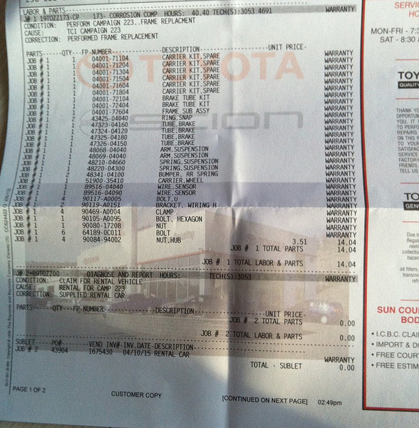

    Finally got the call to have my frame replaced... I'm wondering if any of you have the parts list from Toyota that states all the parts they are going to replace with the frame recall?? I saw it somewhere on here, thought I saved it on my computer... but can't seem to find it anywhere. :(
  20. Apr 9, 2016 at 10:14 AM
    #2340
    Markcal
    Markcal Well-Known Member
    Aug 14, 2014
    #136147
    3,115
    I copied this from a Google search of "parts list from Toyota tacoma frame recall", I hope it is what you were looking for.
