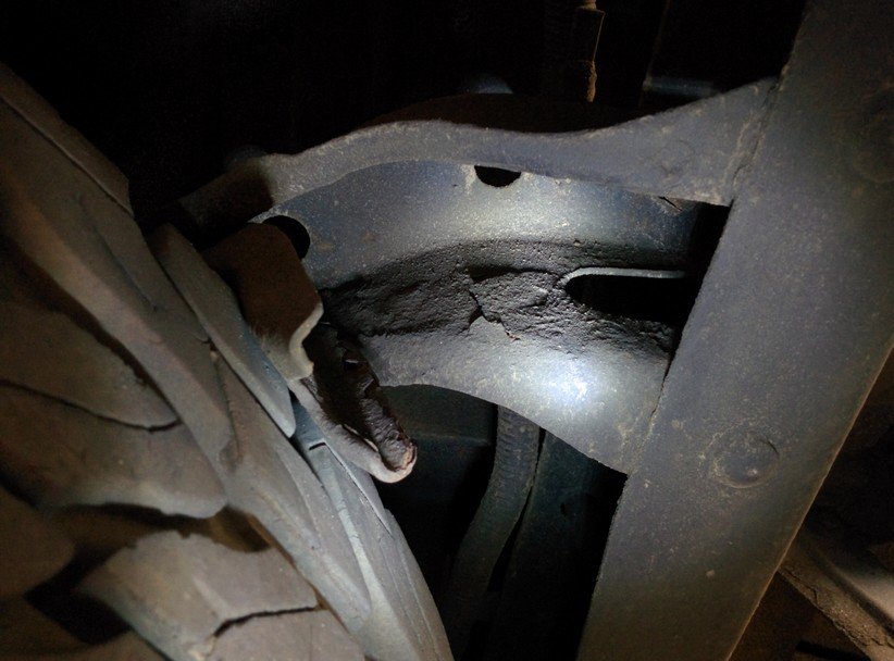

    Got my inspection scheduled in about a week. 'Unfortunately' did undercoat my truck with Rust Bullet just months prior to the service campaign going public back in fall 2013. Most of the frame, main rails for instance look brand new as they were easy to get to and prep well, but under the engine and around the open c channel by the fuel tank and rear wheels was a different story and much more difficult to do a proper prep and paint job and it shows now. Those sections paint is peeling off and rust shows underneath. What I also don't like which is hard to see is there are spots where the bottom lip of the c frame around the rear wheels seems to be splitting. Is that cause for concern as I would think water trapped in there will only accelerate the process. Especially the back area, I can start peeling off chunk of paint and uncover rust. Did not take a spare off yet to take a look at the cross members, but found a chunk fallen off on top of the spare so most likely won't be great. While most of the frame looks great after my rust paint job, some sections not so much?? Lot of areas around the back of the frame I could uncover rust under chipping paint...

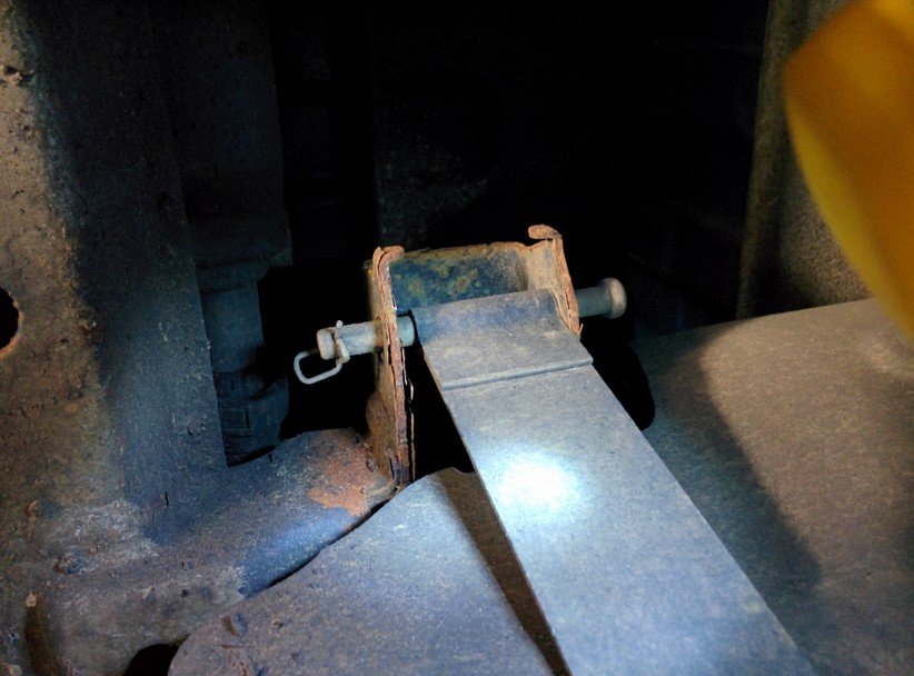

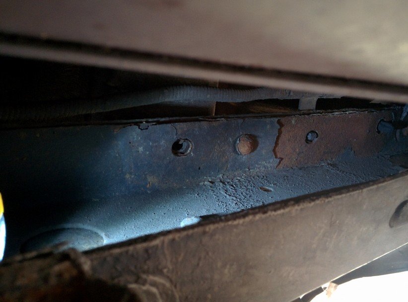

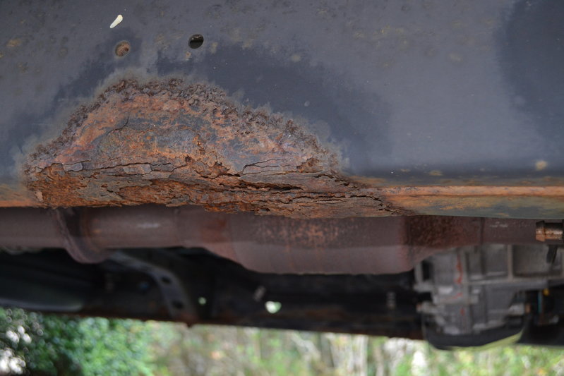

    Dropped the truck at the dealership today to get my frame replaced.
    here is the worst spot on the frame

    Did you have a perforation on your frame or was it just surface rust?
