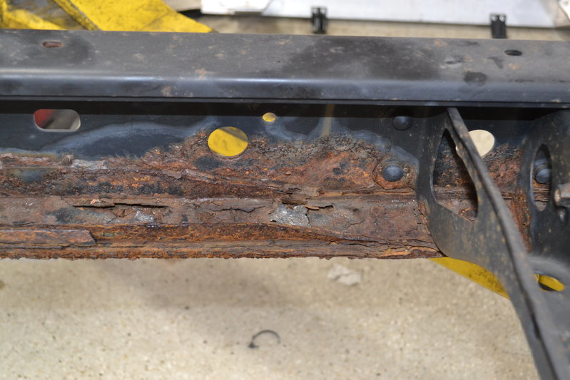

    Dropped the truck at the dealership today to get my frame replaced.
    here is the worst spot on the frame

    it was really the only terrible spot and it certainly wasn't surface rust. I probed with the round end of a ballpeen hammer and there were some soft spots but no perforations visible. I didn't want to dig till I had my truck on a new frame... they had already approved the frame swap, I didn't want to make it worse before it was repaired. I'll visit the dealership for progress checks and probe in the rust then.

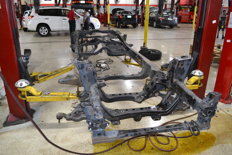

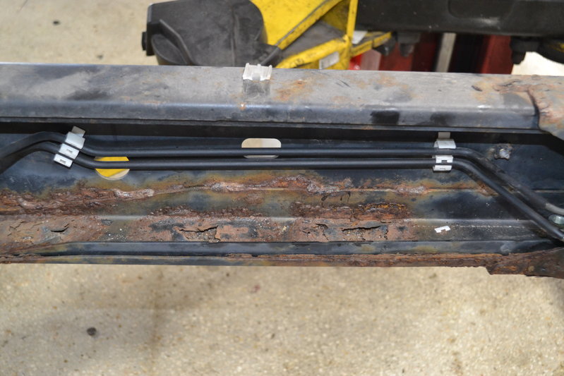

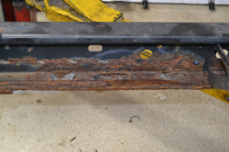

    visited my truck frame today, good progress and the mechanic said he will be done on Friday.
    Old Frame
    Passenger side, just behind the engine
    Passenger side, a little farther aft
    Passenger side, further aft again, at the lower left is the front leaf spring mount
    Drivers side, just behind the engine

    there were no perforations visible.
    In a few places, it was soft when pressed with moderate pressure. That was in the areas where there was a lot of flaking on the passenger side rail.

    I spoke with the Service Manager this morning and he said the 10mm perforation requirement was lifted late last year and they identified several areas as "excessive rust". I had rust in a few of those areas and that met the LSC requirement.
    he pointed to the area on the vertical inside the rail, above the welds.
