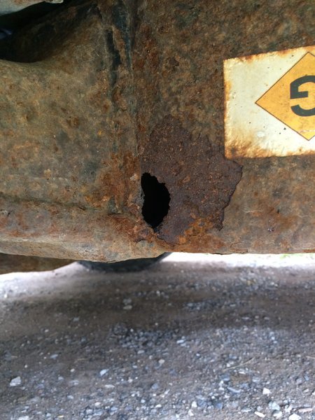

  6. Dec 22, 2016 at 9:04 PM
    #2626
    Hillbilly Willy
    Hillbilly Willy Well-Known Member
    Dec 18, 2015
    #172574
    53
    Central PA
    2005 blue Tacoma DCSB TRD Sport
    Yours looks pretty decent. This is the hole that failed mine and resulted in new frame.
