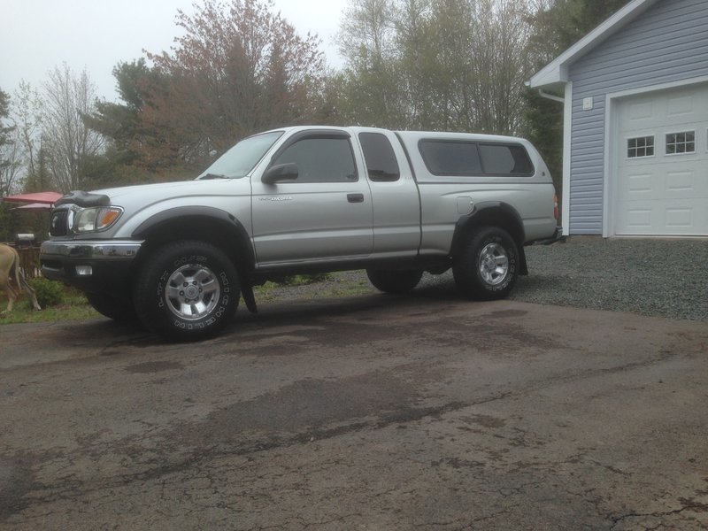

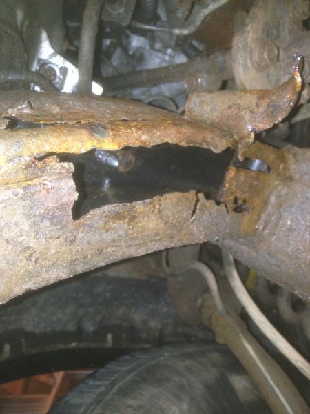

    We have 100's of trucks at my work. I can show you pictures from a 2003 gmc, that never saw any rust proofing, and lived in the woods it's whole life. The frame is a light rust colour here and there, but no bad flaking to the degree of my last 2 tacomas
    While I agree that rust proofing is beneficial, and I do all my personal vehicles annually, the Tacoma indeed has an inferior frame. My frame was like Swiss cheese and the sheet metal looks like new. Now a frame is a lot thicker than sheet metal, and nothing was rust proofed so all metals were exposed to the same elements.
    The body on my 2004 was mint! And well you can see the frame!
