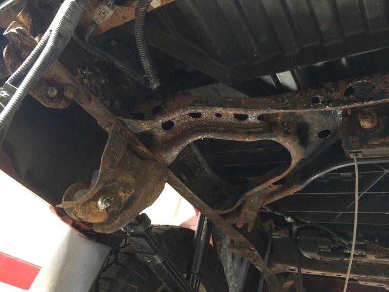

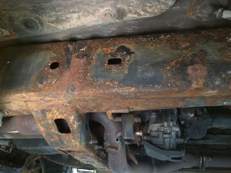

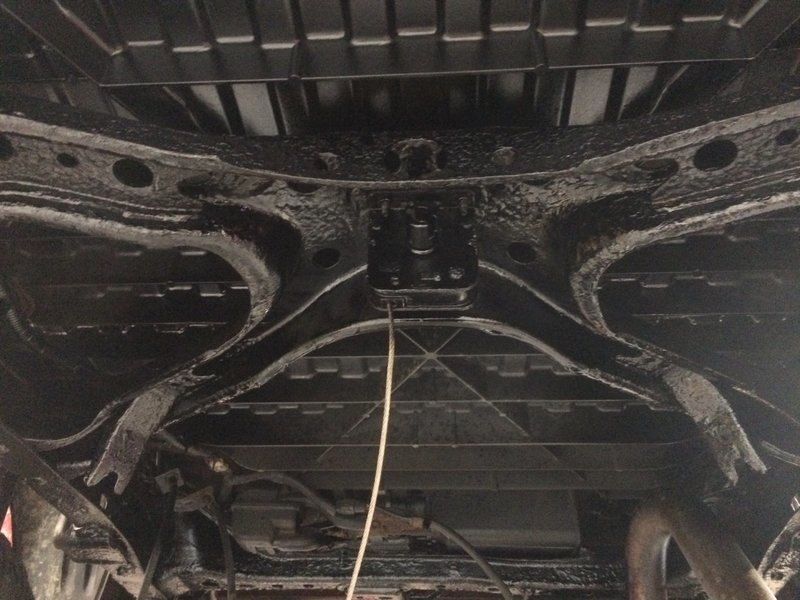

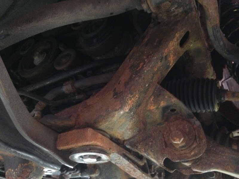

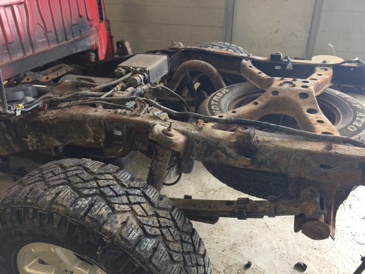

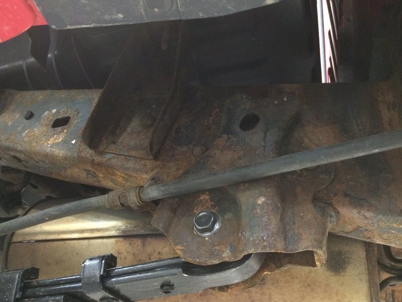

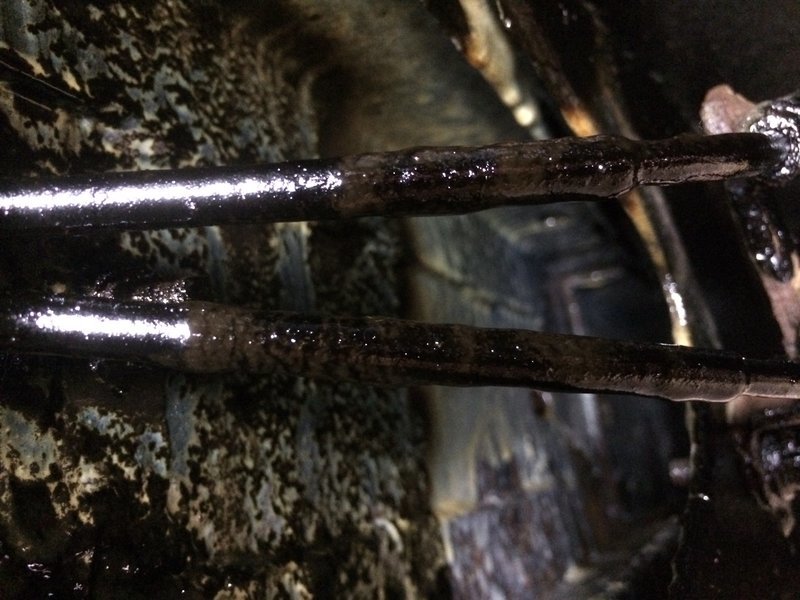

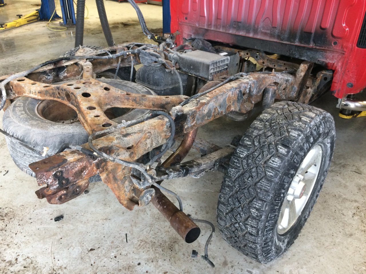

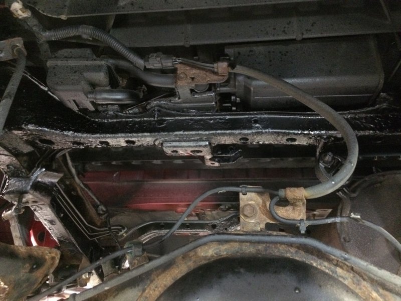

    Here is my experience with the 2nd gen frame recall. Here are some pics of my TRD Tacoma during the process. Keep in mind this is the 2nd time this process has been done to my truck. 1st time in Toyota did not preform the process properly...so they say. All the undercoat had washed away in a year exposing the rust again. I really don't think the undercoat they put is really going to help anything. But I guess it's better than nothing a second time around. This time I told the dealership it would be done in my terms and I would document the process with pictures.
    After scraping and sanding

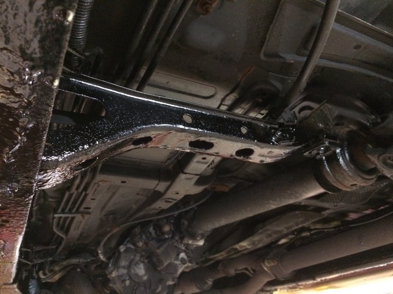

    Parrfin wax

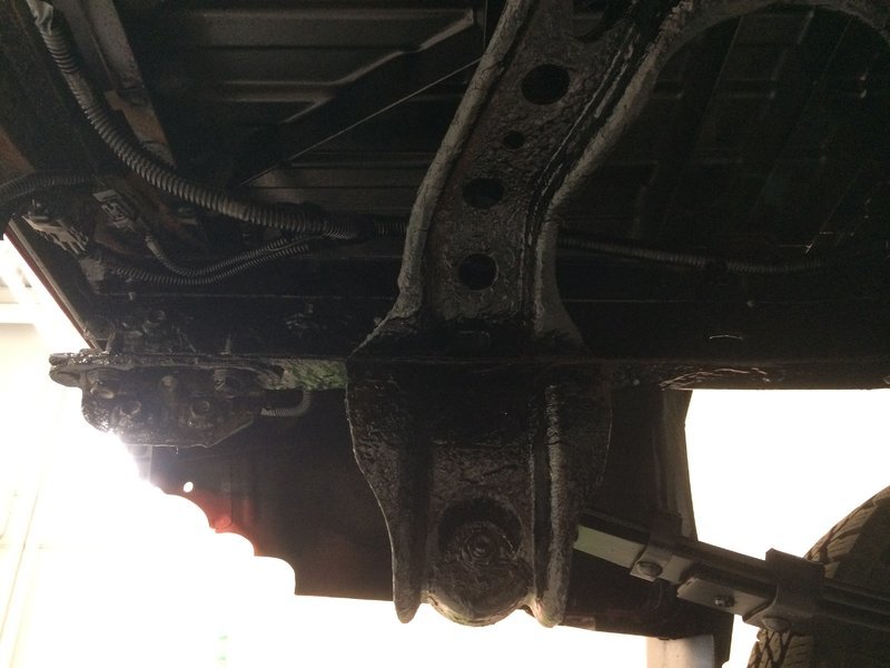

    Final coat - I made toyota remove my gas tank and hitch and got them to also treat all my cross members.

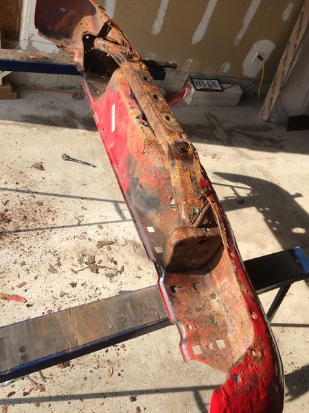

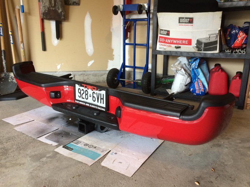

    When they drop my hitch, they also removed my bumper with it. Had to throw old bumper and bumper support in garbage

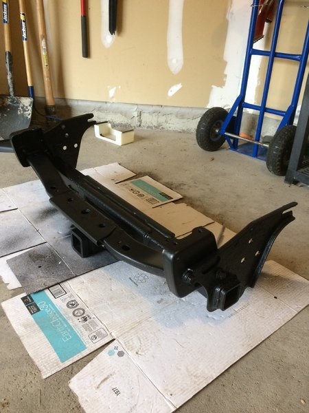

    Sandblasted and painted old tow hitch and bumper support from used bumper assembly that I purchased from scrap yard for $400
    Bumper painted and reassembled
    Will see how long this lasts. I guess I am happy because there is no holes in my frame. But I really doesn't look pretty underneath the mask they put on.

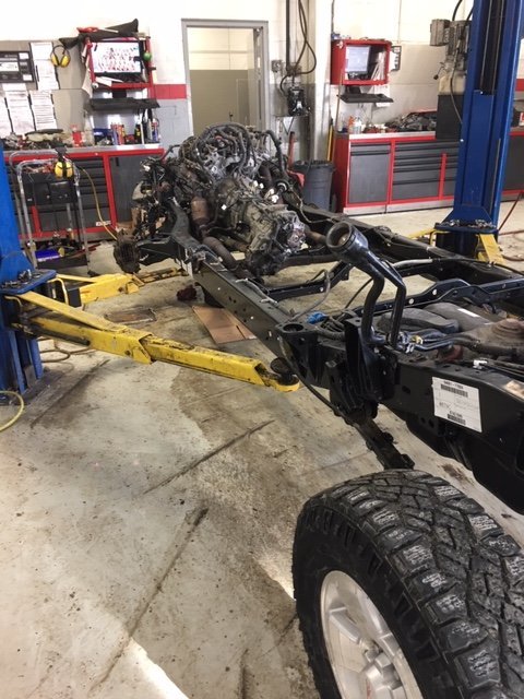

    January 29, 2019 Finally

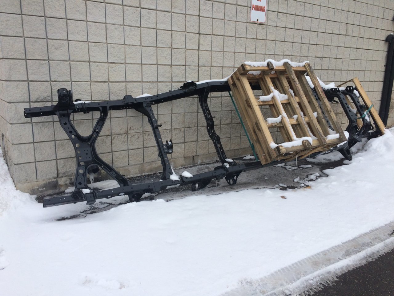

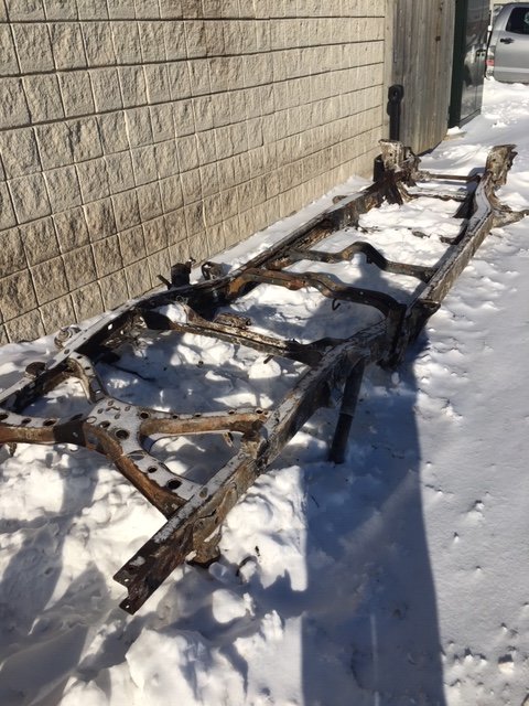

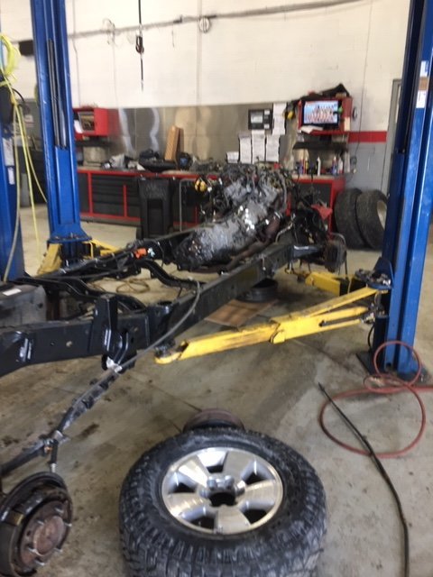

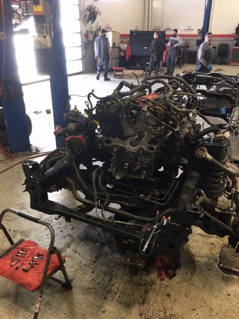

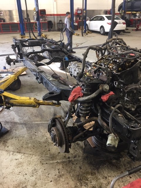

    Create a Toyota owners account with your VIN. It will show any outstanding recalls. Mine had frame replacement which included basically an entirely brand new suspension and the spare tire holder plate.

    My understanding is that if they don't find any perforations in your frame they coat it. 1 perforation and your frame and basically about everything attached to it gets replaced. I would call customer service. Also create a Toyota owners account. If you have an outstanding recall it explains it in detail
