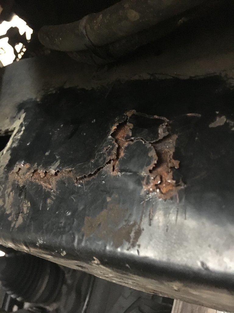

    Doesn't seem to go through...... had the truck checked out last year and a ok. I do have sliders on, so not sure if toyota would ever do anything....IMG_2392.jpgIMG_2393.jpg

    What year is it?

    2006

    Hopefully it will fail the hammer test

    I used a screwdriver pretty good and it seems the under layer is pretty good.....
    So let's hope it fails the second time. I bet they do give me shit about my weld on sliders, but they are welder on over a foot away from this spot

    Are the frame rails separating?
  9. Sep 26, 2017 at 6:29 PM

    So the picture I posted seems like they are.
    The frame does have some degradation by the leaf springs where the frame comes together in multiple parts

    If there is a 10mm gap between the layers it might fail.

    So if the flaky layer is 10mm away from the inner layer it could fail

    I have been told that. It is a safety structural issue.Some have been passed while others failed.

    Have an appointment for October 10, now to decide to paint it temporarily to stop any more rust

    I would want it to rust out now. Don't hide it

    That's a 15 year old frame. Looks great man.

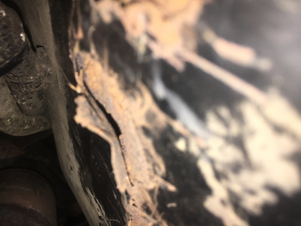

    So on closer inspection the rusted part does go through to the inside of the frame.IMG_2407.jpg

    DON'T PAINT IT! At this point, encourage the rust to make sure it fails. Get a new frame and A arms and associated parts and enjoy life.
