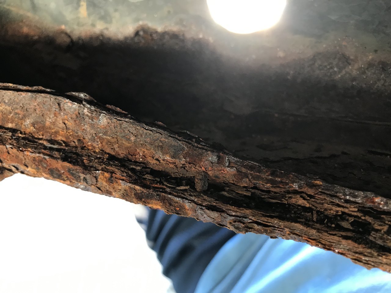

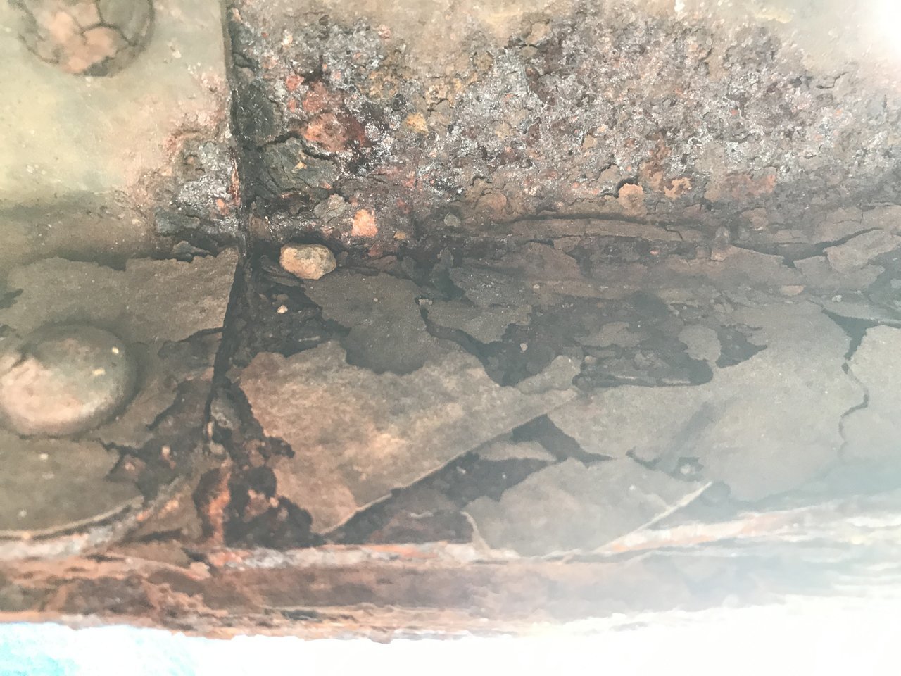

  7. Nov 2, 2017 at 10:33 AM
    #2867
    A1ostkause
    A1ostkause Member
    Oct 25, 2017
    #234067
    11
    Steve
    Virginia beach, VA
    07’ Tacoma RC 4x4 2.7 5spd
    Gen 3 OEM Rims
    These are the worst areas i could find on my 07’, scheduled for inspection in a few weeks. Think i can get a new frame?
    7825E817-4F1A-455A-9371-4EA9F9E5B38A.jpg 2303C63E-B474-4923-93FC-86B853436447.jpg 5A9AAD43-0FEA-4788-9C6A-9CD28C0C5E0D.jpg
  8. Nov 2, 2017 at 10:38 AM
    #2868
    hockey12
    hockey12 Member
    Sep 26, 2017
    #231187
    9
    Rob
    2006 Tacoma
    Very similar to my 06 and I was approved for a new one back in September. Still waiting for all of the parts to come in.
