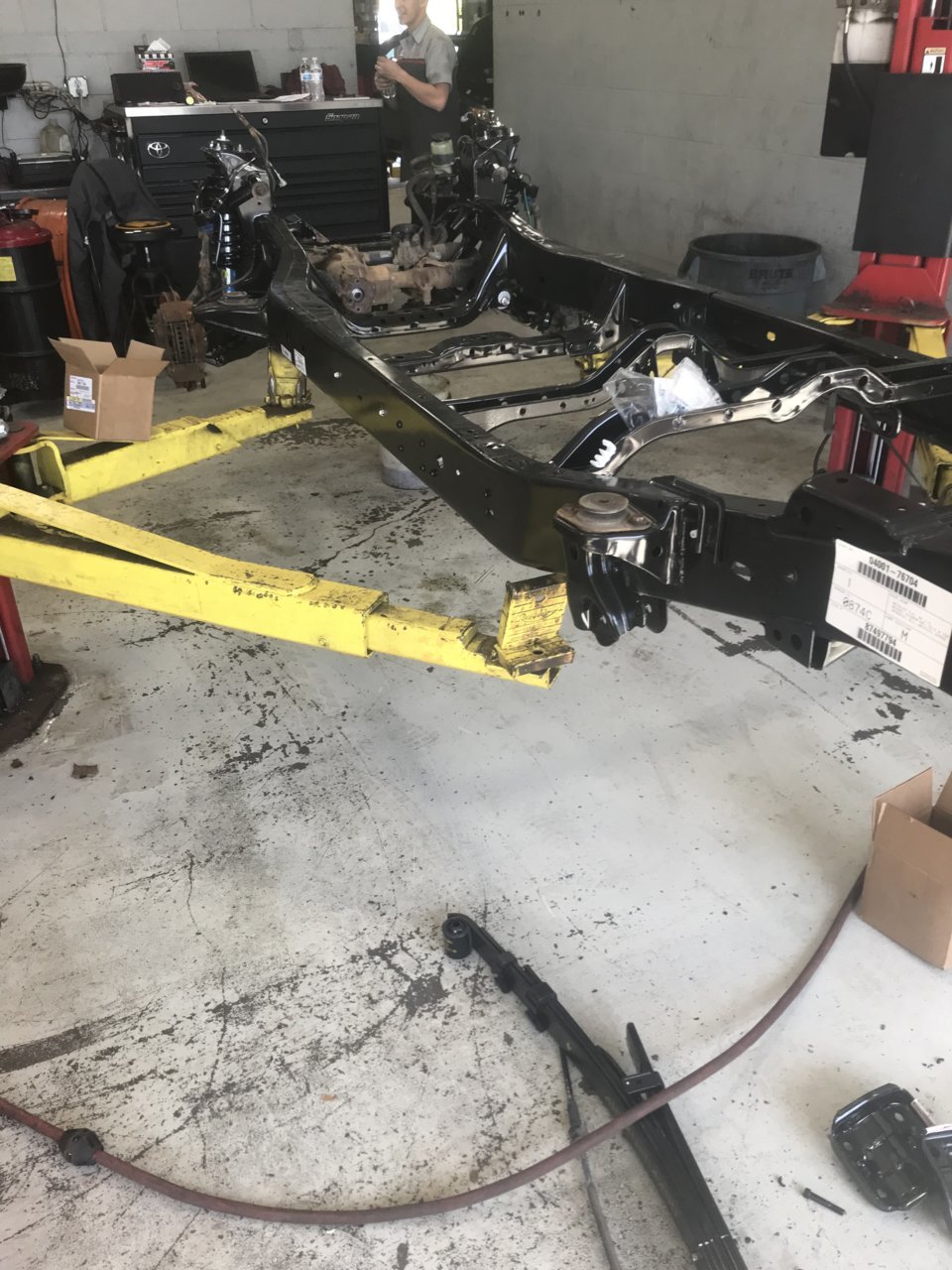

    Posted this in other thread but no response ...
    So my truck is actually apart at this point and they ran into an unusual issue. The tech was starting the reassembly process and found that there was an issue with frame. Gas tank would not line up/ bolt up. I have a friend at the dealer who gave me a call. He said this tech is one of two who do all of the frames and tech has done so many so he knew something was up. They have a Toyota corporate tech/engineer coming down now to see what is going on. Has anyone ever heard of this? Part numbers were crossed check to confirm. Just a major fitment issue.

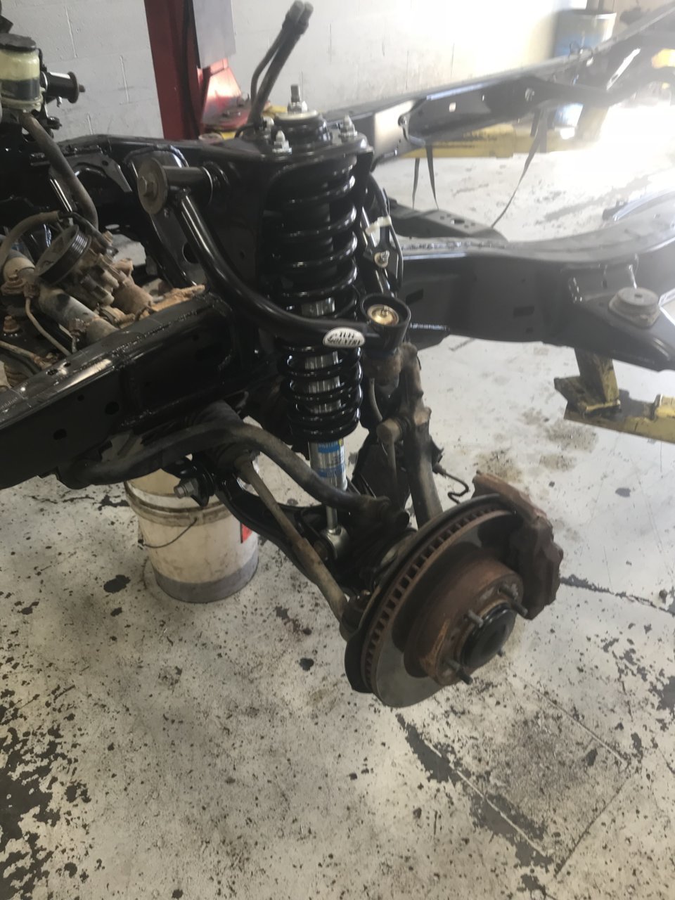

    So I guess they’ve started on my truck finally. Got a call today from them stating that installing OME 887 and billi 5100’s that are already compressed along with an add a leaf and upper control arms was 9 hours worth of labor. . Tech told me he had take apart the struts and put the 5100’s on the highest setting. I explained that they needed to be on the lowest setting with the OME coils. Then got told it wasn’t going to lift the front if they weren’t set higher. Told them I’d pay for the leaf kit install but that the front struts and coils are fine as they are. 30 minutes of labor to do the add leaf. God help me. Lol

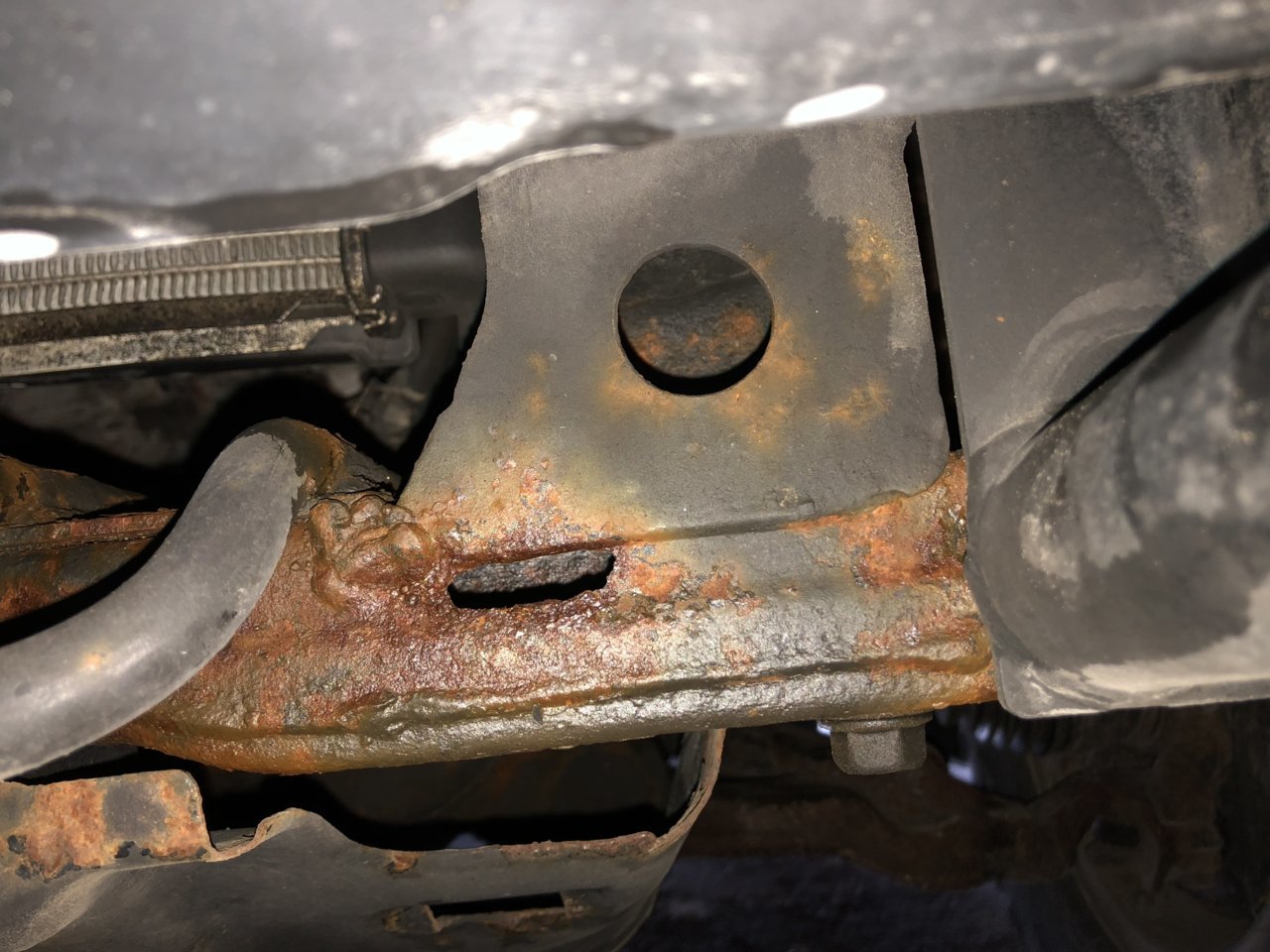

    Unsure if this qualifies mine or not. First hand wash after winter so I hosed the underside trying to blast off any thing willing to come off. I am getting ready to clean scrape off the crc they had put on and the lps3 I’ve been using. The usual spots look pretty good. Found this on the front cross member driver side. That’s the tie down on the left A654C8E5-418B-46AC-BA18-163BCEAC6ACB.jpg
    Don’t think I gotta spend much more time on the floor cleaning my frame now?

    1005772B-F009-4280-ACED-4D0E216FFBCE.jpg CE361E08-5CD8-4742-B7B5-3F67DF5E557D.jpg 1005772B-F009-4280-ACED-4D0E216FFBCE.jpg CE361E08-5CD8-4742-B7B5-3F67DF5E557D.jpg Dropped in on the dealership today. Feel a lot better after talking with the tech. Stated the only labor would be for the add a leaf. Said he didn’t realize the coils were OME which I can see since the box wasn’t with them. Other than that everything looks pretty good. Should have it back tomorrow.
