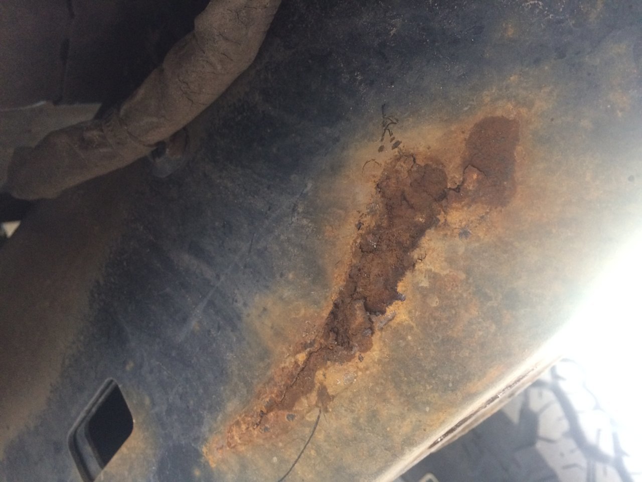

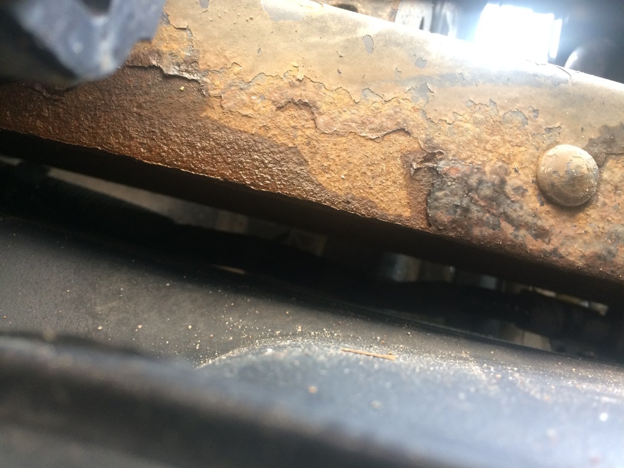

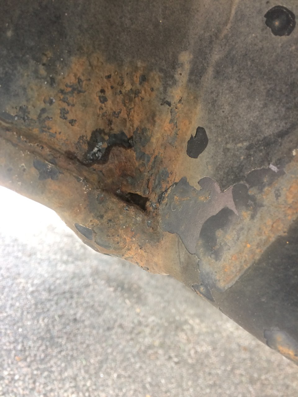

    Have an 06 I am the second owner inspection on Monday so I cleaned off the bottom of the truck and found the following. Any thoughts? Im concerned about the first picture because its almost the same on the opposite side of the truck. I almost didn't see this. Are there any other spots not so obvious that I should try and document before the inspection?

    Get a screwdriver and push on those spots (hard). Your frame looks like it's on its way out. You have 12 years from in service date. Good Luck:fingerscrossed:

    Tried pushing nothing went and looks like the the frame passed...

    If you have a 2006 you may be out of time. What is the in service date of your truck? if you have time take a hammer to the worst spot and try to break through. Some dealers put more effort into getting a frame to fail than others maybe try another dealership that does a lot of frame replacements. Do you live in a cold weather state? You might be able to get it crc'd. My dealer told me he managed to poke hole in my frame but its not big enough yet but I have a 2009 so I have plenty of time for that hole to become big enough.

    You have 12 years from date of first use or one year from date of settlement. Settlement was 5/21/2017 so in one week you will be out of the warranty enhancement program. Did you recently have it inspected and it passed? If so you are probably out of luck. If you did not have it recently inspected try getting it in before next week. Try to pound a hole through with a hammer before you go in.
