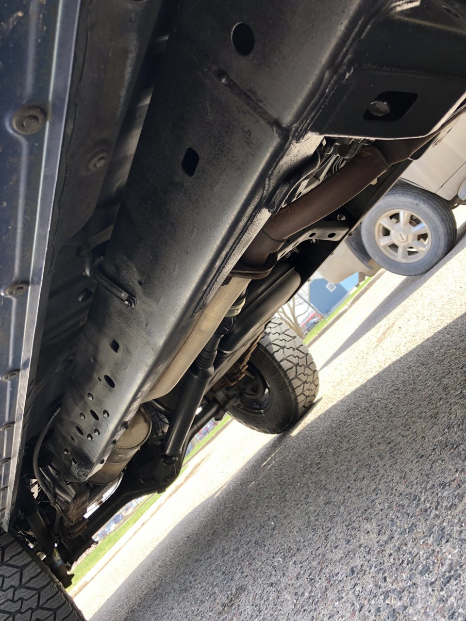

    4F9B943A-E962-4560-90F8-2432F393D95E.jpg My underbody.... literally just surface rust on the leaf packs. Its a 07 and went through one Michigan winter. The leafs are really bothering me. I do have a small spot starting next to the cat and i wire wheeled it like crazy and por 15ed it like crazy but it is still getting some rust “stain” running down the frame. Idk how to get it to stop. Might need to get the sand blaster on it then re apply por 15

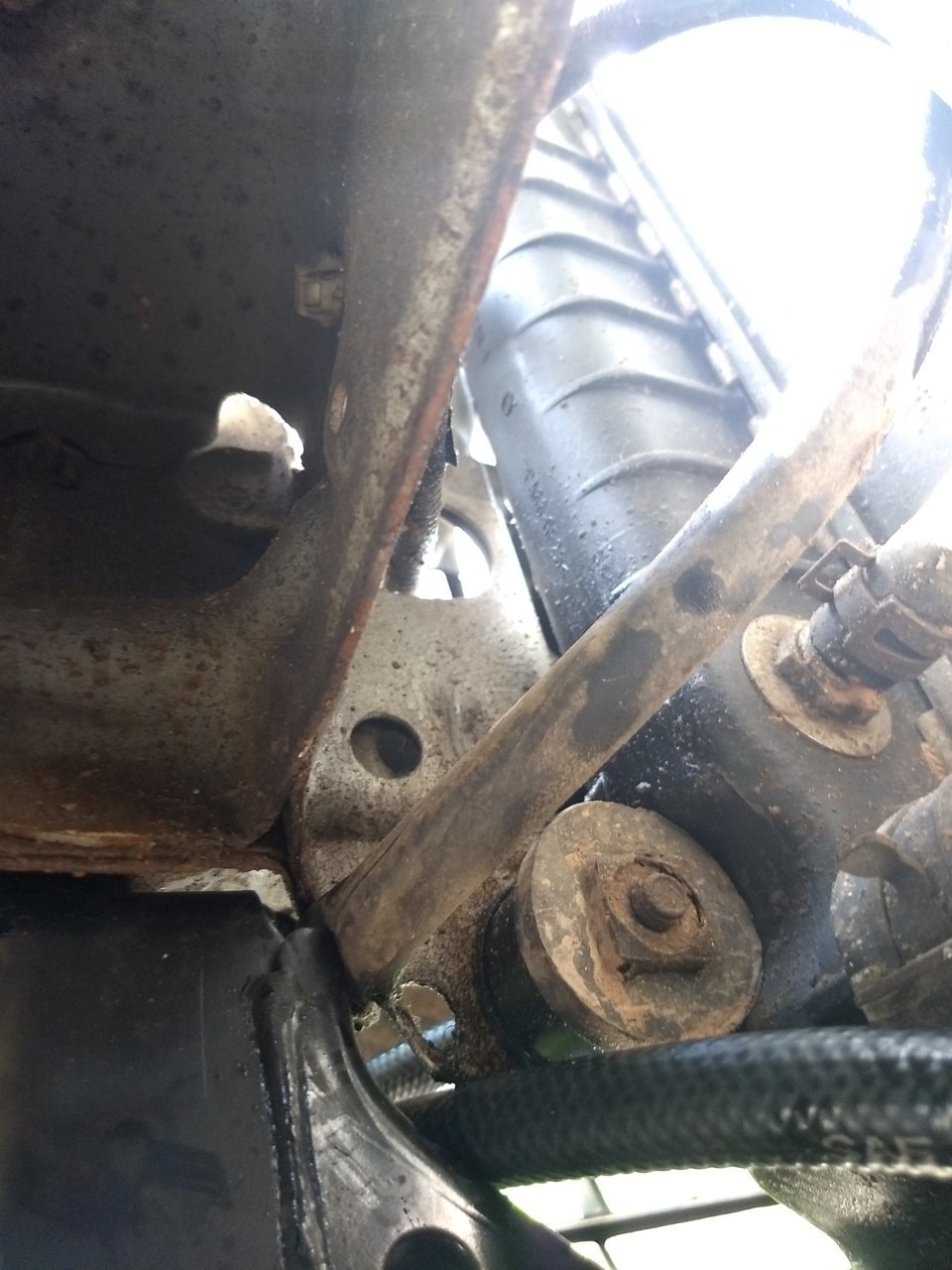

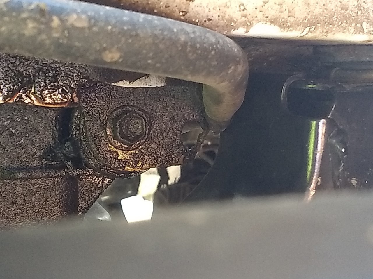

    1500 miles later noticed some significant fluid under the front of my truck. Looked through the grille and saw this.
    They pinched my trans line between the frame when reassembling, causing flow to stop and over pressure my trans cooler causing it to start weeping. Was no where near a dealership or mechanic but managed to cobble together some fuel line to replace the line with and had a half quart of trans fluid with me and was able to get home.
    If the techs had literally just looked through the grille or 6" from the leak, they would have seen that they pinched the line but apparently they are too incompetent to even do that.
    Trying to figure out how to proceed without just calling the dealership and screaming at them. They owe me a new transmission cooler and if I have any issues in the near future they better be covering my transmission rebuild but I will not ever be taking it back to their shop for anything.
