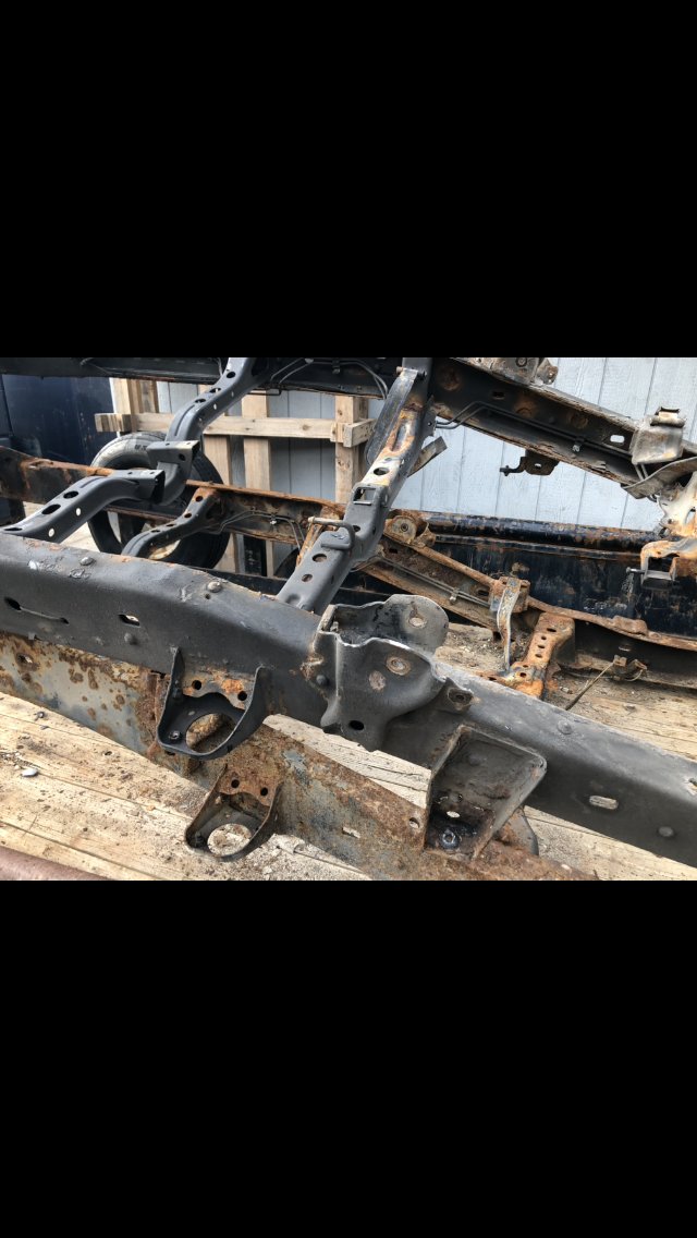

    Not sure what or how but mine looked like a missing weld?
    The rest of my frame looked pretty good, I thought I’d done good and lucked out on my spot.
    I visited a few times while the swap was being done and took some pics.
    A few of the old frame to see where I was lacking on protection.
    Seems the gas tank location was lacking and hard to get at or see.
    I encourage everyone to try and good a good look at this area.
    This pic of my frame ontop of someone else’s.
    Pretty sure it may be an area to look at seeing how I’ve worked hard on mine for the last 6yrs.
    Hoping this helps another taco carry on!

    Thanks for the post Jeffch. Where was this spot on your fram. It is a spot I may not have checked yet if it is hard to get too. I am really hoping that I can find something before my 07 is out of warranty. I dont mind taking a few days and working on my frame but I would love a new one if possible.

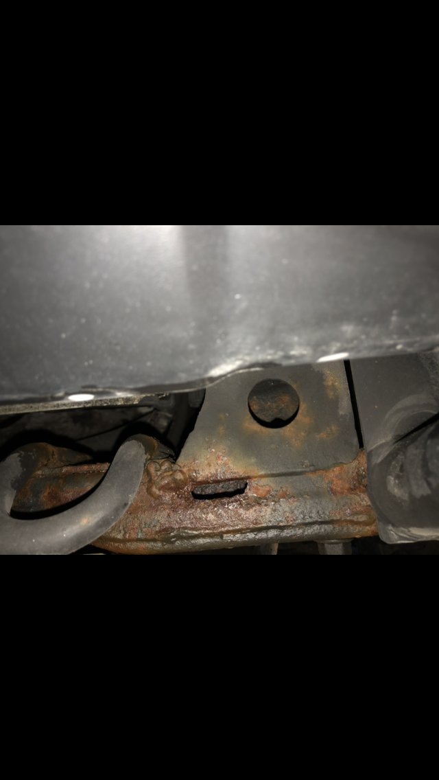

    I've noticed some flaking around the spare tire area and the frame overall appears to have superficial surface rust. I definitely don't have any noticeable defects around the cat converter area, and short of attempting to pound a hole in the frame myself, don't see anything serious.
    I'd consider getting another inspection, probably at a different dealer and if I've interpreted it correctly, I'm allowed to have it reinspected annually with in a certain time limit, for signs of symptoms that would qualify the frame to be replaced. Just worried about the welded sliders. :notsure:

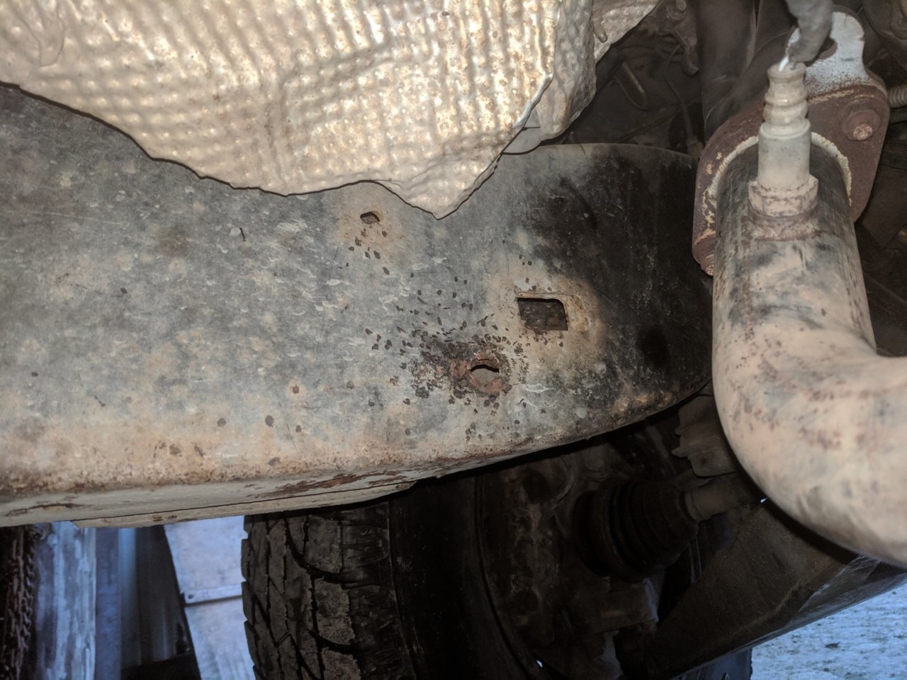

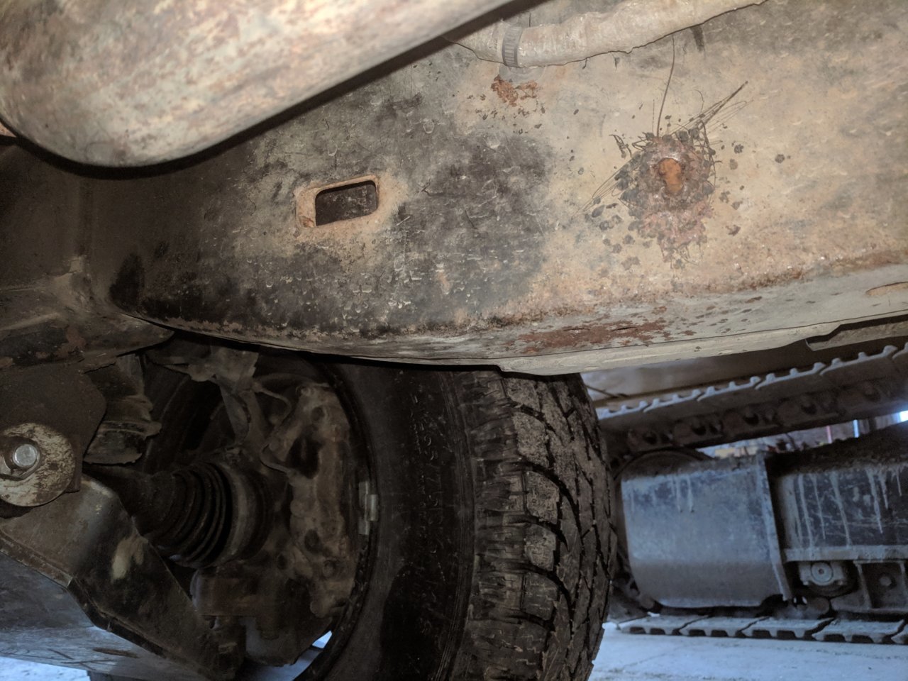

    1st pic is front cross member the round piece showing is the tie down front drivers side.
    2nd pic frames are upside down but frame above the tank is delaminated.
    I don’t think it would had been noticed left to Toyota.
    I also had some areas above spare tire I’d been watching for some time.
    I don’t carry my spare there so it’s easier to get at.
    I kinda threw in the towel on maintaining the frame when the class action suit was won so my frame hadn’t had much done to it by me since then.

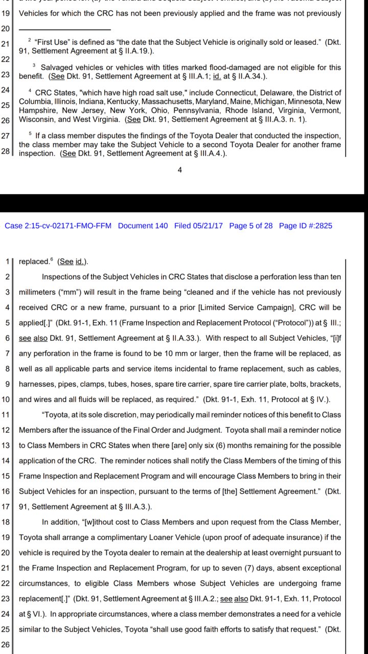

    Well I guess I just need to call and see what they say regarding my truck being eligible with the time frame.

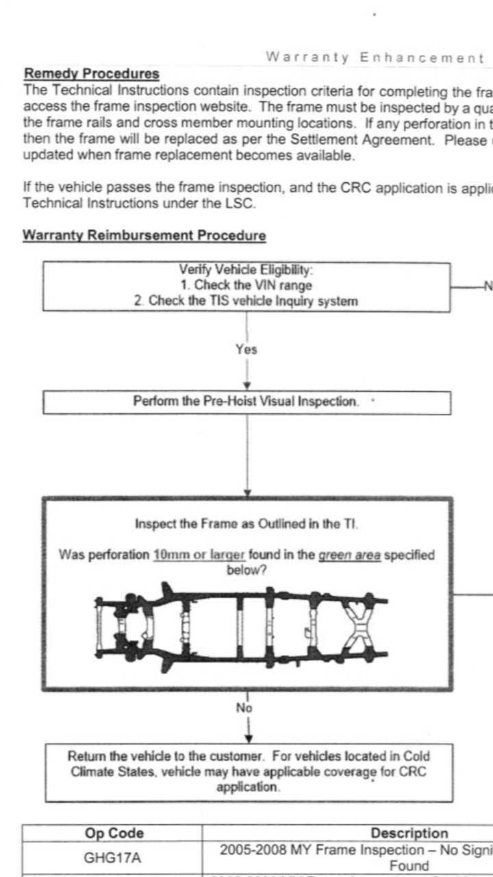

    Also, I noticed on Toyotas internal zh6 wep bulletin, they only inspect certain areas of the frame for failure.
    The way it's worded in the courts final approval states: pg 5 line 6; "With respect to all Subject Vehicles, “if
    any perforation in the frame is found to be 10 mm or larger, then the frame will be replaced, ". So it's not necessarily the areas oulined in the bulletin, but rather the whole frame including cross members that may contain ANY perforation to be eligible?
    The copy I found of the bulletin detailing areas to test is in b&w, so the black areas of the should be green.
    Pg 4 line 23 of the final approval states "
    Salvaged vehicles or vehicles with titles marked flood-damaged are not eligible for this
    benefit. (See Dkt. 91, Settlement Agreement at § III.A.1; id. at § II.A.34" which I'm not worried about since my title is clean.

    Bingo. Driver and passenger side where the rear cats sit. Frame inspection scheduled for next Saturday.
