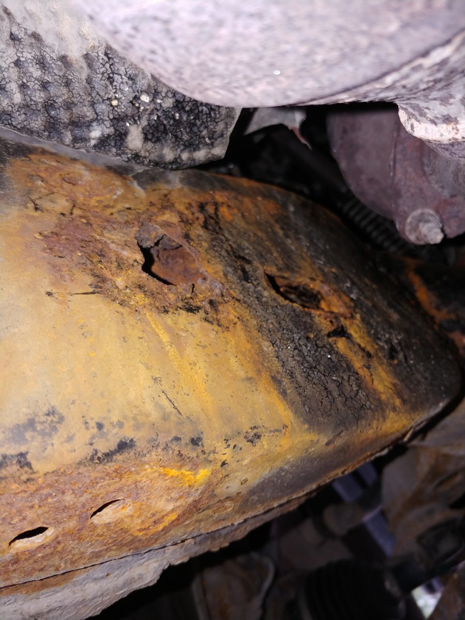

    Hey guys, I'm a first time Tacoma owner, purchased on Dec 30th 2018. My truck is from the base of the NC mountains, Marion, which do get salted pretty heavily. One owner prior to me. 2007 DCLB 70k miles. I took my truck in for inspection last week and they said it passed. I'm not convinced they put it on a lift. This looks it meets the 10mm perforation requirement to me..... I'd love to know your thoughts as I'm going to take it back to the dealership and make sure they see these places. 1st pic is the frame above the forward mount of leaf spring on passenger side. Second is more towards the cab on passenger side. They told me there was only surface rust.......

    Go to a different dealer now!

    This is scary! Regardless of it not being a hole, it's clearly falling apart.
    Get underneath and look near the cats in the front. It may be soft which is a guaranteed fail.
    Mine looked like this

    Frame delamination caused my truck to fail.Go to a different dealer.

    @OutriderDan
    Seriously go to a different dealer as soon as you can!
    I wouldn’t use the first dealer they were gonna stick you with a bad frame!
    Don’t make an appt tell them this just passed somewhere else show them the pics.
    Time is running out do you know the in service date?
    I’d be ready to leave it also.

    Great! I'm already slated to get new leaf springs with them next week some time. I'll make sure they check this thing out again and even try to point this stuff out to them if they'll let me go back with them. There's no point in leaf springs now if the frame is falling apart where they mount to it. I'm in Gastonia NC which doesn't get a ton of salt, so these guys likely haven't seen a lot of this issue...... or so I'm going to assume. :)

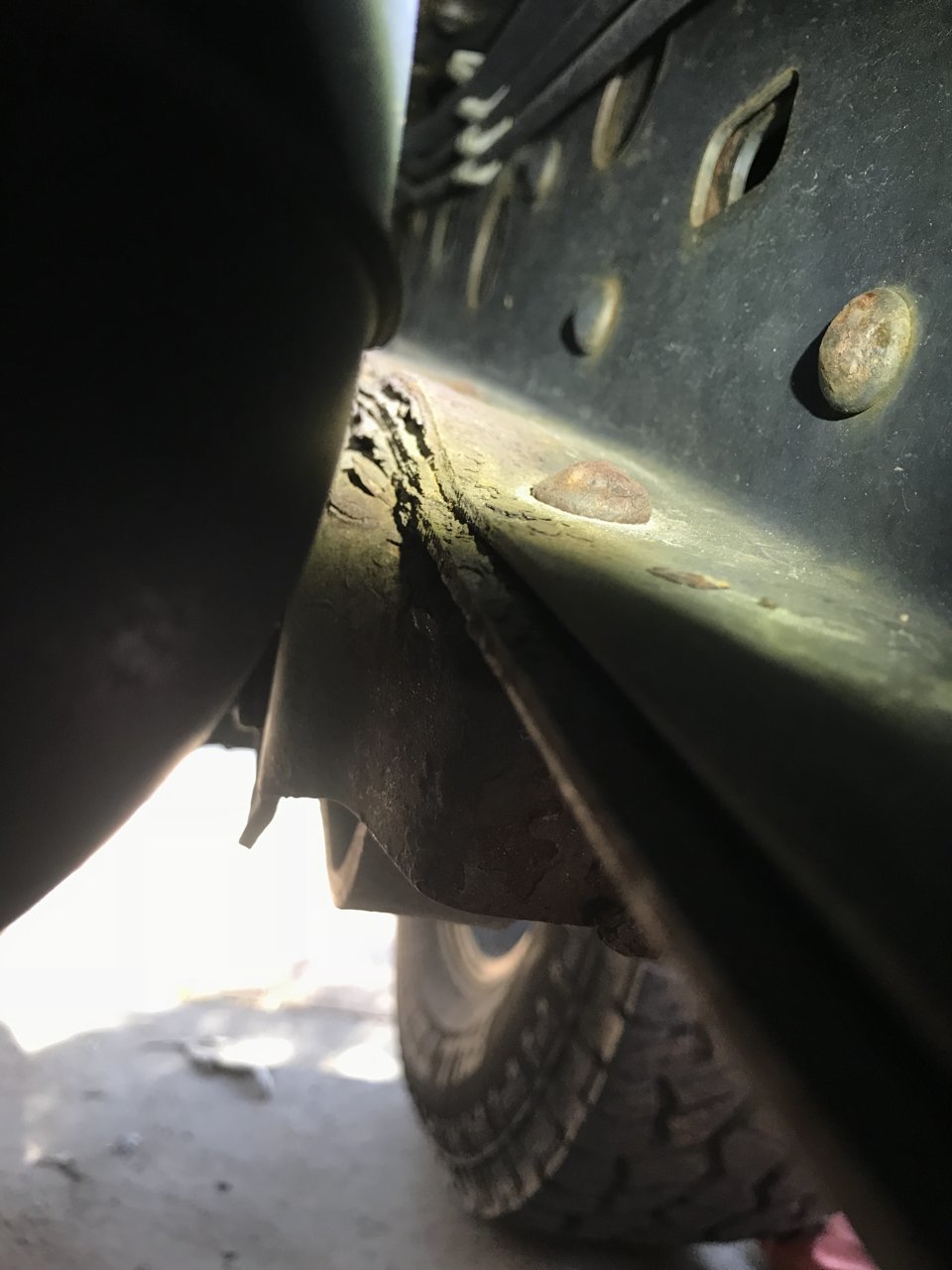

    Just for fun, here's a pic of the frame on drivers side, forward mount for leaf springs. Not nearly as bad, but the same delamination is going on.9031D628-9918-4431-8910-EC11FA9DB24E.jpg

    Update: I got to the dealership this morning at 7:35. They put it on a lift for me and I pointed out the bad places. The techs seem to be hung up on the word "perforation". They also just happened to the lift supporting my frame directly under the true perforation, so that was not visible. They are submitting the claim to Toyota "so it will not be the dealerships decision" as to fail the frame or not. After eaves dropping and seeing the techs navigate the Toyota frame recall information, I don't believe they actually inspected my frame last week. They had to have an experienced guy come and show them how to navigate the frame checklist.
    With all that said, they supposedly submitted the claim to Toyota with pictures (hopefully ones I emailed them) and I should hear back in 3-4 days............. I'm doubtful that they are on my team, but I'll kee y'all posted.
