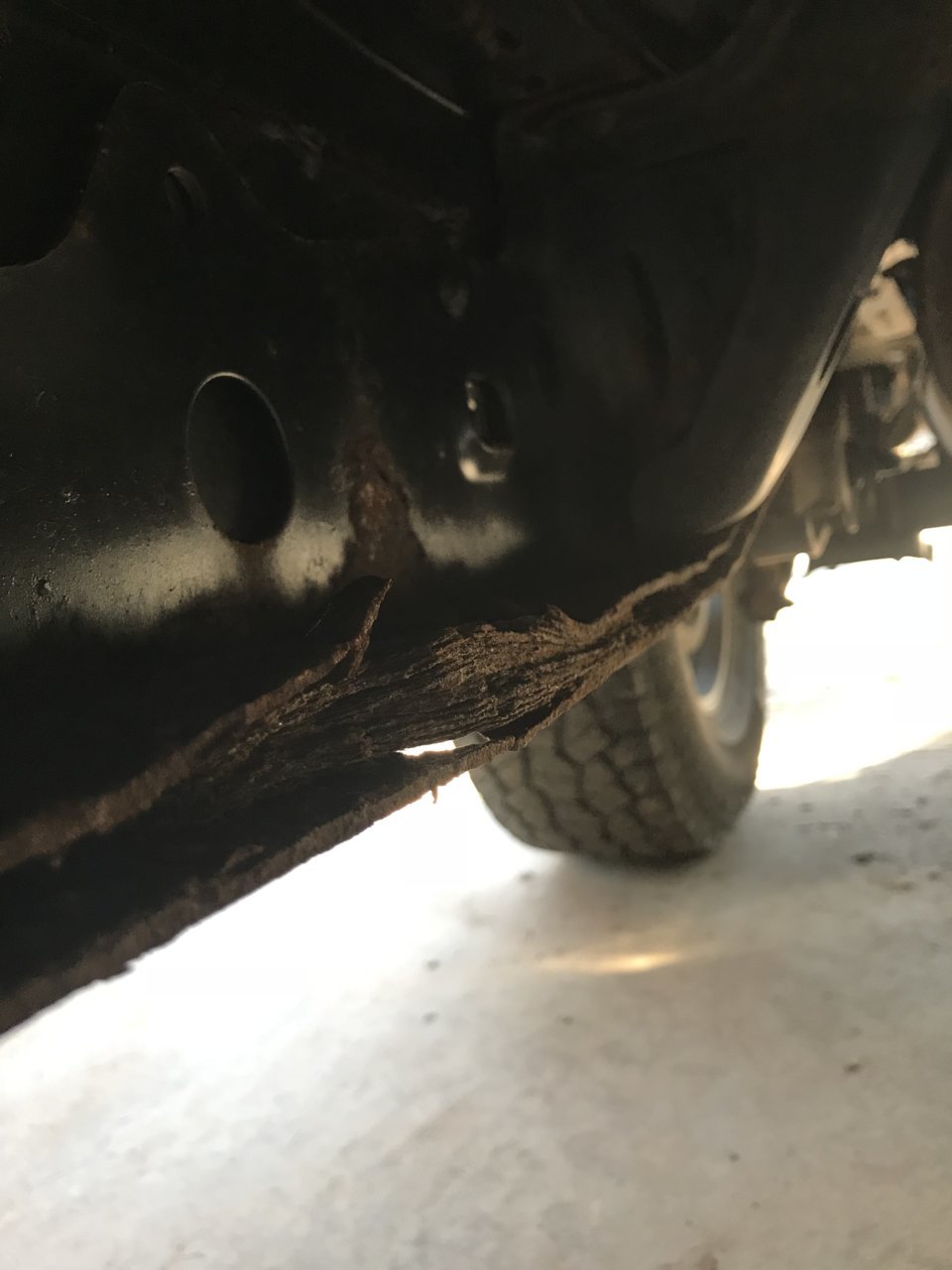

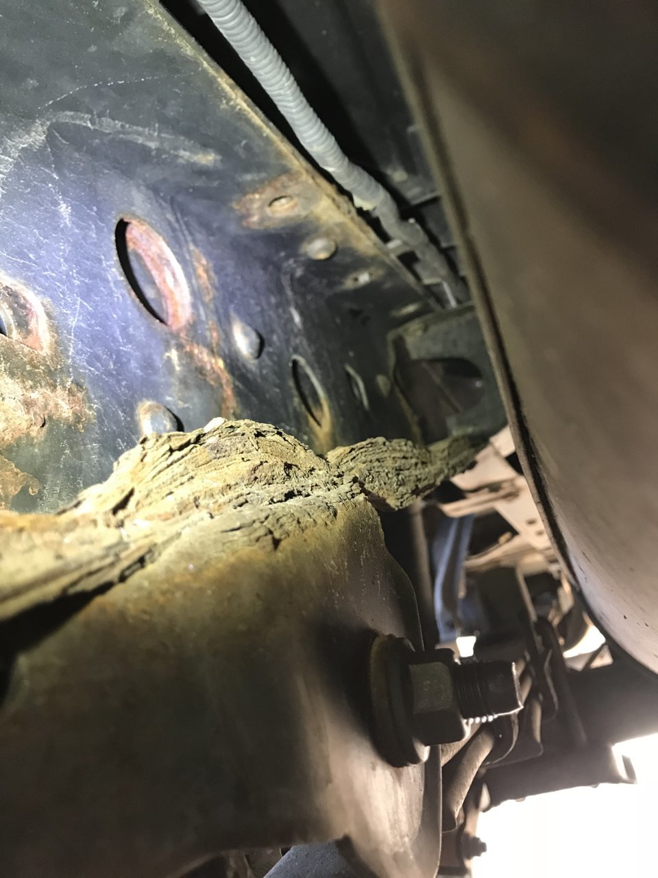

    Do you happen to have pictures of your delamination that caused it to fail? The reason I ask is because it would be ammunition against my dealership where they passed my frame for the same issue. Would be a huge help. Thanks!!

    Go to a different dealer and show them your pics. I wouldn’t volunteer info about previous dealer opinions.

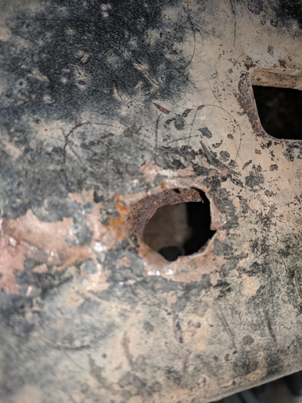

    The second dealership sent pics in for review since it failed in their eyes but didn't include meaaumeasure of the hole. I received a call back from the first dealer after I left a bad review about them and after closer look agreed with me that something is wrong with my frame. They have a regional service tech coming out next Wednesday to do another inspection. I dropped it off today and they set me up with this. So another week and I'll have a corporate decision.

    This is you only option unless you find a sympathetic dealership. I got lucky with my 06, my 12yrs since 1st use is up, but Toyota extended it to the 31st of this month. I got the ball rolling before the 31st and I'm grandfathered in. Pending a corporate inspection next week.
    It's been a 5 days so far, and by the 6th it will have been an 11 day process just to find out if I qualify. It shouldn't be this hard when it's so obvious it qualifies.
    One dealership said I created the hole, the next tried to say it was a hole from the manufacturing process.

    My hole was right under the driver's seat inside the frame next to the catalytic converter. Toyota of kirkland escalated my frame to the warranty dept immediately, where bellevue said it was fine, twice, in a 3.5yr period.
