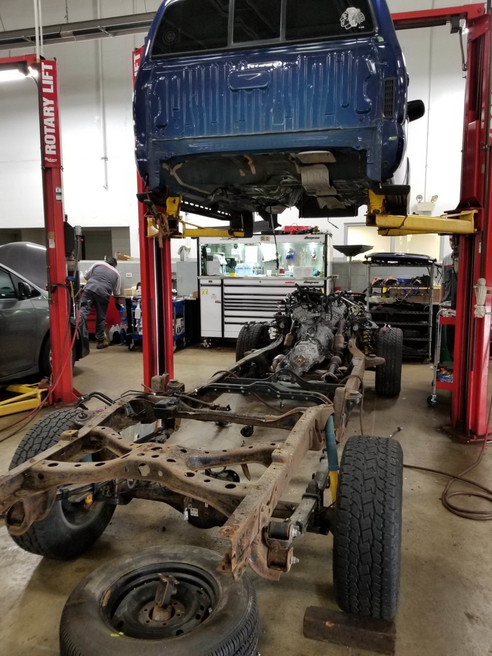

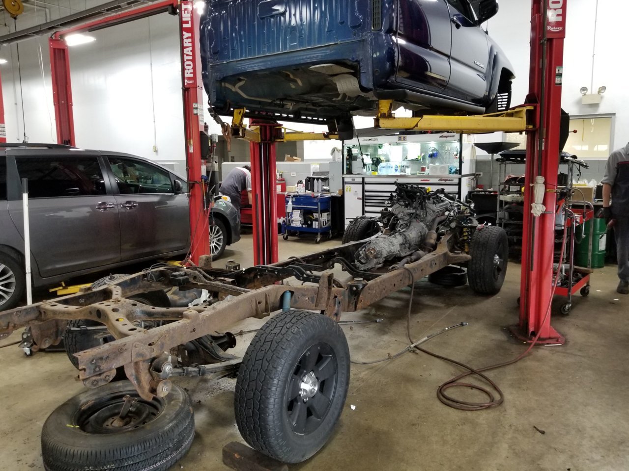

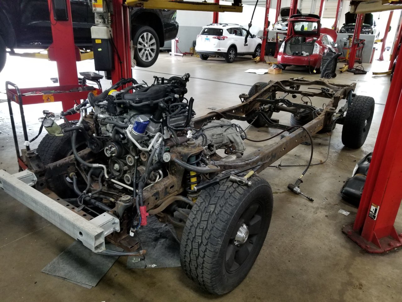

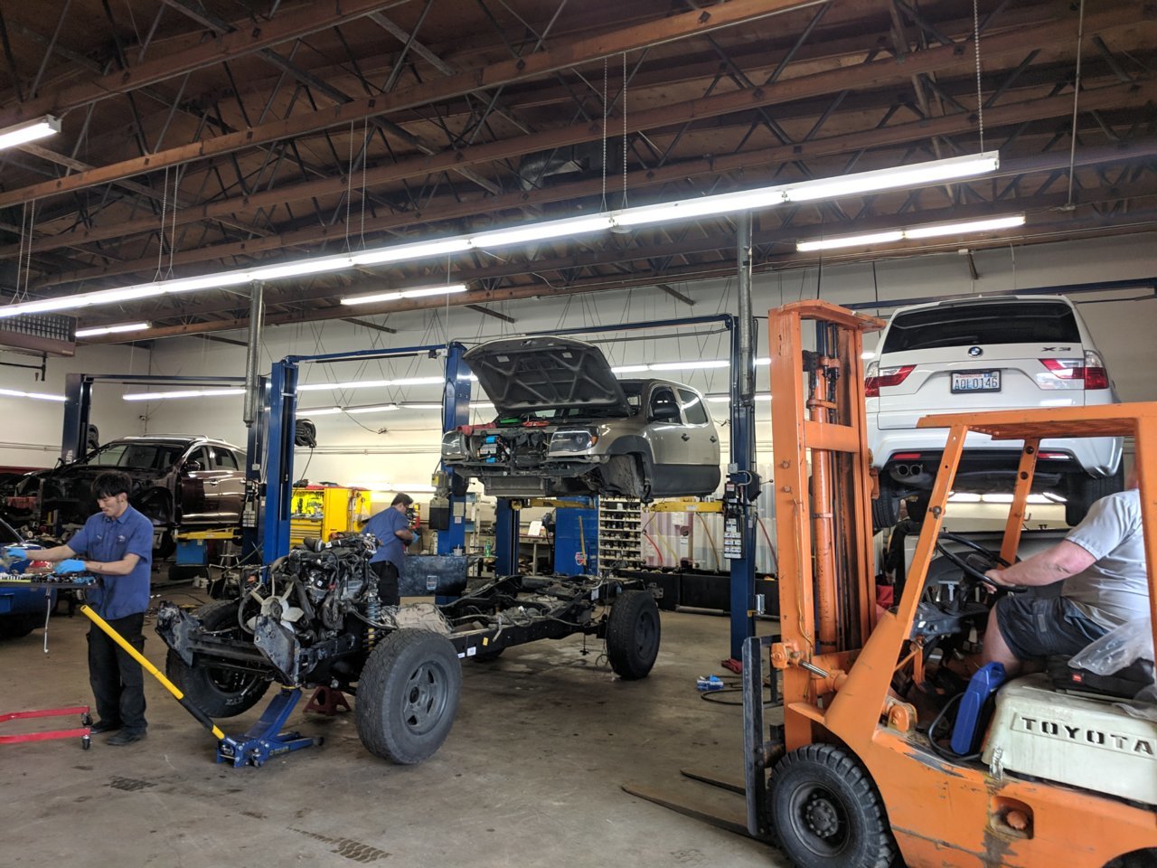

    On the home stretch. I'll have it back Monday.

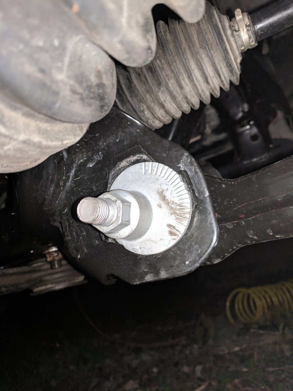

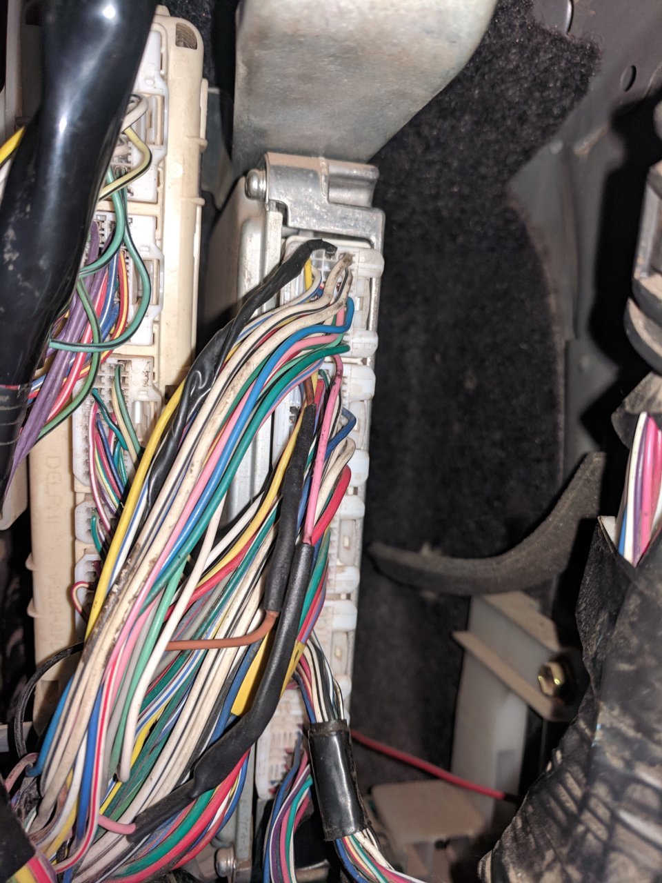

    Ooooohhhh where do I begin....
    They first tried to give it back to me with a major misfire and a loose pin at the ECU plug was to blame. They called me up said it's ready, nope not this time. Then it was a loose pin at another plug. It took 3 times for them to fix a problem that wasn't there when I dropped it off. Problems caused by someone being too rough with the plugs that need to be unplugged to remove the cab from the frame etc.
    Finally they got it right, drove it home and 2 days later the truck starts to pull to the right. They didn't torque down the nut eccentric on the lower control arm and now I've got a flattened cam tab on a brand new frame.
