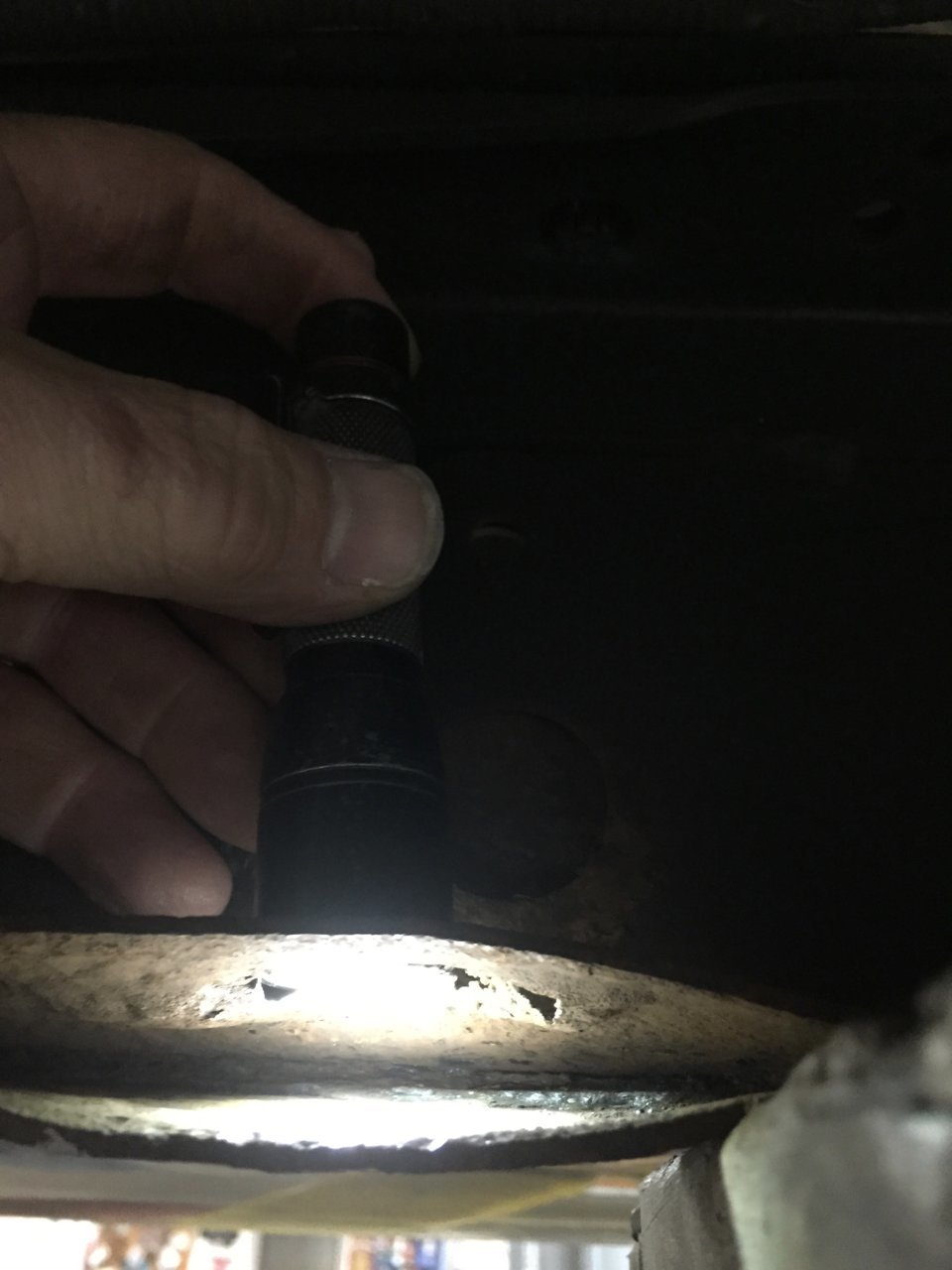

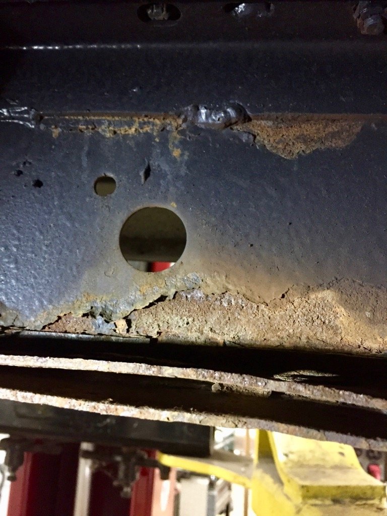

    357
    Ray
    2008 Rugged Trail Tacoma
    This is my frame. Only took a few weeks to come in. They are waiting on the hardware but said the job should start in under two weeks.

    YotaFamily3
    YotaFamily3 Parts Enthusiast =P
    Apr 23, 2019
    #291049
    28
    Megan
    Ohio
    2008 TRD Sport DCSB Speedway Blue
    Nice! Shouldn't be too long. What are your plans for corrosion resistance once you get your truck back?

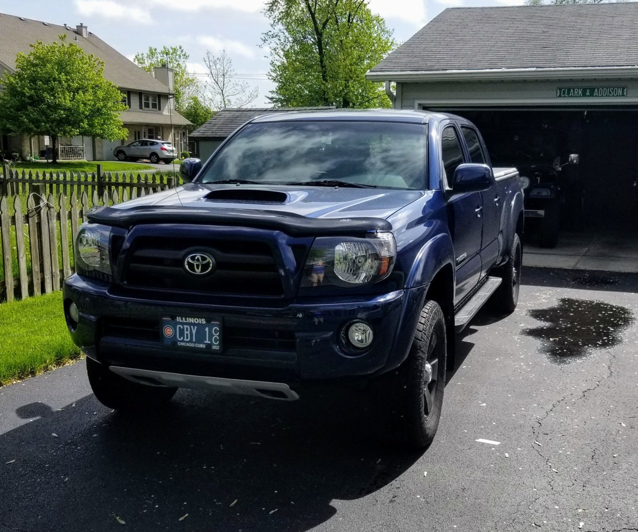

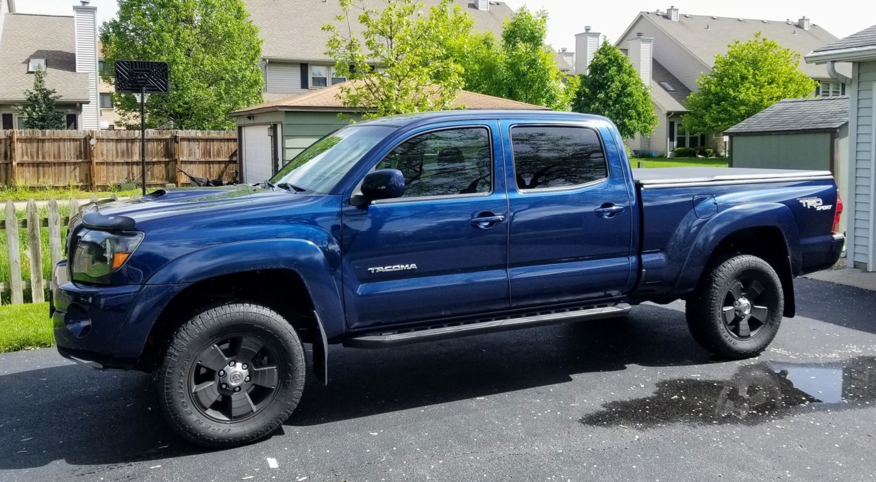

    mikenilson
    mikenilson Active Member
    Apr 3, 2007
    #1222
    28
    Chicago Illinois Area
    Yes!
    TRDSport10 and bobsuruncle like this.

    TrailRayted
    TrailRayted Well-Known Member
    Apr 14, 2019
    #290082
    357
    Ray
    Looks great . I like the blue!! Skid plate amd black wheels too!!
