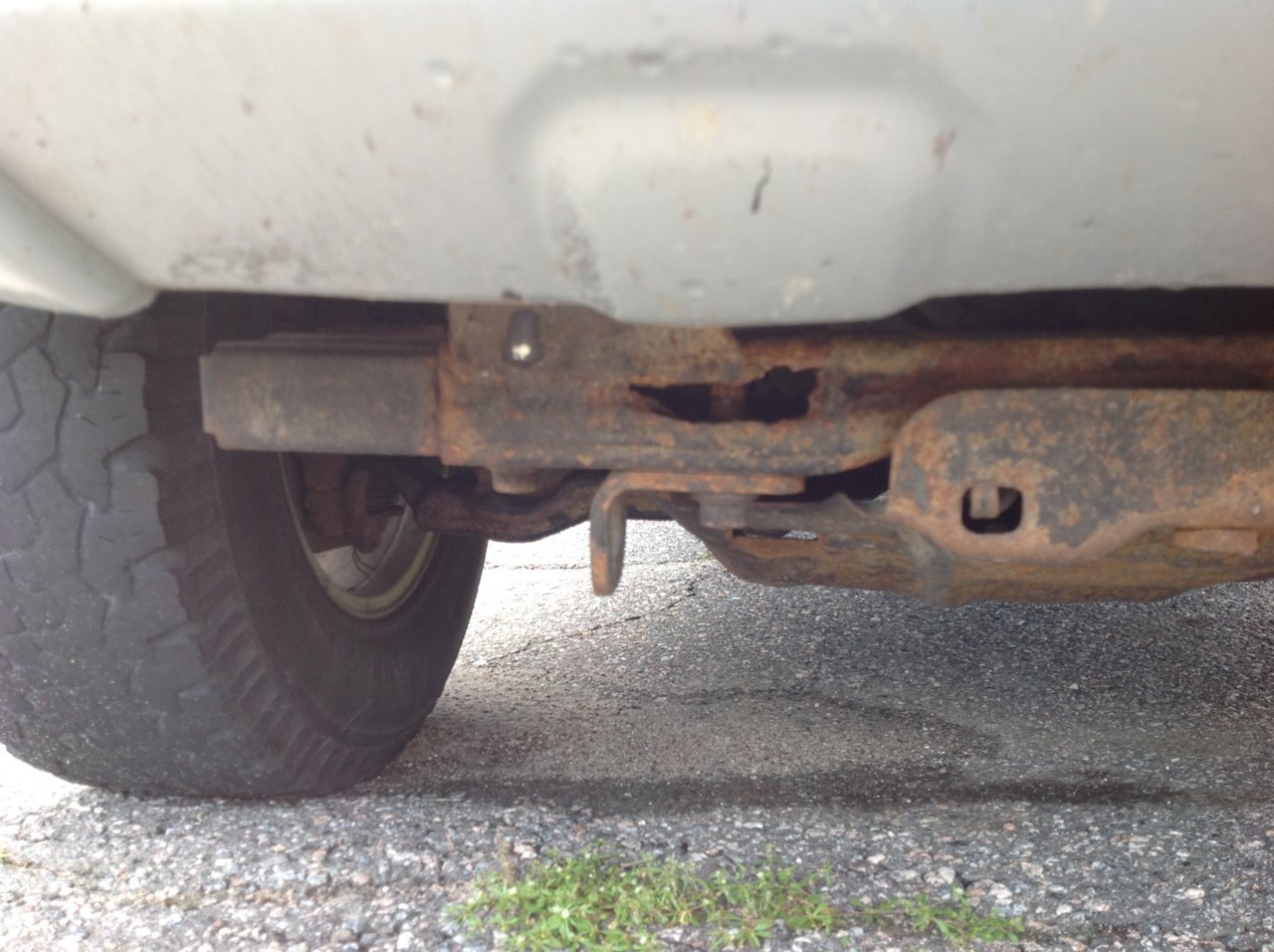

    1. I was just told I qualify for a new frame, 08/08/19.
    Now I got your attention, here's the story.
    Bought the truck used, 08 dc, 4.0l, mt., in 2015.
    Northern Ontario truck, the coated the frame after I took ownership. Then I learned about the frame issues, inspected myself, had them reinspect, all's good they said, and I got 15 years from service date because of undercoating the frame.
    Then I hear all this talk about changes in lawsuit (or whatever), and now the warranty expires this year sometime.
    So I go to dealership, ask questions, and they offer another inspection, all's good, but I'm past any warranty. But they'll do another scrape and coat(didn't think I had it before, no records, who knows).
    So they start a scrape, and low and behold, there's big holes at the front tow rings, and I now qualify!
    So, after all the b.s., just waiting for confirmation tomorrow, and then wait for a new frame.
    Moral of the story, don't give up.
    There! Confirmed! Now the 6+ month wait for a frame. Long list ahead of me.
    And, have to go through these posts to see what I should get changed while they're at it.

    Greetings Tacoma Drivers, New to this forum today, but reading with interest the information about frame replacements on the Tacoma. I am driving a USA 2006 Tacoma and have owned it since 2008. I reside in Canada with it. At the moment struggling with Toyota USA and Canada as I seem to be stuck in Limbo. In 2016 I took my truck in for the frame inspection and at that time it passed and was sprayed with their CRC. They told me all was fine. In May of this year I was changing out my tires from winters to summers and wow noticed a bad section in the frame that fit the description of frame rot. I immediately contacted Toyota and they setup an appointment for May 15th. I took it in and this is at my local Canadian Dealership. They said yes it failed, but I missed the deadline for USA trucks which according to them was January 31 2019. However I am reading on this thread that Toy4me, has had his truck in on Aug 5th not 8 days ago and says he had his inspected failed and is now inline for a new frame. What gives and how do I get mine fixed? Could really use some help here, my truck is in excellent shape all over and only has 84,300 miles on it. Really appreciate any and all advice at this point. Thanks
  9. Aug 13, 2019 at 11:27 AM
    #3669
    Muddinfun
    Muddinfun Well-Known Member
    Apr 17, 2017
    #216500
    7,489
    Yes, you are in a bad spot. Even though your Tacoma was built in the US, the settlement goes by where it was originally sold when it was new. There are 2 class action lawsuits. 1 for the US and 1 for Canada. The US settlement specifically states that the settlement doesn't cover trucks imported from other countries. You are in a unique situation where yours is imported to Canada from originally being sold in the US.
    As far as the dates, all 2005-2010 Tacos were covered till January 31, 2019 for US trucks and July 21, 2019 for Canadian trucks. After that it's only covered for 12 years from date of 1st use. (The date it was 1st sold at the dealer) Unfortunatly, that time is past for your 2006. Toy4me's truck is a 2010. That's why it's still eligible for a frame replacement.
    My truck was originally sold in Canada and is currently in the US. I had to drive to Canada for the frame inspection and approval. I will be making another trip up there when my frame comes in.
    As for your sitiuation, you need to look very closely at the Canadian settlement. If it doesn't say anything about trucks imported from other countries, you MIGHT be able to argue your case and win. I wouldn't take the dealers word for it. You need to contact Toyota Canada. Hopefully your Canadian dealer documented the inspection in May.
    Ideally you should have driven your truck to the US for a frame inspection before January 31, but that's in the past now.
