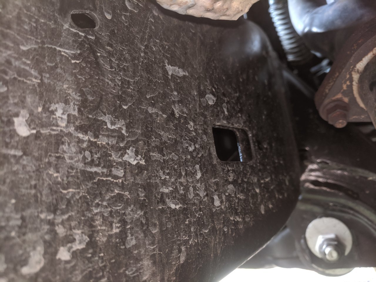

  16. Sep 28, 2019 at 3:03 PM
    #3756
    bobsuruncle
    bobsuruncle PhD in voiding warranties
    Feb 17, 2015
    #148863
    7,338
    Bob
    Fall City, WA
    06 TRD OR DCSB
    ARB bull bumper Warn XD9000 Icon 2.5 EXT Road Armor rear bumper Archive Garage shackle flip FJ/T4R tcase 4.30 gears Dirty5’s T4R rear axle swap w/disc brakes New frame from Toyota under EWP
    As far as I can tell, they're still the same visually, but the replacements are a revised/updated version. Things like changing the location of holes to eliminate excessive water to enter the front boxed portion, installing frame hole plugs in most holes that previously where wide open and also using caulk to seal the void between frame layers. This is my 06 on a new frame that was replaced at the end of April this year.
    I haven't found any concerning signs of it weathering yet here in the PNW, but will be keeping an eye on it over this fall and winter.
