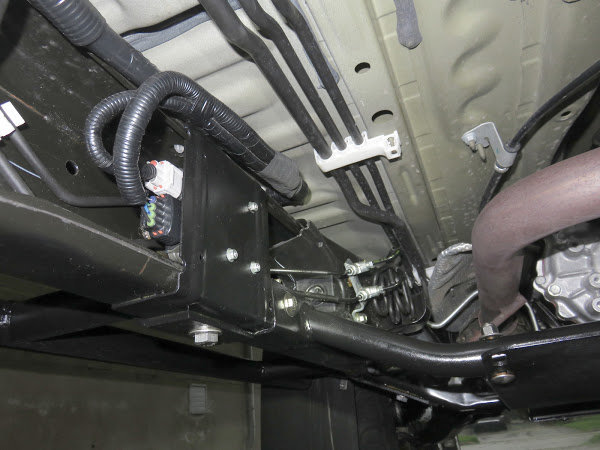

    Looks like it incorporates a lot of the improvements made in the 3rd gen frames. If you remove the plastic cover by the brake line bracket and peek inside, there should be a waxy cavity coating in the boxed section of the frame. I discovered that while mounting sliders.
    XHZ0pDWdX5HteVroJGOK0Byu1_FRjLTZ2uTujVQX_c05dfc455e9397fb4e7acd81da1d8ae444ee3726.jpg
    What does your cab mount look like? Is it the beefier type like 3rd gens?

    I have heard that in the past. I watched them do mine and it looks nothing like that. Time will tell I guess. I hope my auto body guy wouldn't steer me wrong after all these years.
