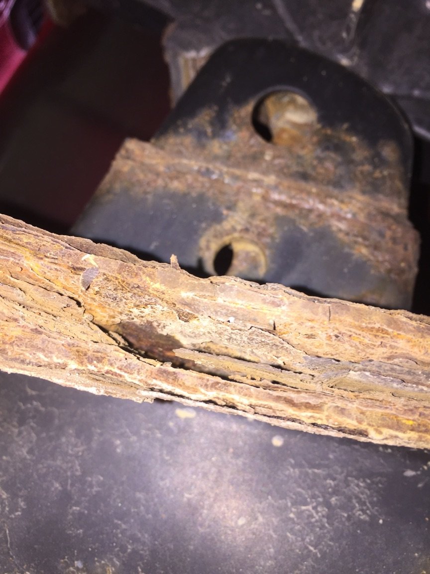

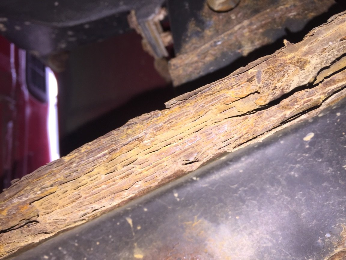

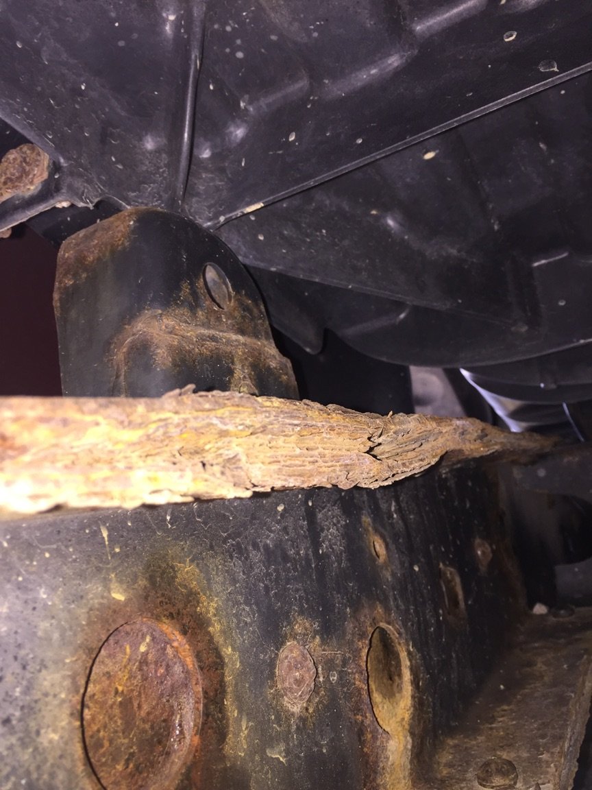

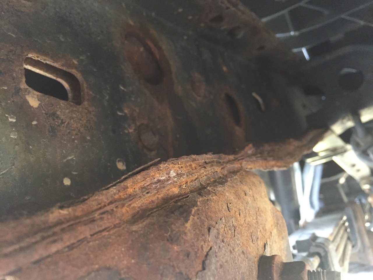

    IMG_6656.jpg IMG_6653.jpg IMG_6654.jpg IMG_6649.jpg I have read through about a hundred pages of this discussion and haven't seen anything that pertains to my exact situation. I was hoping to get some insight on my current situation (I know it's a dead horse). I have an 08 Regular Cab 4WD that has been sprayed a couple years ago but still has some rust near the rear leafs. I have heard talk about them not covering a frame if there is lamination issues. I also know about the 10mm perforation and that's where my question comes from. Based on the pictures would this be considered a perforation? There is not much left of the frame in between the two layers of frame on the back passenger side. So basically I was wondering from all of your experience if this would justify a replacement?

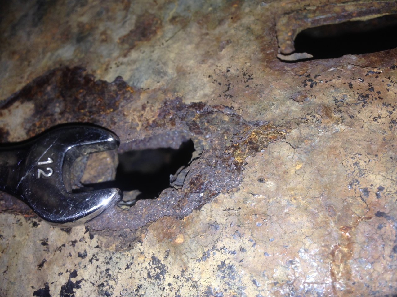

    In order to be 100% qualified for a new frame, there needs to be a 10 mm hole. As bad as that frame looks, surely there's a hole somewhere. You need to find it before you go in for an inspection. The most likely places are near the catalytic converters. If you see a bubbled up spot, you can VERY GENTLY tap on it and flake away compromised metal. HOWEVER, if it looks like you've been punching holes in it, or you admit that you punched a hole in it, you're totally screwed for life. If the metal bends inward, bend it back out flat.
    To qualify for a new frame, your truck also has to be less than 12 years old from the date of 1st use. With a '08, you are in the 11th hour and even possibly too late, depending on when your truck was 1st sold to the original owner.
    Here's mine after I gently tapped on it.
    SAR Taco, TRDSport10 and TacoBreaker like this.

    Yeah, I’m the idiot that admitted I made the hole so don’t repeat my mistake. No bends. No tool marks. No shiny. Try compressed air if it’s really flaky. Take your skid plates off and peek up front. The most likely spots are up front in the boxed area of the frame. My 08 had no treatment on the inside so it literally rusted out. I had a spot so bad I pushed my thumb through not even trying. Should have broke it off and let another Ohio winter cover the evidence and played dumb in the spring. So figure out your trucks first use date. Mine was made 2/08 and bought late April so you may have time. Get a bright flashlight and take your time.
