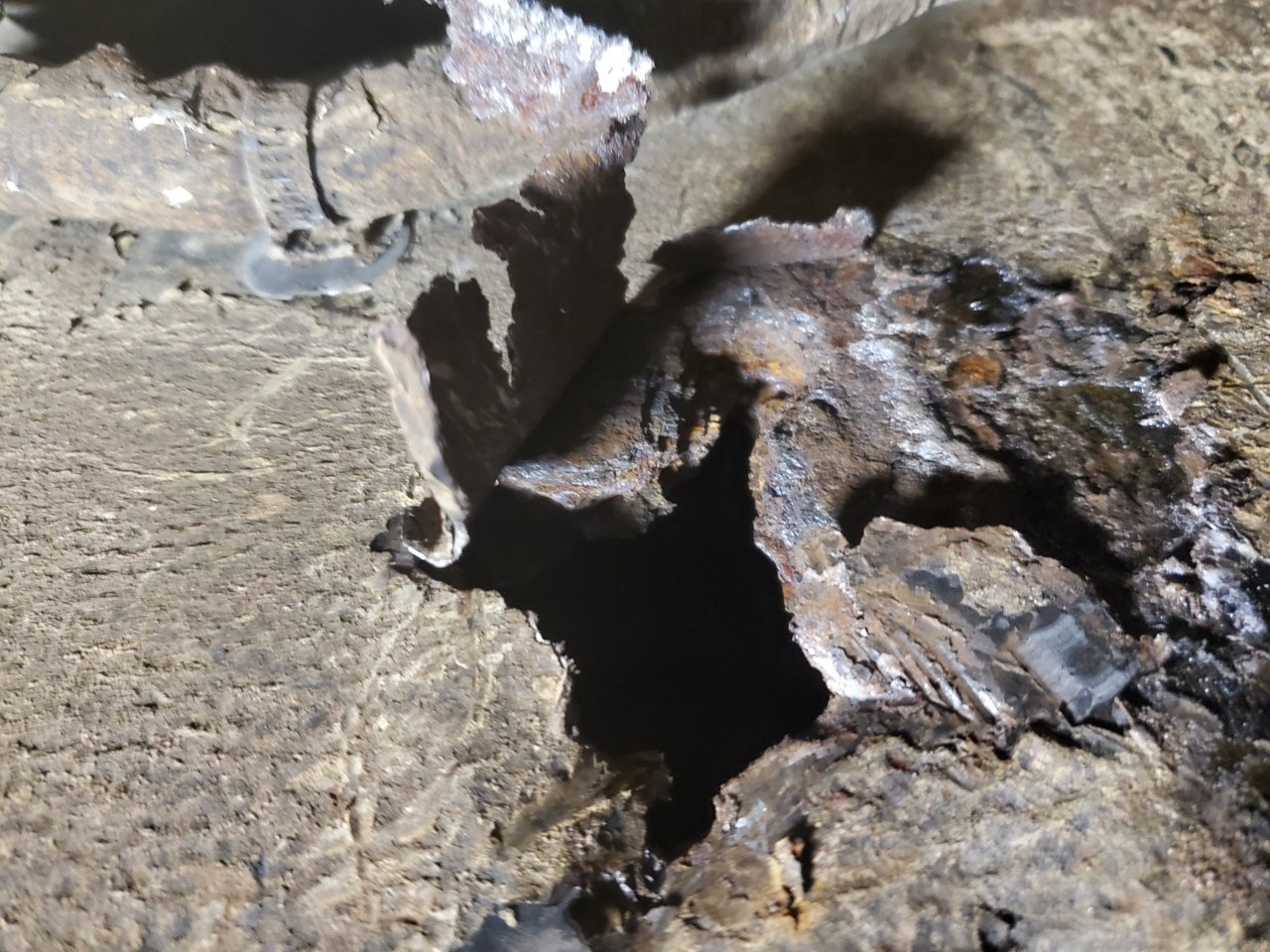

    So...I should clean this up and let the salt eat it some? Or am I screwed? This was hiding behind my under coat, as I scrapped my chisel just went through.

    Ah fuck dude. Mines a Rugged Trail too, freaking awesome Tacoma. Being an 08 you’re on the clock, but don’t rush. Please go back and read my previous posts most are on this thread the rest in another. Toyota disqualified my frame from the program due to “outside influence” because my thumb went through the frame. Can’t be any bends, shiny, tool marks, etc. Make sure you talk to service manager before you take it in and you only found it, didn’t touch it.

    figure our when the drop dead date for you frame it. maybe let it sit for a month or two.
    But I wouldn’t say shit don’t even say you found it. just take it in for the inspection.
    But congrats on the new frame. think about shocks/ steering rack ect.
    much cheaper when the trucks apart.

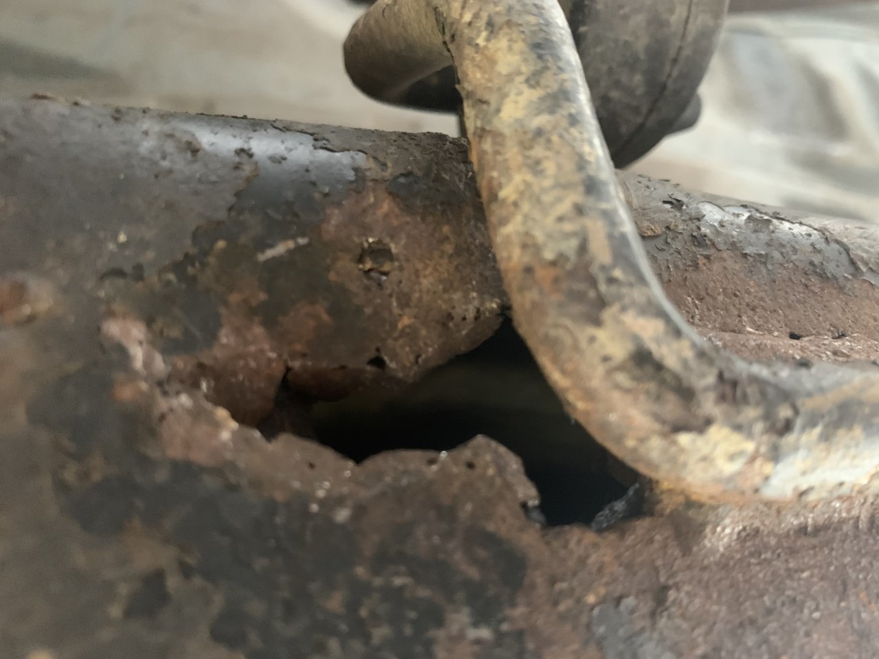

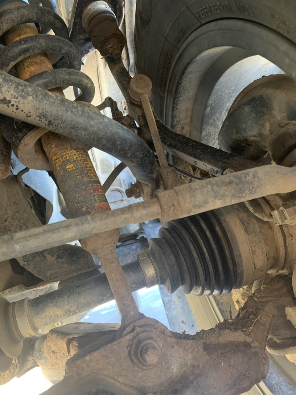

    IMG_0203.jpg IMG_0188.jpg My 08 DCLB TRD sport just failed its frame inspection this past week with 101k Miles on it. Hole at the exhaust support bracket. I'm hoping for a cheap and smooth replacement process. After looking things over, the shocks and brake calipers are the most rusted parts I can see, other than the frame. I took pictures to document everything before the dealership got a hold of it. Brakes seem to be working fine. Original rotors and just put first set of pads on it at 95 k . Any recommendations on shocks? Not really looking for performance, just a smooth ride. Any other parts worth having Toyota tackle while their in there?

    Good luck to you! The replacement on my 07 was pretty smooth. Only recommendation they asked me to replace was my rear shocks since they were rusted through. Charged me around $120 for some Offroad Bilsteins and didnt charge me labor. I was happy.
    My undercarriage is was similar to yours in some aspects, if I have the tools and time, I'd love to take off some of these parts and grind down the rust then protect them.
    Good luck!
