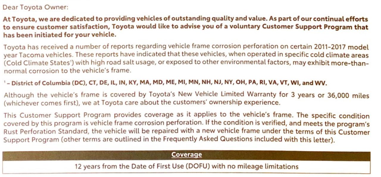

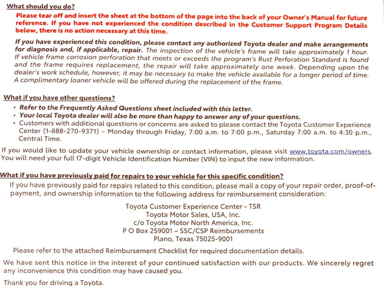

    I recently received a rust-related memo from Toyota and wanted to share.

    Oh shit, WA was previously covered with pre 2011 MY. I guess not on 2011+.

    Yeah, I noticed that as well and it doesn't make sense as, depending on where a WA resident lives, temps/roads can beat up a Taco. I've been to most of the places listed on the memo, so I plan to get my truck looked at. I don't see anything obvious, but I'd like to make sure before anything gets out of hand!
