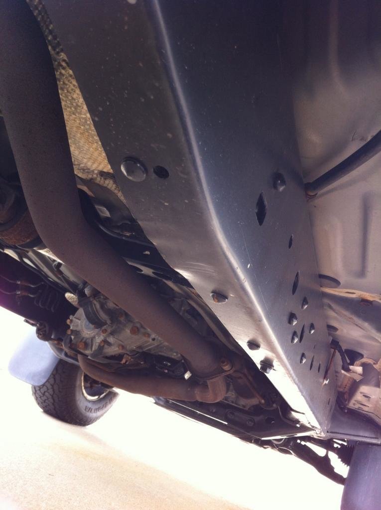

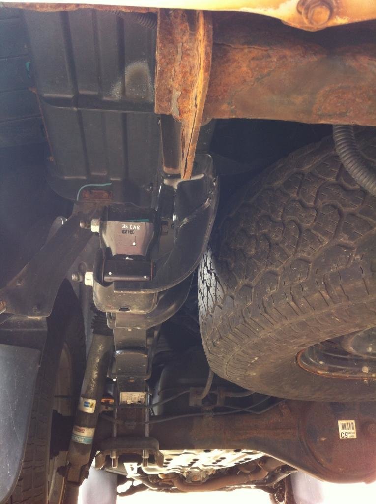

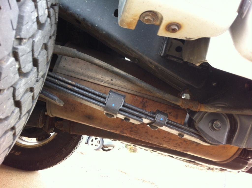

    Here you go. I wish they would have replaced the tow package subframe which is flaking badly, but hey can't complain when they replaced the frame, leaf springs and brake lines. Rides like a new truck!

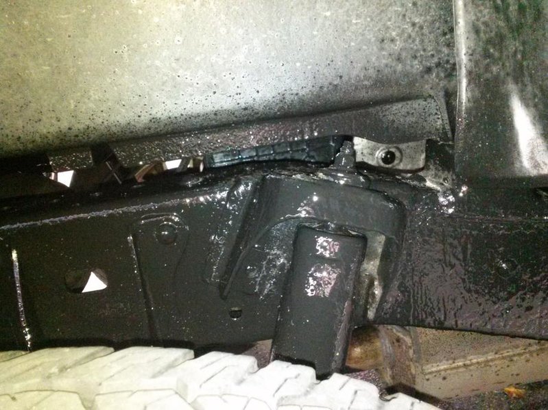

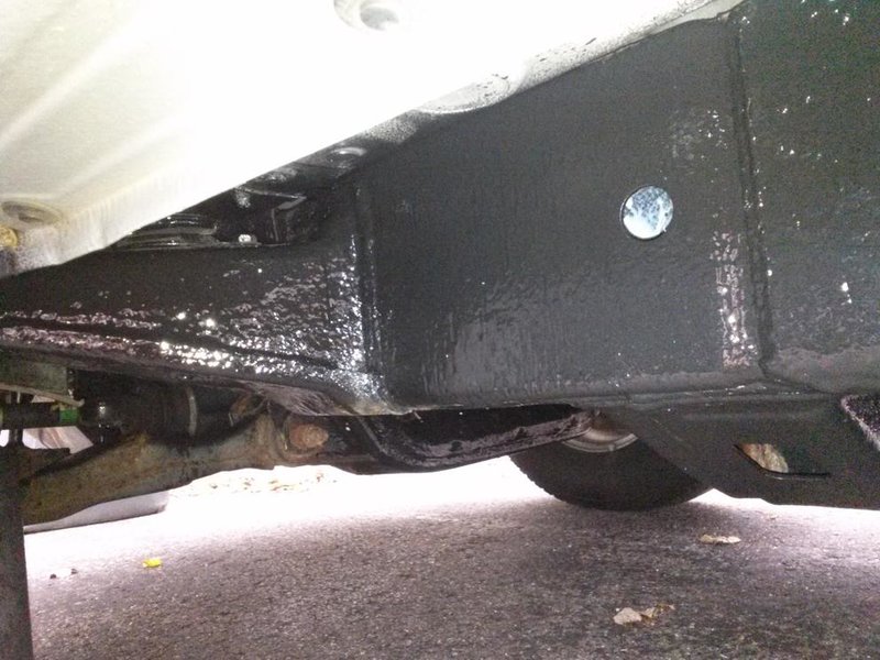

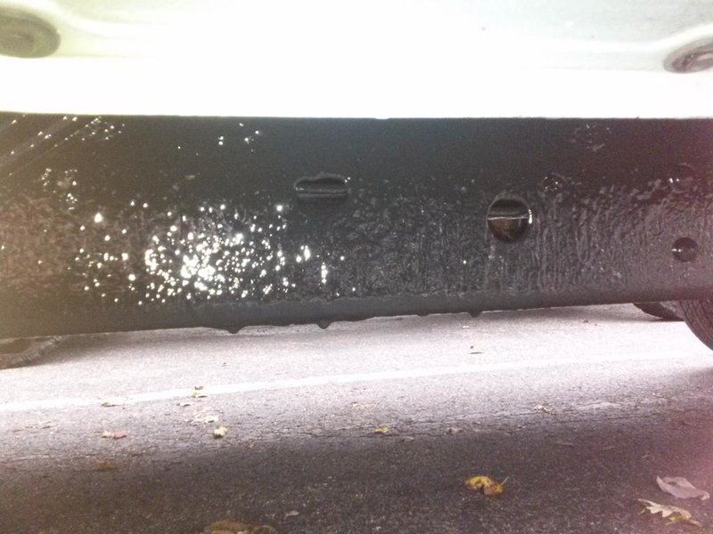

    Just picked my 06 up from the dealer. I had the spiral cable fixed in the steering column and also the frame rust fix. The dealer said that my frame was not badly rusted and they sprayed it. I honestly think the spray job looks horrible and drippy. I'm not sure that I am happy with the results. see the pics

    My frame looked better before they sprayed it. I also asked the service tech if toyota had come up with the fix for the leaf springs breaking, he said they are expecting a fix any day now.
