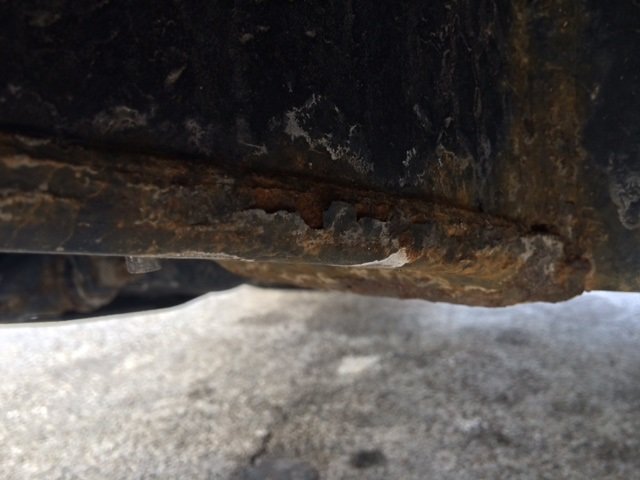

    Front cab mount, driver's side, pictured from below the door, correct?
    That won't actually fail, you aren't structurally compromised in any way. However, your picture describes a very serious need for frame maintenance.
    That part of the frame is extremely vulnerable, since it is in the path of salt spray from the front wheels. You need to keep it clean of rust, and coated heavily with multiple layers of paint and tar.
    But there is an additional difficulty in keeping that area clean! The problem is that the hole for the mount bolt and rubber bumper has a lip around it, that basically directs salty water into the seam between the bottom plate and the side. That means that the attack is more from the inside of the cab mount than the outside.
    A second problem with that part involves the frame rail itself. If you look up inside the cab mount with a flashlight, you will notice that there is a big ugly hole in the back of it, providing access to the inside of the frame rail. Now imagine what happens when you drive through salty slush! It splashes up into the cab mount, coats it thoroughly from the inside, and shoots through the big hole into the INSIDE of the frame rail. This is why these frames are rotting from the inside out near the catalytic converter(s)! Not because of heat, but because they are subject to salt blast from the inside.
    So what you need to do right now to fix it, is;
    1) Clean all that rust off.
    2) As much as is humanly possible, clean the rust off the inside of the frame as well.
    3) Paint everything. Lots of paint, multiple coats. Inside and out. Sprayers help a lot for the inside. Brush is good on the outside.
    4) When the paint is thoroughly dry/hard, tar it. Lots of tar, thick as you can, inside and out.
    5) Block off the cab mounts and all other access points to the inside of the frame rail! Just make sure that you don't block the *drains* near the rail.
