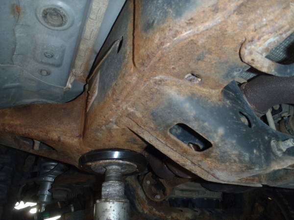

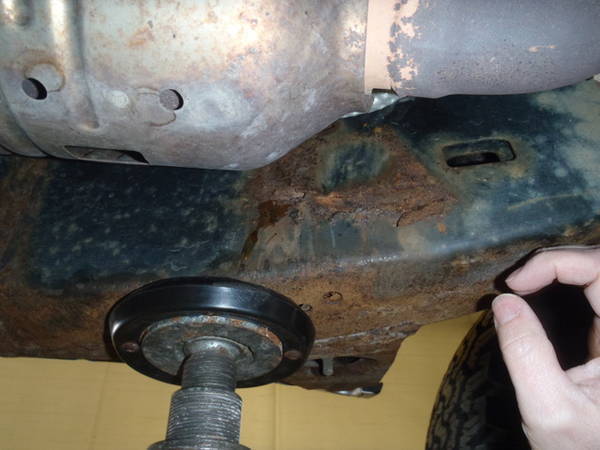

    Anyone happen to notice the really rusty lower A-arm in picture 4? One would think that maybe they would address that problem too.

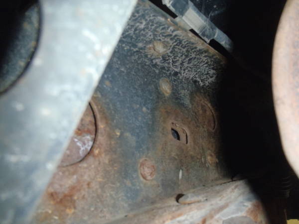

    This is the "punch test" hole they did. Near the cat driver side front.[​IMG]
    ed

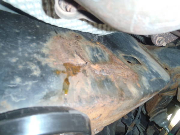

    Here is another view from the underside and some minor surface rust.

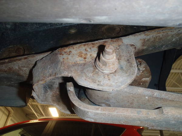

    This is the leaf spring and it looks pretty normal to me.[​IMG]

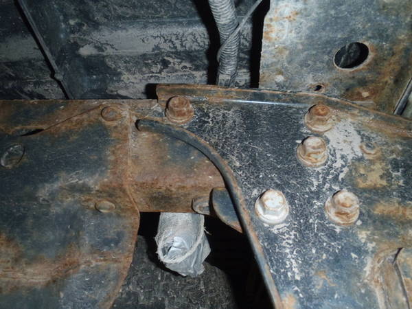

    These pics show the rear frame, hitch bracket (oem) and another shot of the front frame near the cat (where the problem really lies). [​IMG]
    There was some separation at seams and standard rusty flaky paint. I'm in Detroit, so this seems normal to me and I plan on driving my truck home.
