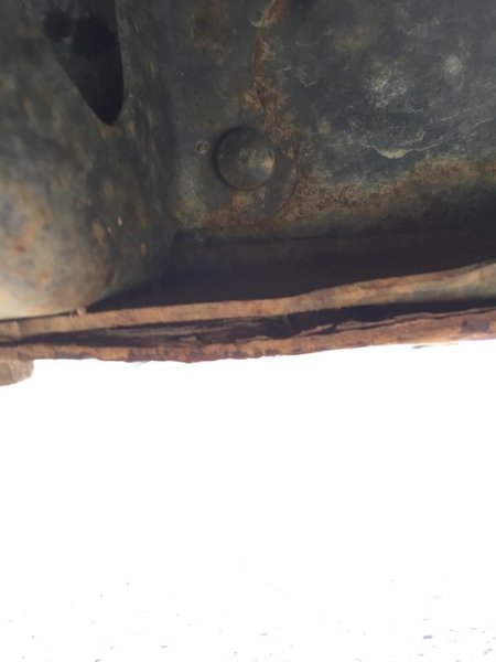

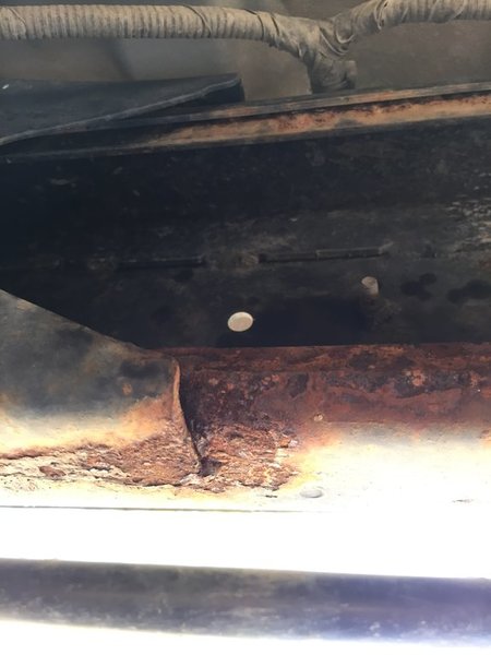

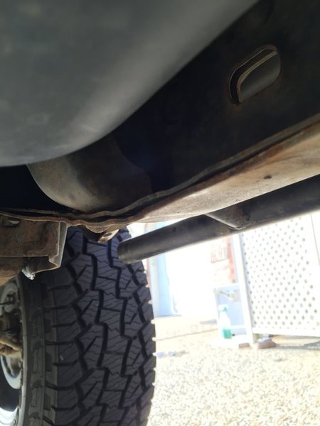

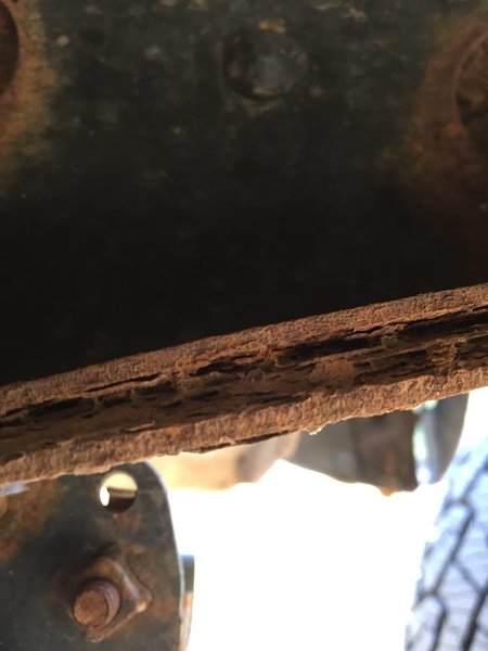

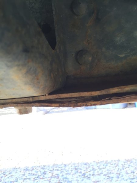

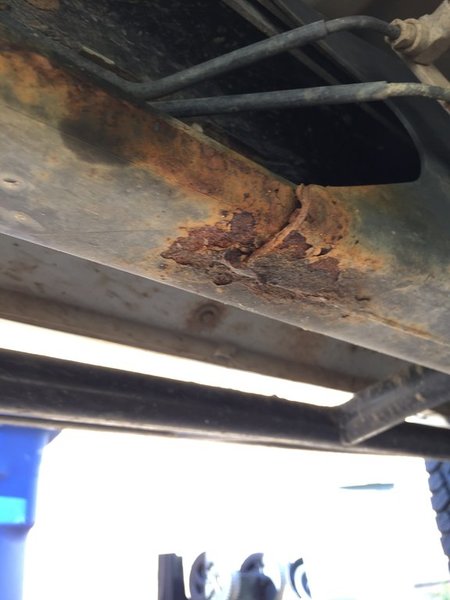

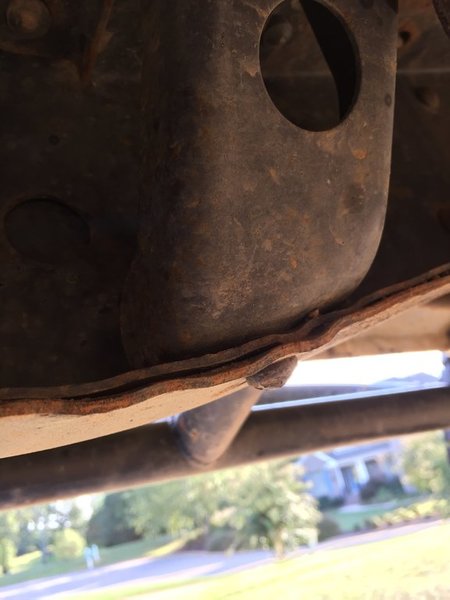

    Been reading through this thread for a good while now and have taken it upon myself to get involved with the frame swap fiasco. I have a 2008 DCSB that has been registered in Ohio and VA throughout it's life and just passed over 100K about a month ago. I figured I'd get hot on the issue given the March deadline. Ironically, the frame near the cats is in damn near perfect shape whereas there are other areas that are concerning. I'm seeing quite a bit of separation of the frame and "wrinkling" of the metal per se. The welds around the spring hangars are seeing a good bit of rust as are most other welds on the frame.
    How should I proceed given the pics below? I'm very weary of the frame coating but I'm not certain that it'll fail at this point but would like to get some feedback as to the general shape of the frame and how it will fare upon inspection. I'm hesitant about getting the coating applied and effectively put a bandaid on what will become a major problem down the road.

    The 3rd and 6th picture down looks like they will fail the frame, IMO. The dealers WANT to do a frame replacement. They make $$$$$.
    I would take an awl and see if u can poke through those rusted areas. If u can, the tool they use to punch through the rusted frame as a test will go right through it.

    I actually took a ball peen too it earlier and didn't get through but it felt softer than the rest of the frame. Hit it a couple times and could feel a protrusion on the other side of the soft spot on the outer side of the frame. Any idea on the layered part that's splitting? Looks as if it's rusting from the inside as many others on here have experienced. Does that warrant replacement?
    Note taken, appreciate your input.

    With a little persuasion, a hole can prob be attained :) Then wait a little and let nature enhance it before you bring it in.

    My frame was in better condition than that, registered in TN and NC. They managed to put a hole in it and fail it. Just take it in.

    Just take it in..... and let Toyota do whatever they do - because its better than nothing. If you get the 'coating' applied, I believe it will extend the warranty on the frame. Get details and get it in writing. VERSUS - if you deny getting the frame coating and 5 years from now you develop serious holes/soft spots...you're screwed and won't be covered.
    My frame actually looks pretty damn good....I had one soft spot that I figured was just 'surface'. I took it in....they poked a hole right thru it and failed it. I was amazed it failed. It was only a 2" hole. http://www.lieblweb.com/Temporary/frame.jpg
    I have appointment Oct 22nd to get the frame replaced.
