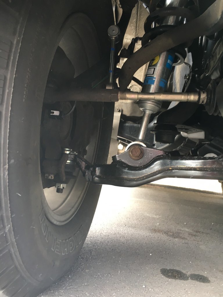

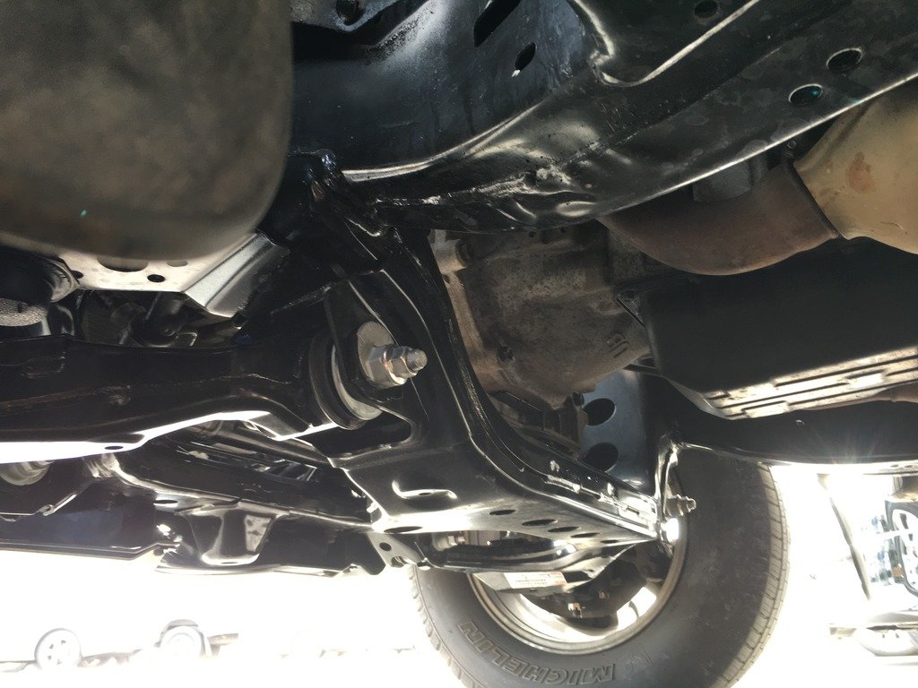

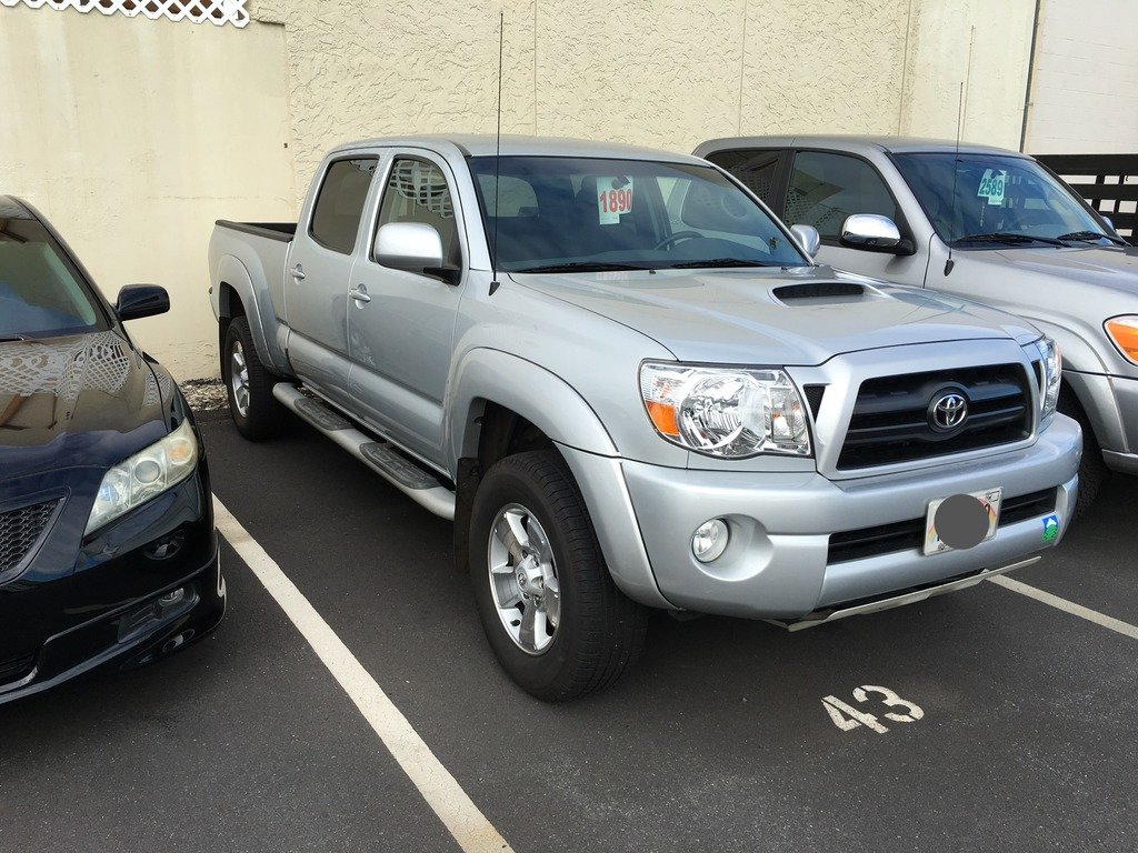

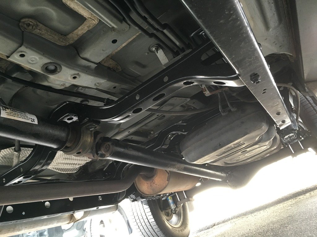

    My truck is basically done. They said the shifter cable bushing should be replaced and the part was out of stock so had to order it. Looks like a new truck from underneath. Should have it back next week. I'll see how it drives then. They also had a bunch of 2016s that just arrived. I thought they looked better than the pics I'd seen.
