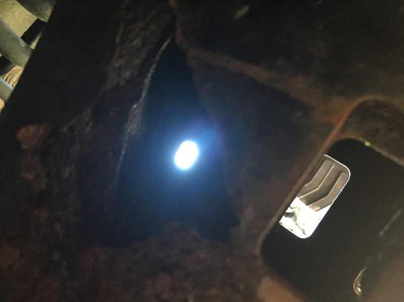

    Yeah, it was close to 6:00
    -I came in 15mins early for my 4:00 apt-
    So, for what I had done I suspected as much.
    Damn.

    image.jpg So...I go out again this afternoon to look at my "passing frame" in the daylight. 2mins picking at it...produced this.

    They didn't even look at it then.. I would give that dealership hell and have them reverse their findings and take it to another dealership for the replacement.

    Yes,
    I have been wondering what steps to take. I'm a little agitated.
    I see that you are from Boone. This happened at Modern Toyota in Boone.

    I used to be up there, Appstate!, but now I live around Raleigh..It's sad to hear that experience from them. I'd definitely take it back and give them hell, also contact Toyota Corporate.
