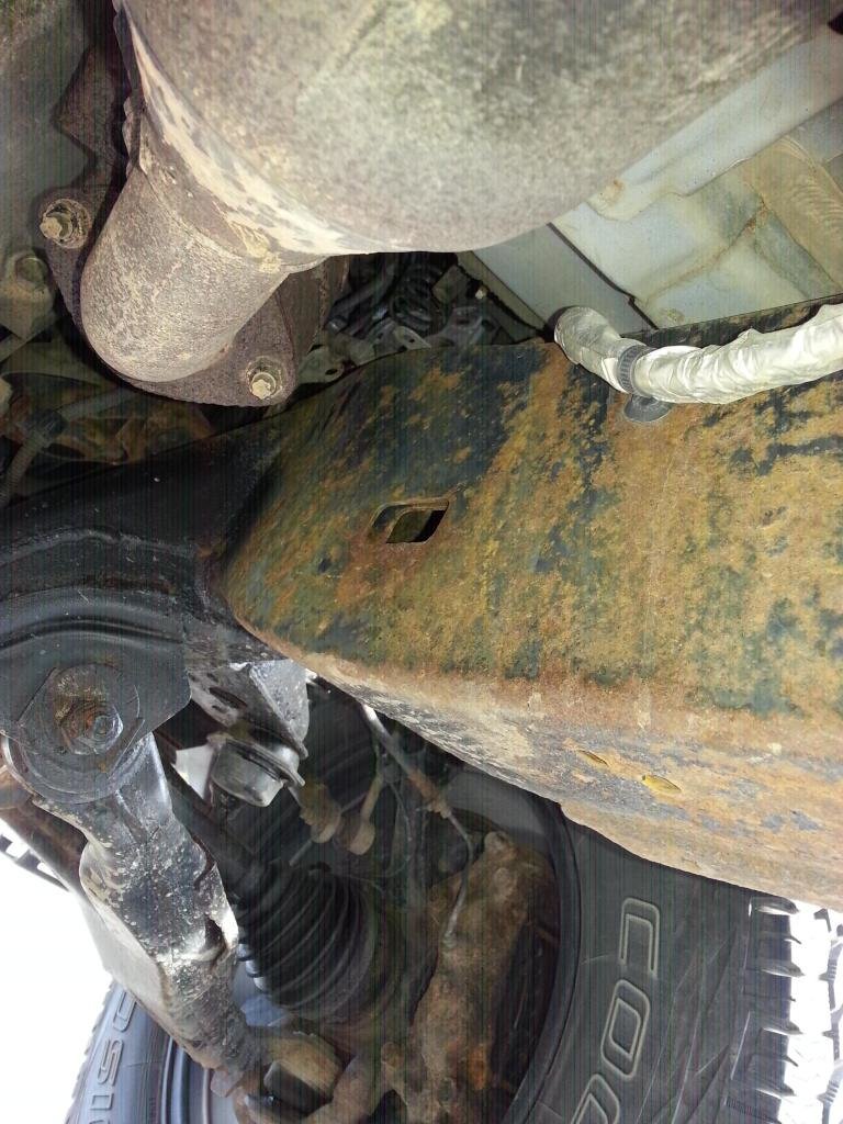

    I have an 07 and that has a similar spot ....
    And yea, if you push hard enough...you could poke a hole thru it. If you put your finger on it...it's soft. I can't imagine this one spot would fail it...but then again, I'm just looking at stuff that's in front of my face.
    Let us know what your results are ...You know I'm curious to know how this will end u.

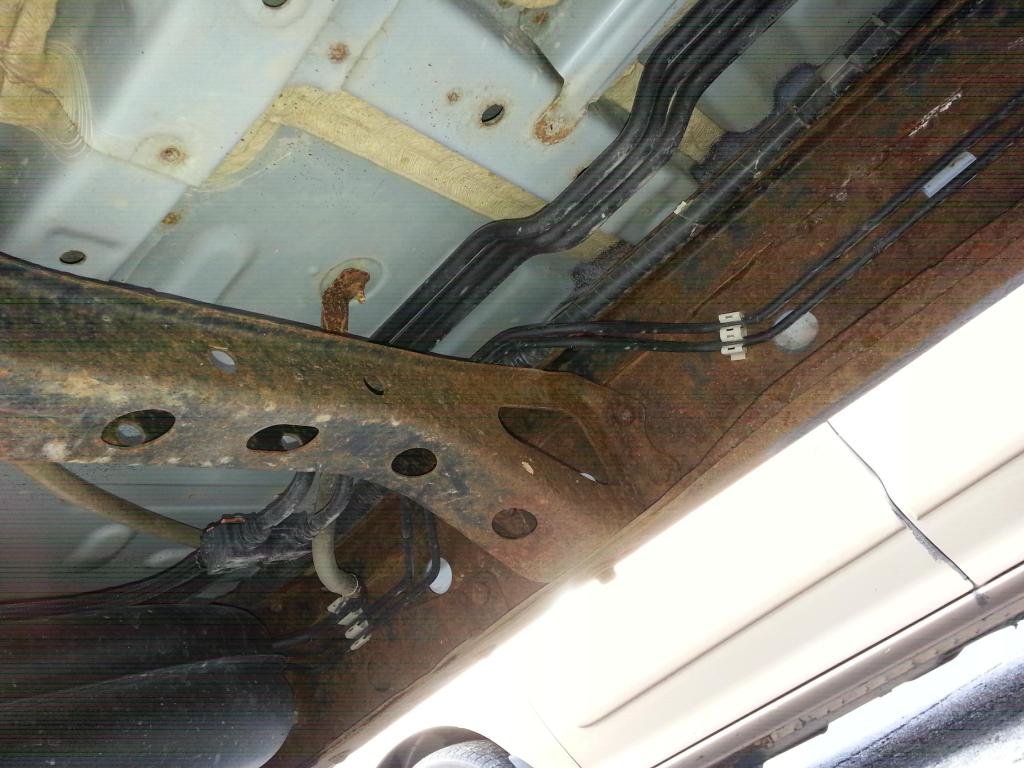

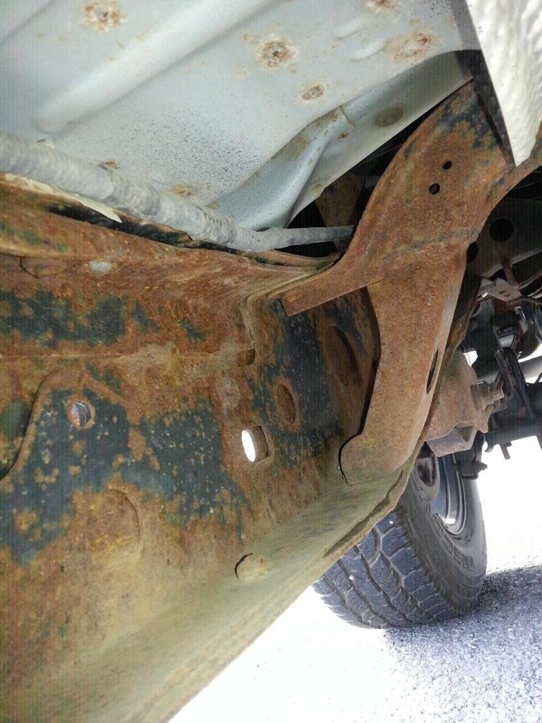

    Here's mine...looks like a lot of surface but nothing "too" corrosive. I dont see mine failing right now...
    I recently bought it from a dealer, and they coated the frame. This is what it looks like under their spray...

    That looks a lot worse than what I have. And they just sprayed over all of that rust?
