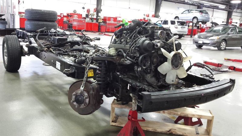

    Our 2005 is going in Feb'15 for a new frame, Have any of you guys done any prep before you took your truck in for replacement? I'm thinking things like removing lights and lightbars, unwiring radios(+antennas?), I saw someone saying they were taking off their canopy before it went in?!
  13. Dec 19, 2014 at 8:29 AM
    #173
    mad monk
    mad monk Well-Known Member
    Aug 16, 2013
    #110560
    148
    mid atlantic
    2007 TRD SR5 DCLB
    basics - westin nerf bars, extang tonno audio - JVC HU w/ axxess interface mod misc - screen cover for cabin air intake. Weathertech floor mats front & rear.
    probably not a bad idea considering the truck is literally taken apart down to the frame, (ie., the whole body is removed). Wouldn't want any special items to "walk" away or get damaged during the process.
