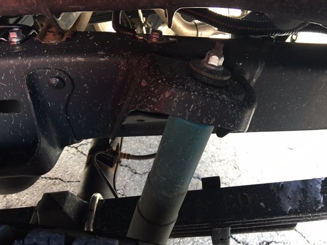

    My rear shock top bolts were replaced, but the shocks themselves were not replaced.

    Please explain. 2nd gen "rear shock top bolts" are welded to the shock, not seperate.

    Looks like it was just the nut replaced, not the bolt.

    This is the exact point I was trying to make; that not all shocks are being replaced. I noticed the new hardware but my shocks were not replaced.

    Someone correct me but no ones rear shocks were replaced for free, only the leafs.

    This is my guess.... Previously posted (way back) a couple users posted the entire repair bill for the frame swap w/ all parts and labor listed. I do not remember seeing Rear shocks listed. However, the recent post by the newbie service tech (Welcome by the way 1) stated they will replace parts damaged in the frame swap.
    So I believe both of you are correct ... they will swap the shock at n/c - but only if they have to .... If they use the original shock a new/different nut my be used ...
