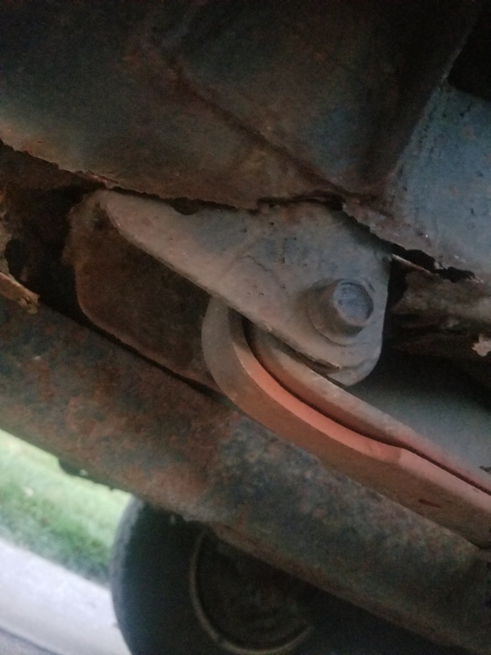

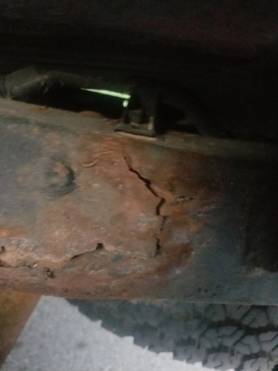

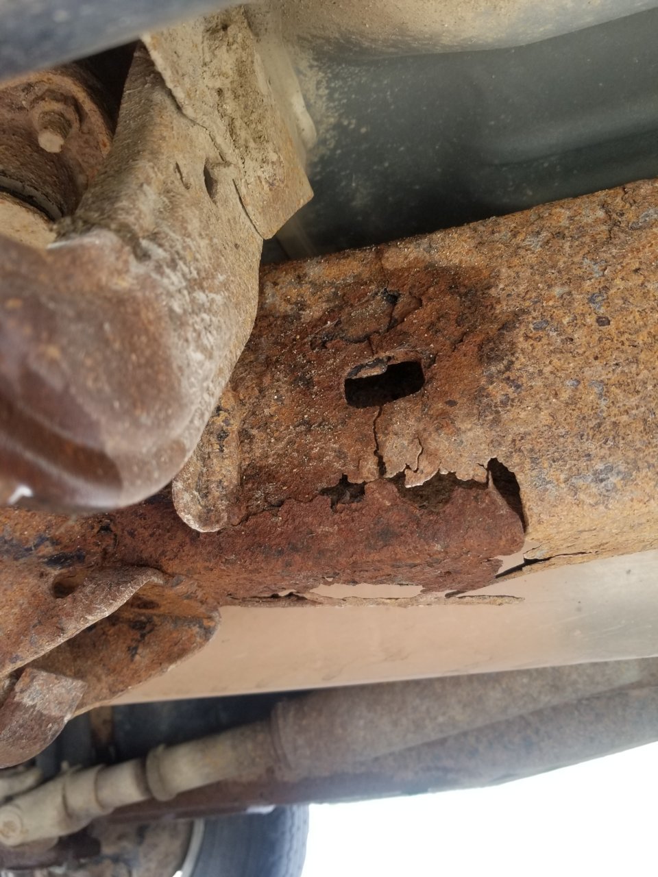

    Mine was way worse , if ya like the truck get it done. If your not a welder and dont want to learn.... have someone do it for ya.......shop mechanic, or a friend of a friend. You can save yourself money and 20190914_193644.jpg 20200404_131115.jpg 20190914_193704.jpg take the bed off yourself, only need one other friend to lift bed off, its 4 bolts. My spring shackle is up inside the frame.
    Your truck has a little over 100k wow ! That truck has alot of life left in it. Do it !!
    I safe T capped my frames at 300, 000 miles.
