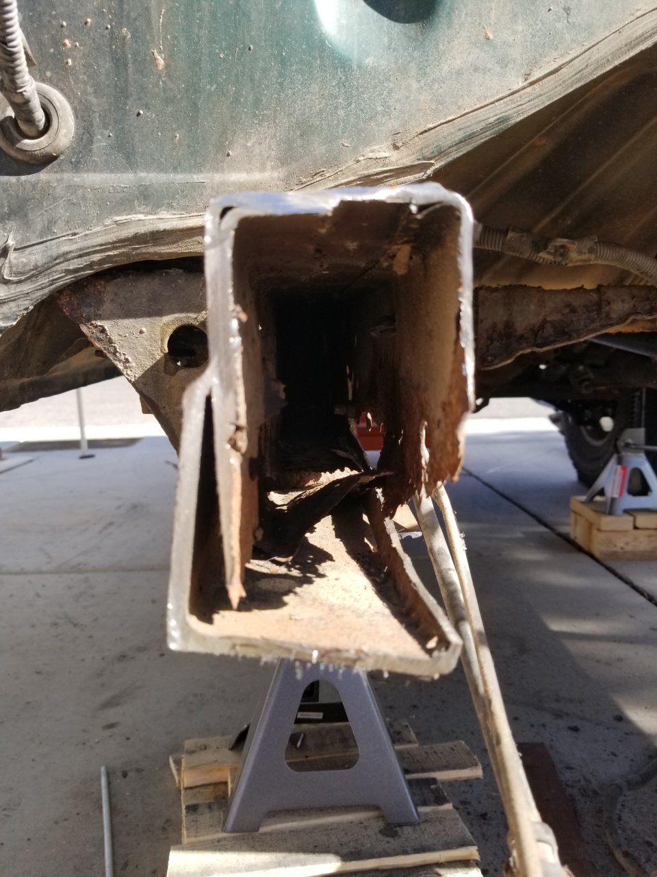

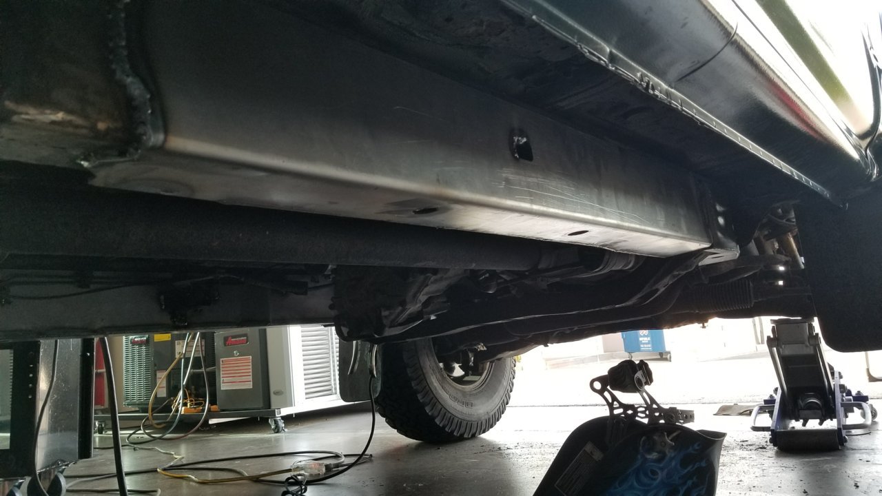

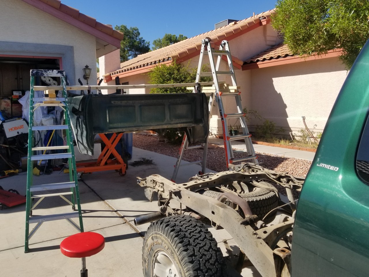

    This guy is in Banner Elk, NC his was stolen and they rolled it. It has had the frame replaced. I got a price from him for the whole truck minus the flat bed and it was a good price.
    There is some places here that you can get a clean frame for less than $500 ONe guy was selling a 4x4 rolling frame minus the rear axle, but included entire front suspension, brake lines flue lines wiring and all for $500

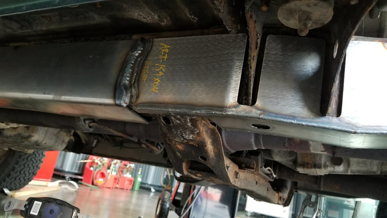

    What I did was used these as I had time and afford https://www.autorust.com/product-category/toyota/tacoma-xtracab-4wd/
    It worked and it worked well. I kept finding more and had to do another section, and another and another until now I have a new frame basically caped over my old one.

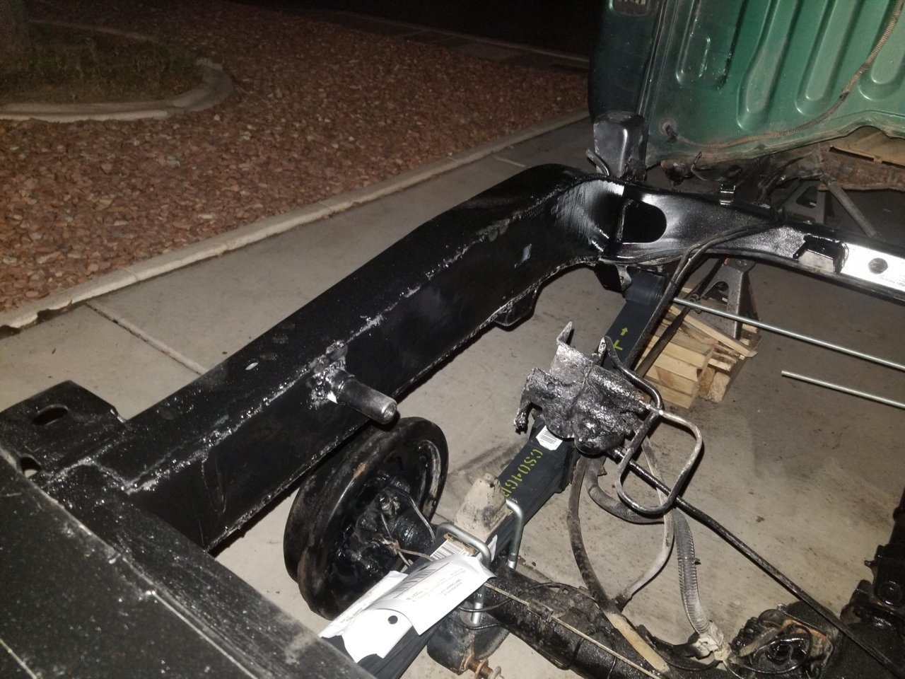

    By the time I took the bed off I had this great idea to cut the back off and weld a new rear section on and used the old frame to box it in. WOW dont do that. Boxing the frame is one thing, but cutting one and re-welding is another. Now befor I get bashed, I used 1/4 plate on the inside, stair stepped it, and used the safe-t-caps over all those welds too. its stronger than it was new and heavier with all the extra steel. The problem is getting it perfectly aligned. just a little bit of welding is enough heat to throw it all out of alignment again. I had measurements, cross measurements and a ton of jigs I made and come along, straps, cables and chains to hold everything perfectly in place. I did it, but WOW that was way to much work. Im good at welding but that weekend project turned into over a month of work, after work and 3 day weekends working day break to 11pm every night.

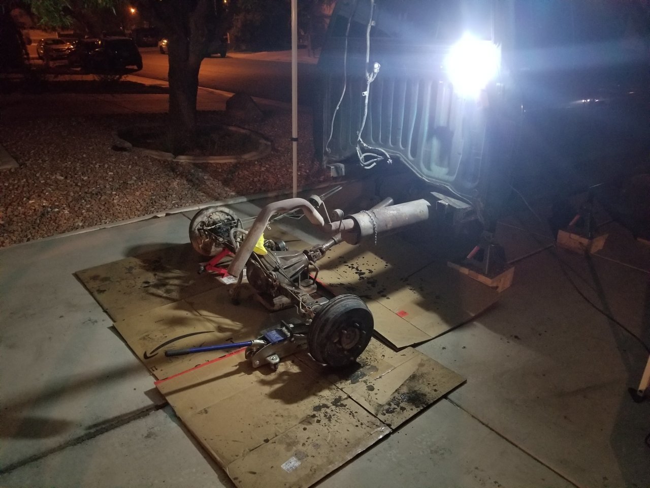

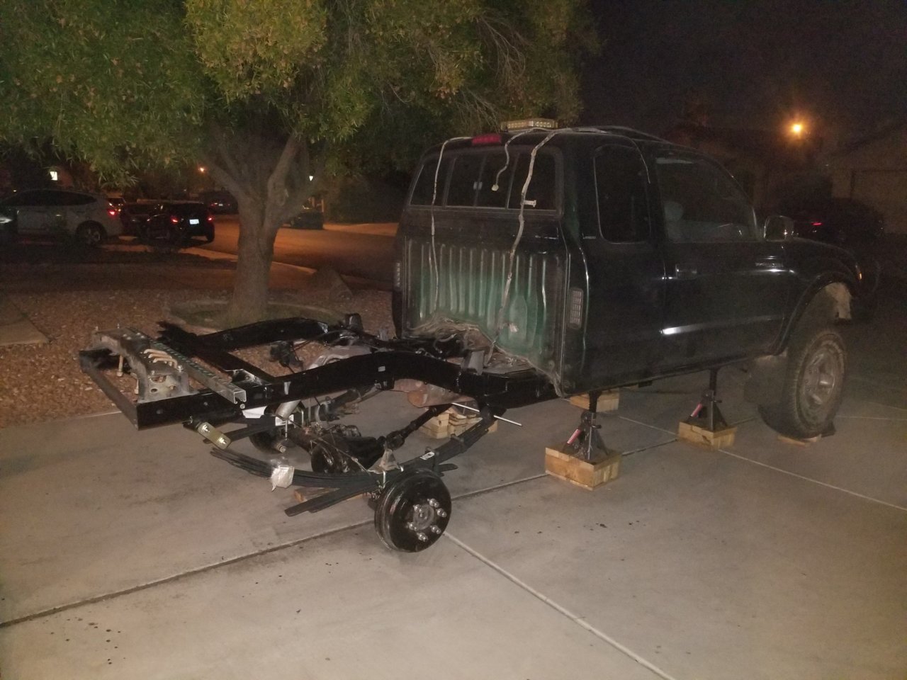

    If I had it to do over again I would have done a frame swap. It is not nearly as bad as it sounds. there are some great videos on how people do it without pulling the engine.

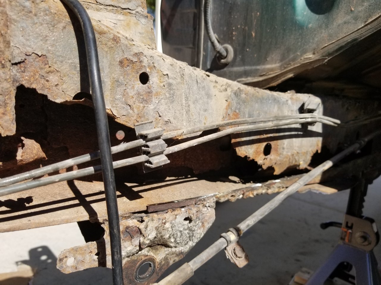

    20180319_111115.jpg 20180319_181345.jpg 20180401_180220.jpg 20180401_180232.jpg

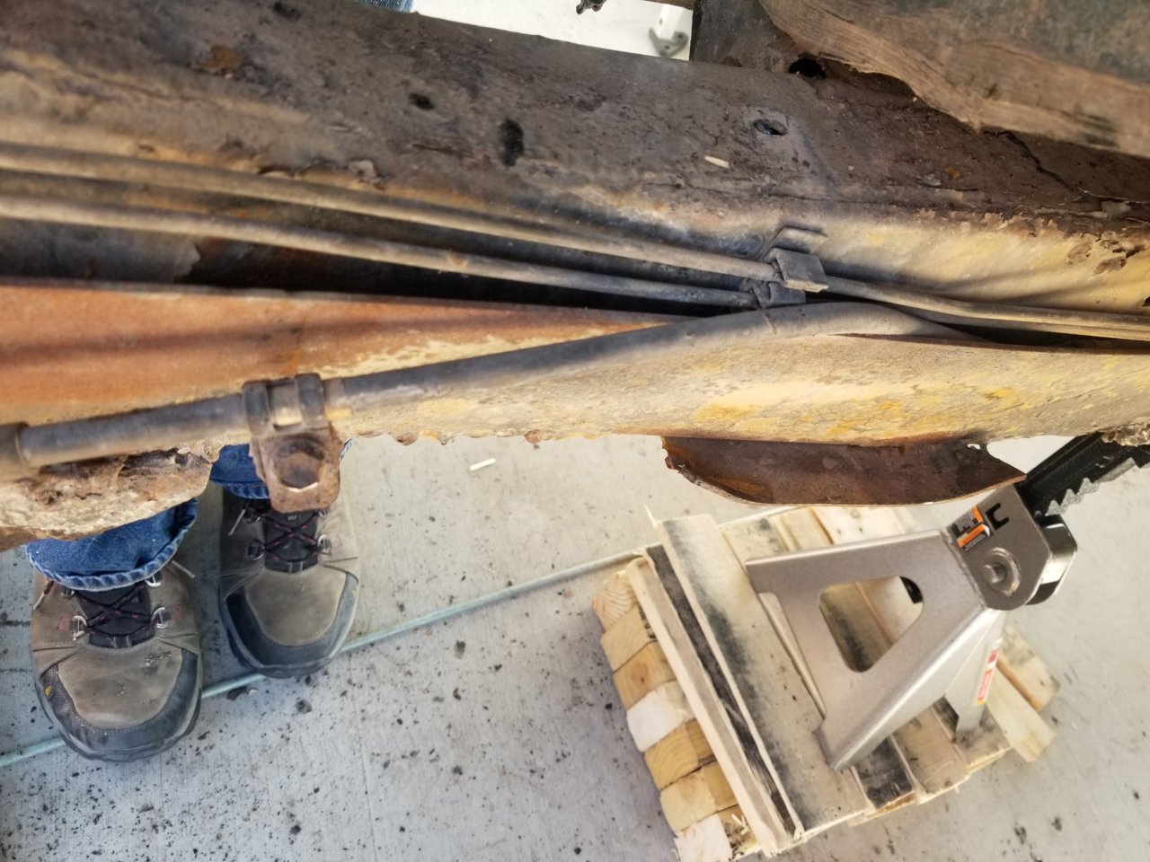

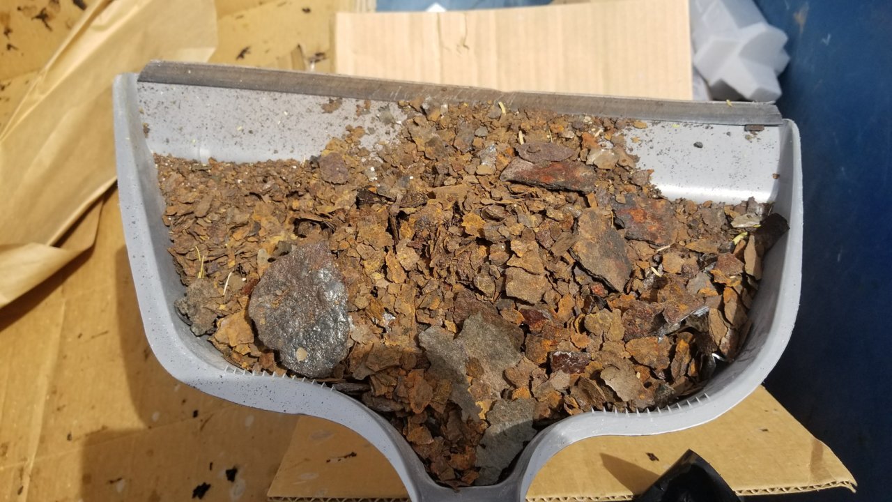

    The rest did not look bad at all. This is what itlooked like after a ball pen hammer. The truth is underneath.
    Also these where taken befor the welding was complete
