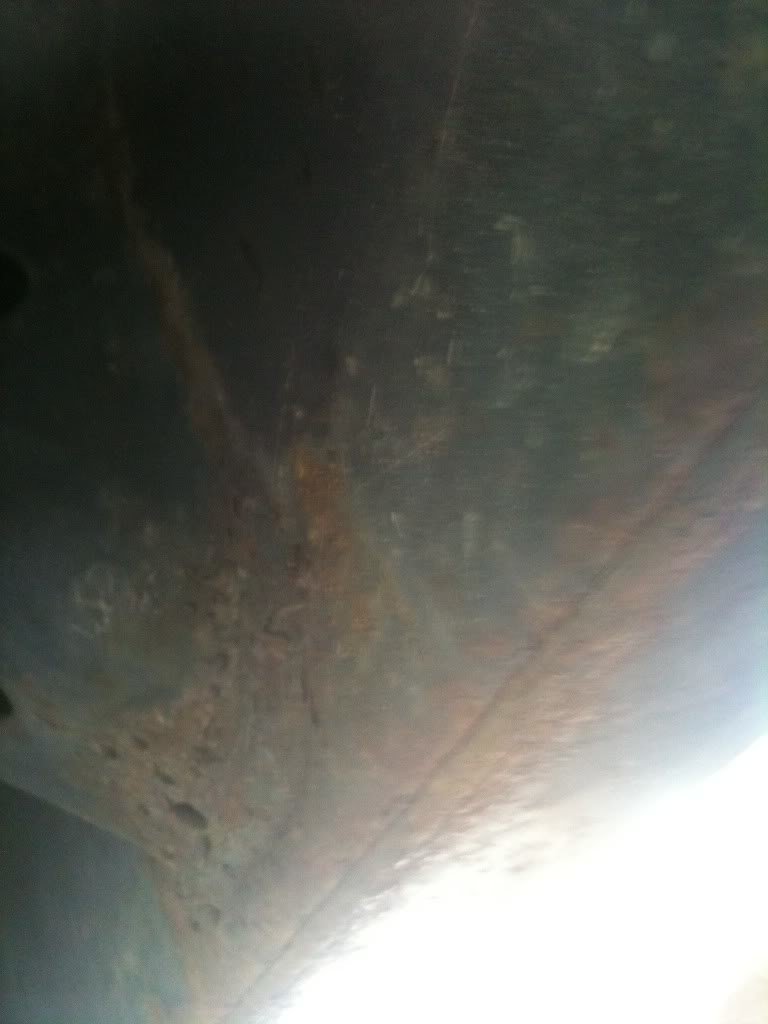

    I didn't realize how bad it actually was!! Got under there looking and it looks terrible! Here's some pics of it.

    The rust occurred during the recall period and if you called as soon as you got the notice, I'd try again to see if something can be worked out since it seems they may have gotten the letter out to you late. I would not deem that as safe.

    I dont see any holes...
    I have seen much worse

    Are those little holes or that normal? :confused:

    I dont think the holes are from rust; they look drilled. Since there is one above it.

    The little ones around the big one?

    idk...that pic is too crappy. Those just looks like shadows to me.

    in the pics im seeing more surface rust then deep rust spots.
    Pics are hard to tell but from what im seeing.

    They are supposed to smack the frame with a hammer. If the hammer goes through they fail the frame. I don't see a hammer hole in those pictures.

    I'll can take some better pics if you all would like? I couldn't find where they hit it with the hammer I searched for ever. I've hit it with a hammer my self after they did to see how bad it was and it seemed pretty solid never went through any where I tried.

    They hit the frame w/ a hammer and if the hammer penetrates the frame, or the strength is suspect; they will fail it.
    The biggest area of concern is the inside of the frame right by the front leaf spring hanger.
    If there are no holes in your frame you should be fine.
    I would just clean as much of the rust off as you can and coat the frame with some anti-rust paint of coating.
