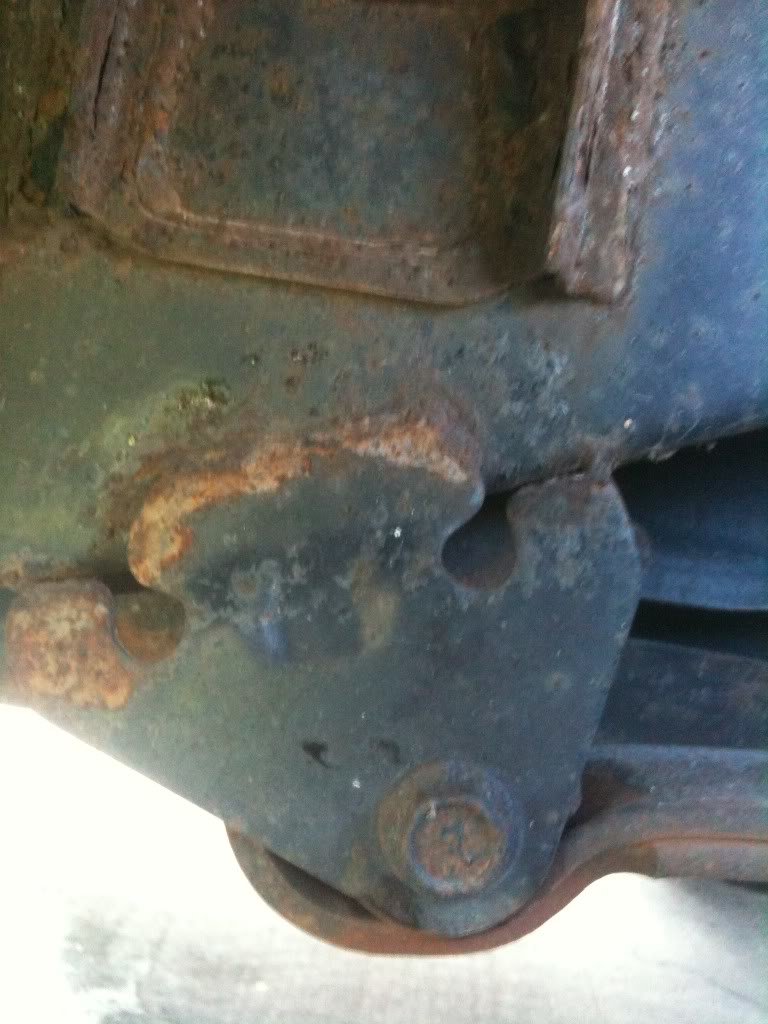

    mine is/was much much much worse than that. it looks like you have surface rust...no rot.
    I spent a few days with a pneumatic needle scaler, a wire brush, and some POR15 rust paint, and I have no reason to doubt my rust issues are done for a few years.
    I'll probably have to do it again sometime, but that POR15 is good stuff.
    will post some before and after pictures soon

    TacoMX is right, my 98 went at that spot, but my 2002 went at the inside frame rail just infront (towards motor) or the rear crossmember. Have a look there, that's where the tech said most of them have been going, at least in that shop.
    Oh, mine both just looked like bad surface rust. They are rusting from the inside out, so it's hard to tell just by looking at a frame from the outside.

    the main point here is that there is no hole in his frame from a hammer...which it takes to fail.
    if there is no hole, its surface rust, which can be slowed down successfully with proper prep and coatings

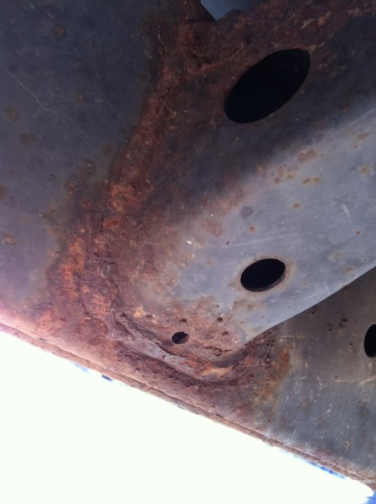

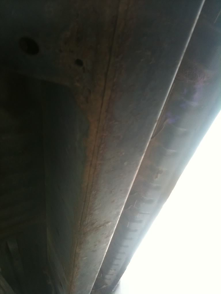

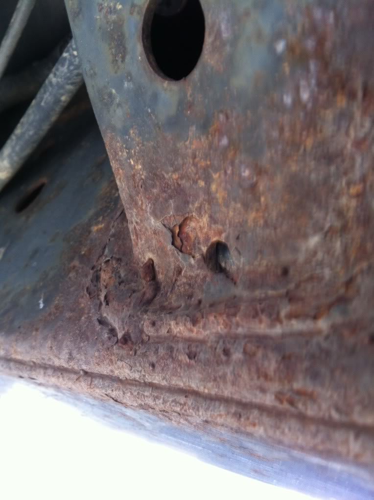

    You think that's bad? That looks damn good for a 15 year old truck. Only issue I see is in the first pic. Looks like you might have some perforation holes.

    I said earlier that those holes would concern me and everyone said no. :(

    They would concern me if they were rust perforations.

    Aren't you and I talking about the same holes?

    These?

    Yes. Isn't that the same as in the first pic you referred to?

    Yes, but it's hard to tell if the holes are actually rust holes (except the two obvious stock holes)

    Woops a bit behind. I would be concerned with those holes for sure.

    need more pics of these "holes" :cool:

    Here's the hole in my frame after the hammer, there weren't any holes before the hammer hit it. Pretty bad looking surface rust though.

    They do look like rust perforation, I agree with you :D

    I definitely don't have anything like that in my frame i just searched from front to back and couldn't find anything!
    rgr here's some more of the holes. They look pre-drilled and the other"holes aren't actually holes as they look its just the black paint chipping off.
    Driver Side:
