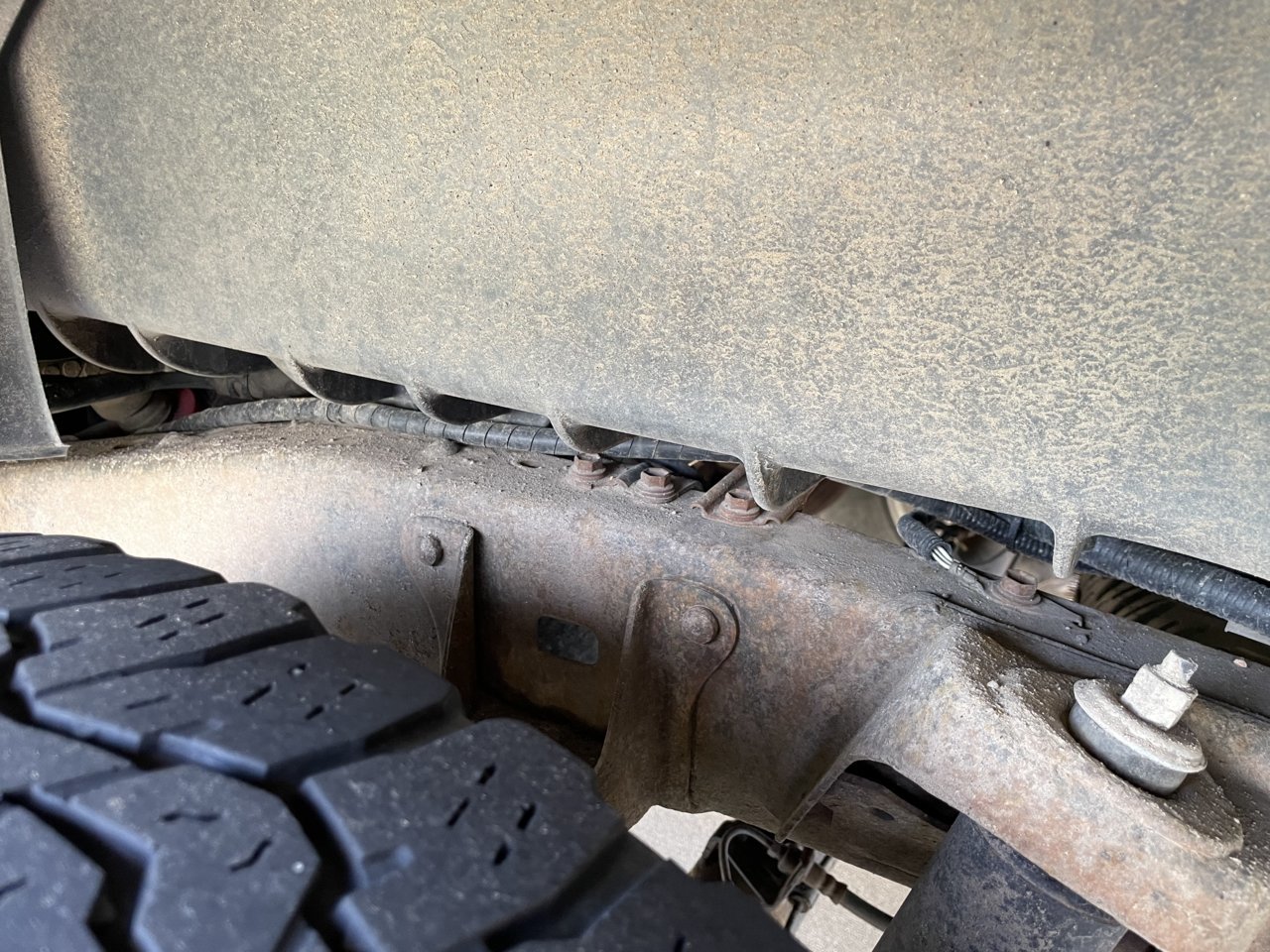

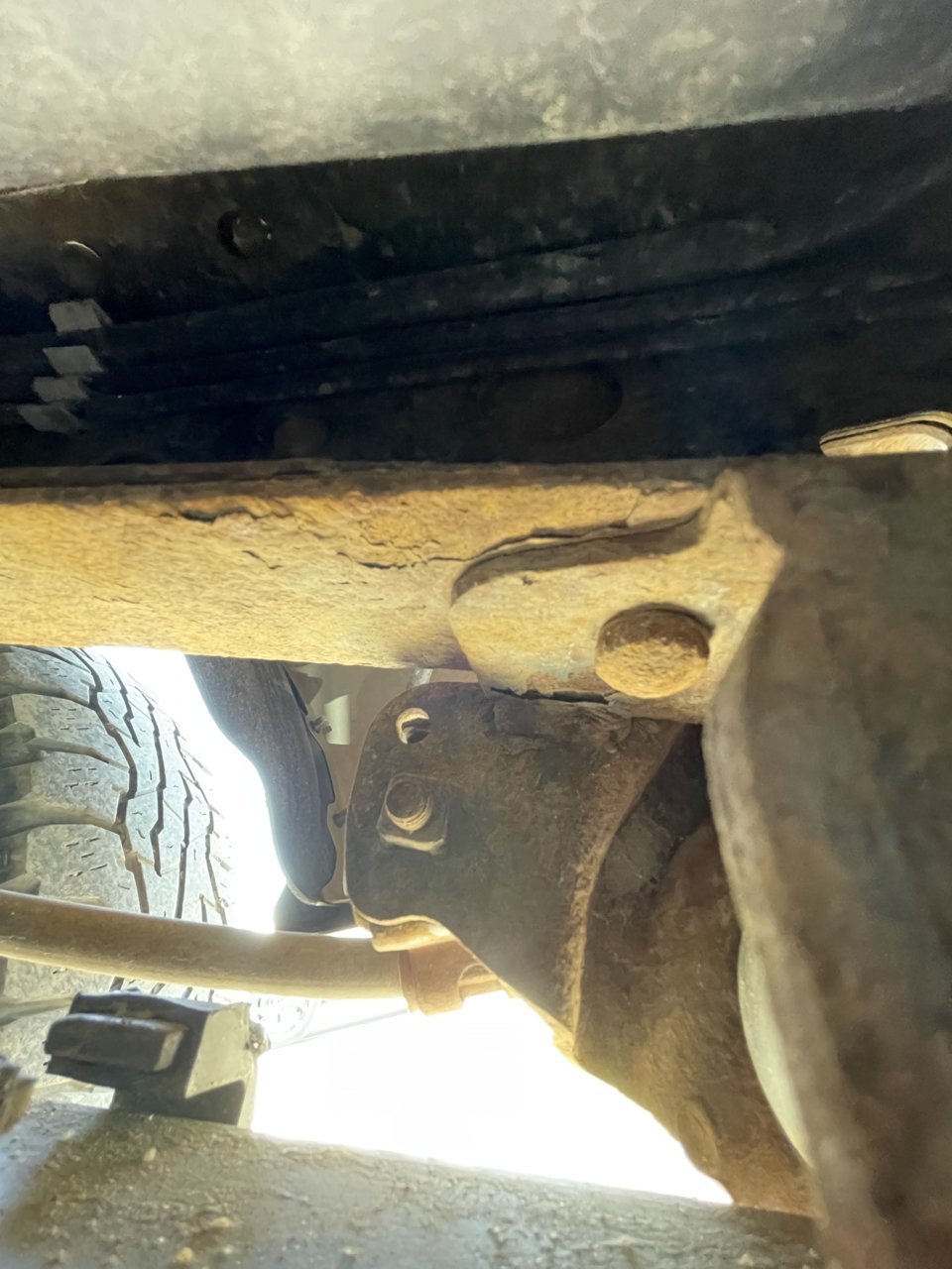

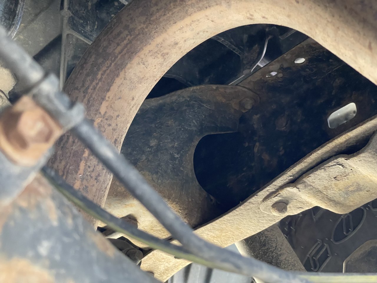

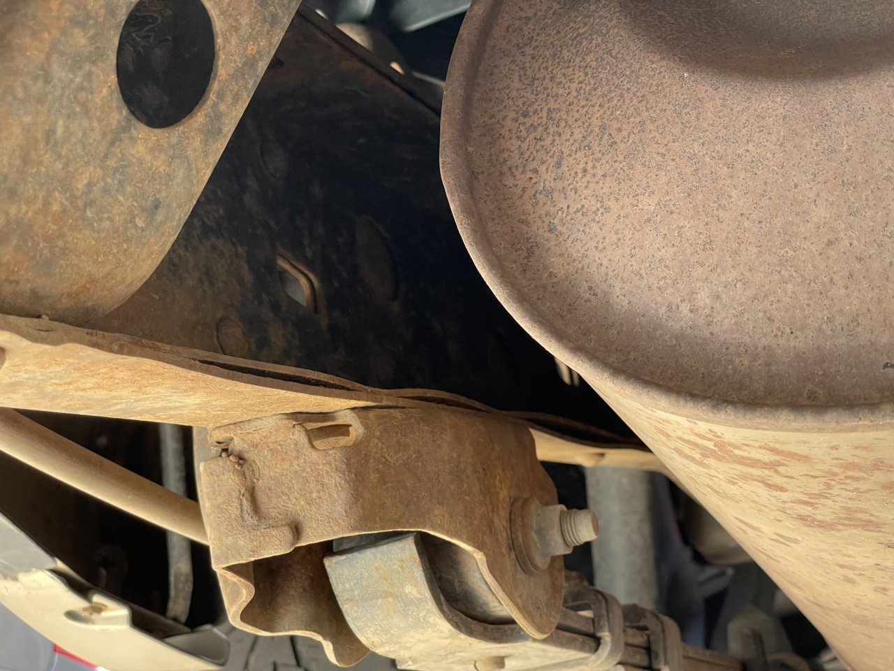

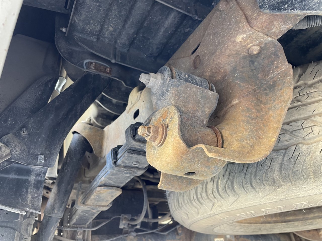

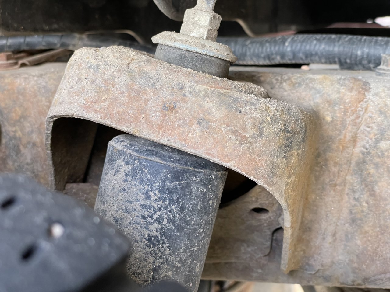

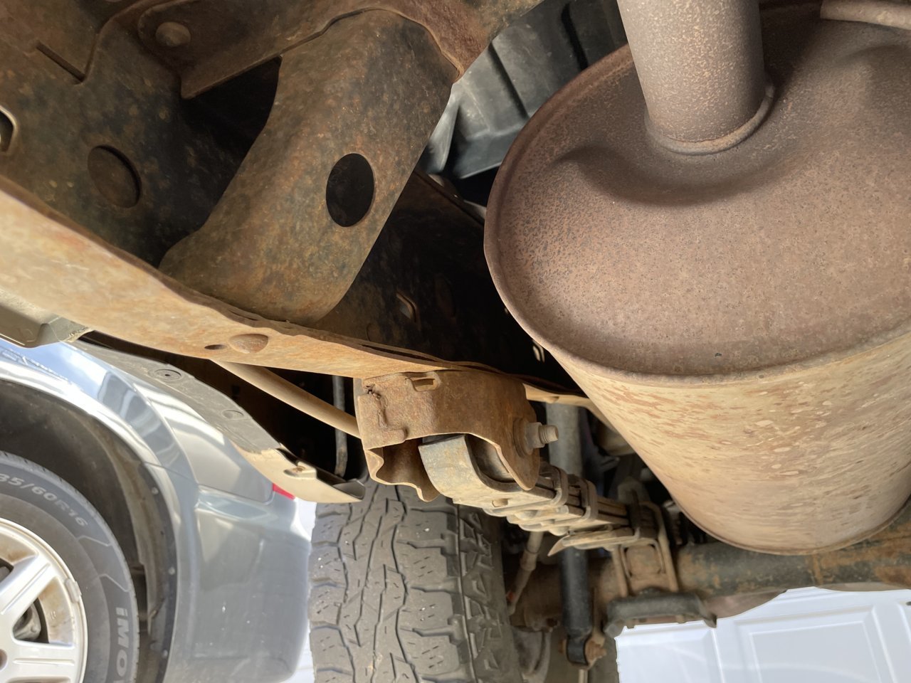

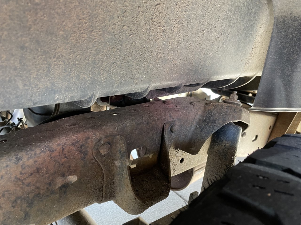

    West Texas / Colorado truck its whole life. 220k miles. Lots of extras included, but the frame rust is riiiiiiiihht on the edge of what concerns me.
    I see no perforations and only moderate delaminating but… I’d love some opinions from the community.
    What do you think? C0BF1074-8D1C-4D0F-B1F9-4053A209E4A3.jpgA3F3E789-A8DA-46A3-AECC-A618FAAA1748.jpg5B83300A-CF38-41A9-A40B-4981D487D018.jpg

    to my untrained eye, it doesn't look too bad :notsure:

    Most of these older trucks had the frame replaced. I like to lightly tap on it with a wrench and use my ear to see if the sound gets different. Go down the frame Ping Ping Thud is bad. Obviously flaking and holes are the worst but this doesn't look bad at all. Its slightly worse than my 06 cali bought but no where near my Michigan bought 06. The Michigan truck looks worse but it's more the body that's rusting and frame thou rusty still has that ping to it. That said I'm no mechanic, Good luck.

    It’s not horrible.
    There is still some life left in it from what I see.
    The last picture is starting to show signs of delamination.

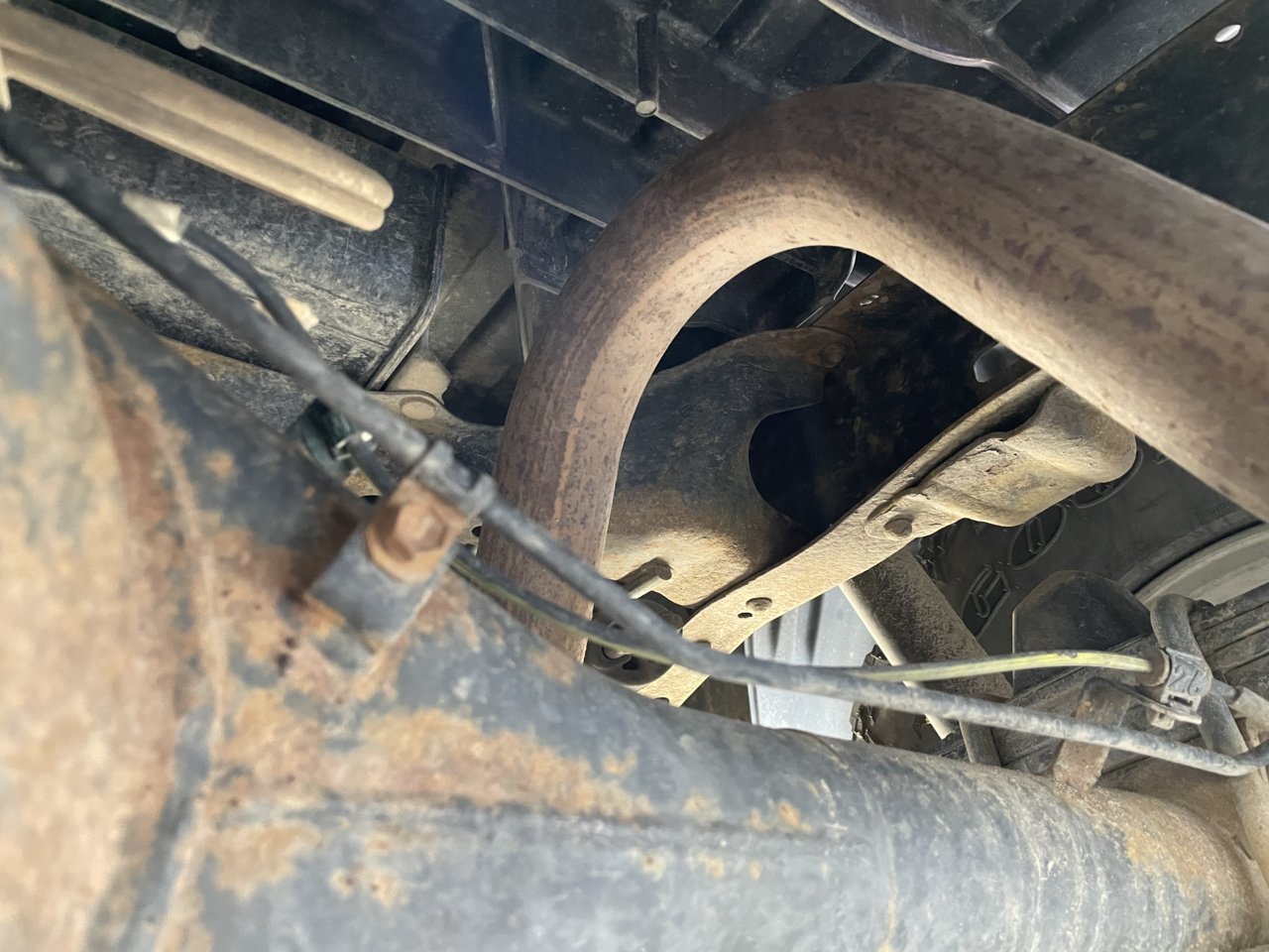

    You really need to check the inside frame rail next to the converters.
    The drivers side is the worst. As well as the rear section of the frame above the rear wheels.

    This here appears to be the worst of it, where the driver side leaf spring mounts to the frame

    That is not bad

    It’s bulging. Walk away. Unless they want like 3k for it.

    At the end of the day if this thing is gonna last me 5 years I’m gonna be happy with that. I can hit the exposed portions with a wire wheel and then treat it, but that won’t touch the flaky biscuits trapped between the frame pieces. That’s my concern. If I can get 5 years I’ll take it.

    Frame looks OK as far as pictures go. You haven't posted the worst areas which are around the catalytic converters and cab mounts.

    The frames rust from the inside out.My 2009 had the frame replaced because of the frame rails separating and a small hole near the catalytic converters.

    Thanks everyone for the replies and wisdom. I’ve attached pics here of the frame rails in the areas mentioned (final couple pics are from around the cat - haven’t yet snagged any from around the cab mounts)
    manufactured January 2006!
    haven’t been able to spot a leak anywhere at all. 6D95E177-F9FD-422D-8766-C1CEEF6DECD2.jpg87CE0D81-06C1-4E91-A9B7-26FFF7C38D68.jpg93691897-5FD8-4AE1-81A0-1AF744105067.jpg9931A538-1964-41E4-BB76-631CC2174267.jpg3EBAB6F5-947B-4613-A297-0E519AFA08B6.jpgF8EE880A-4F10-4804-8F5B-BCD00DFA1A65.jpgA6B21C3D-3901-4564-89C2-575792A93C8C.jpg0D9F05EB-C6AA-4A43-80F5-498B1567F69E.jpg6D95E177-F9FD-422D-8766-C1CEEF6DECD2.jpg 87CE0D81-06C1-4E91-A9B7-26FFF7C38D68.jpg 93691897-5FD8-4AE1-81A0-1AF744105067.jpg 9931A538-1964-41E4-BB76-631CC2174267.jpg 3EBAB6F5-947B-4613-A297-0E519AFA08B6.jpg F8EE880A-4F10-4804-8F5B-BCD00DFA1A65.jpgA6B21C3D-3901-4564-89C2-575792A93C8C.jpg0D9F05EB-C6AA-4A43-80F5-498B1567F69E.jpg
