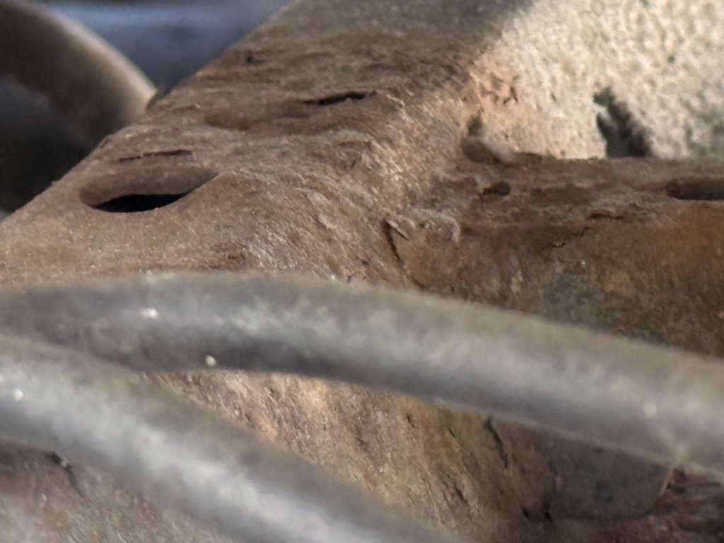

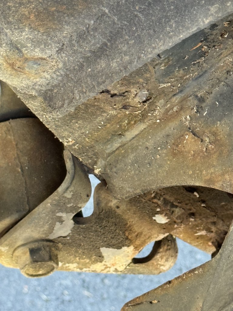

    Should I be concerned about this rust on the frame of my 2001 Tacoma or is it just surface rust?

    yes,
    its pitting and cracking/flaking
    don't know how far gone it is but it needs TLC ASAP

    At a minimum I would hose that baby down with fluid film. What else you do depends on the condition of the rest of the frame and how long you want the truck to last.

    Id clean it up so you can see what youre working with. It doesnt look terrible at a glance though.

    Yes!
    Rust never rests, and it has killed many a Tacoma frame

    Clean it up and get Waxoyl for inside and outside frame. Doesn't look bad what you showed.

    Start tapping it with a ball peen hammer.

    Do you have any more pics?, OP?
    To see what dealing with in other areas
