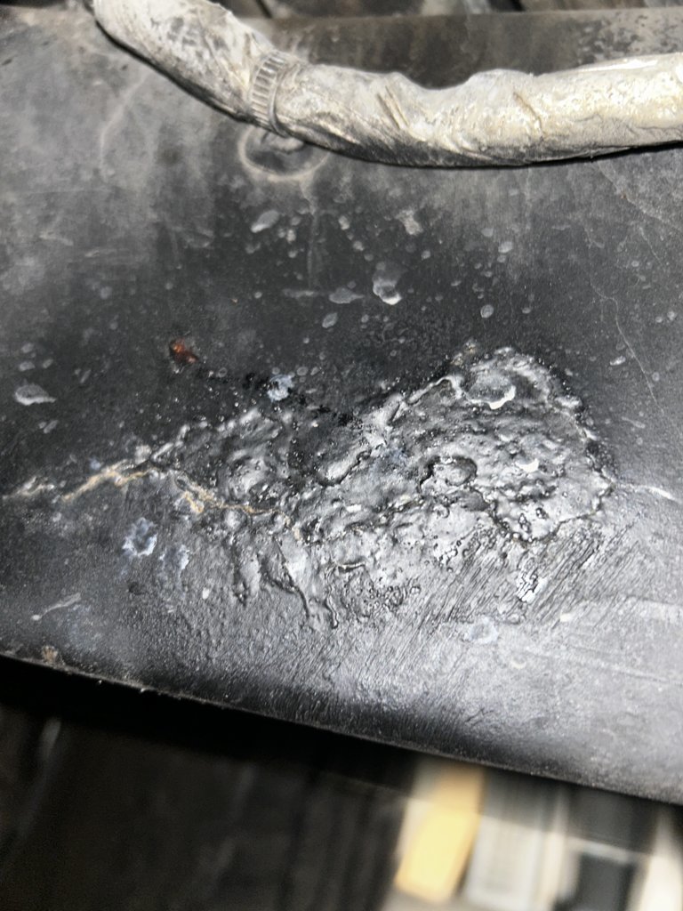

    I have noticed some semi concerning rust on my truck since I purchased it about a year 1/2 ago the previous owner coated the frame with some rubberized coating but missed some spots I have looked under the coating in some spots but there are some questionable rust areas.

    Is the amount of rust bad should I be concerned? is the question.what can I do about the inside of the frame.

    It's mint for a second gen.
    Typically if you can still see the original black coating its in good shape.

    Ok are you taking about the inside of the frame I have wirewheeld and painted the frame rails I haven’t touched the inside of the frame.

    Doesn’t look crazy either way

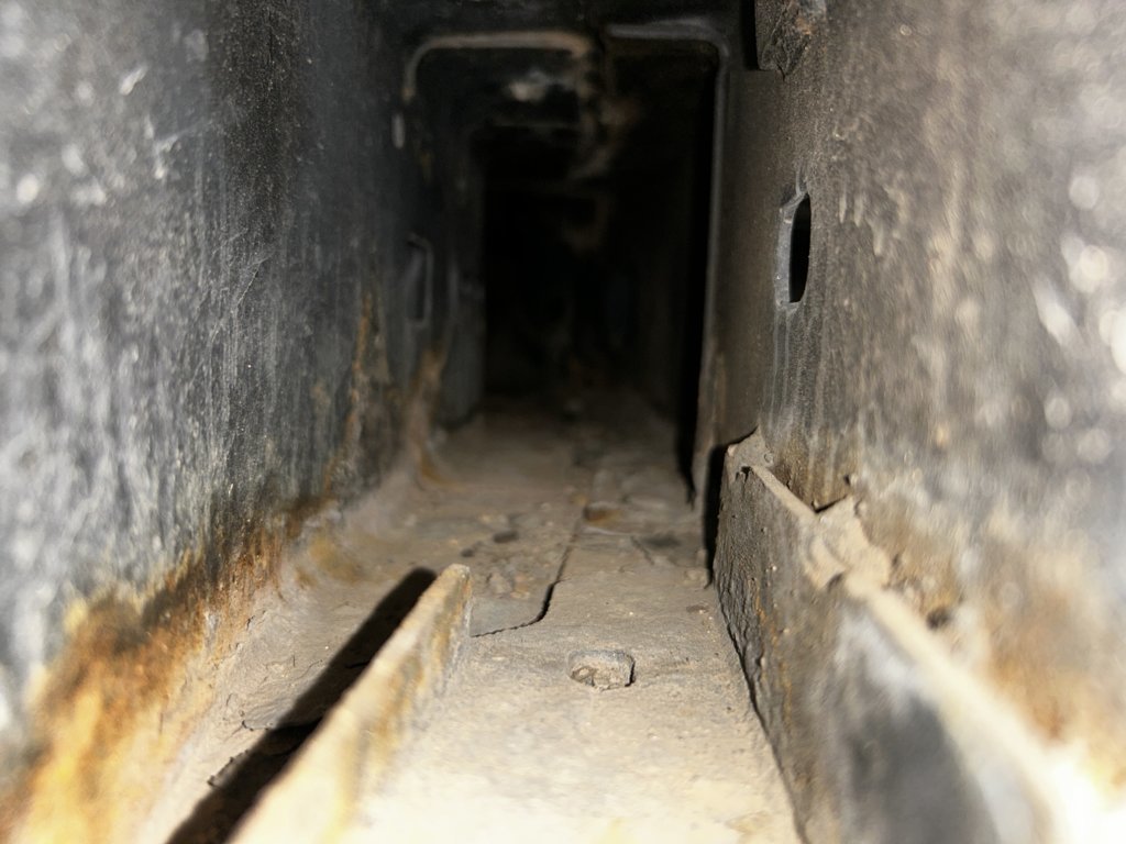

    Learn the three f's
    Fluid Film is your Friend

    Fluid Film, Krown oil, or Woolwax....they can spray inside the frame channels

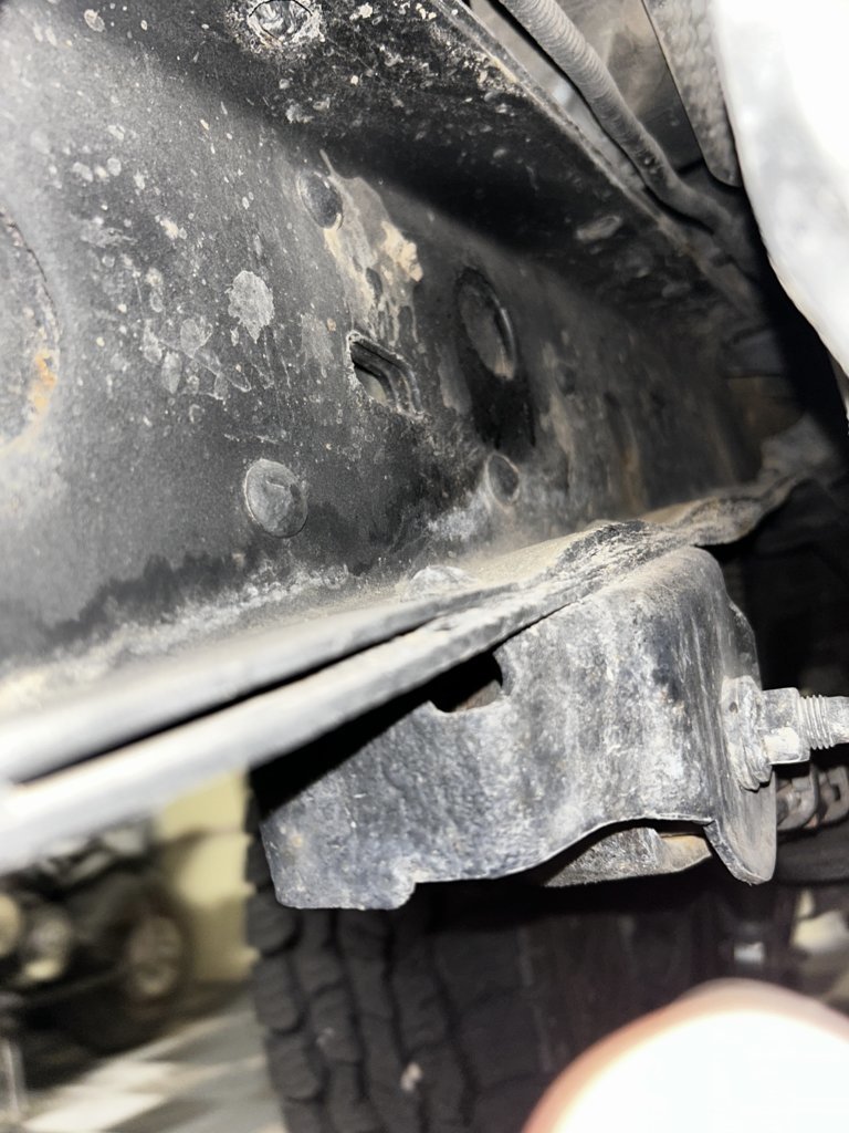

    The pic that shows the double layer where the leaf spring mount is it- you can see where the metal is already starting to delaminate. Do you need to scrap the truck tomorrow- no, but the clock is ticking.

    What can I do about the part that is delaminating.

    Treat it with a rust preventative to keep it from getting worse.

    I don’t live in the rust belt, were can I get fluid film is it like a oil.

    You can order it online, or I think Lowes and ace carry it in store

    Where do you live? Im curious to see if there are dealers near you. and yes you can buy it online, but having it sprayed in by a professional would be better

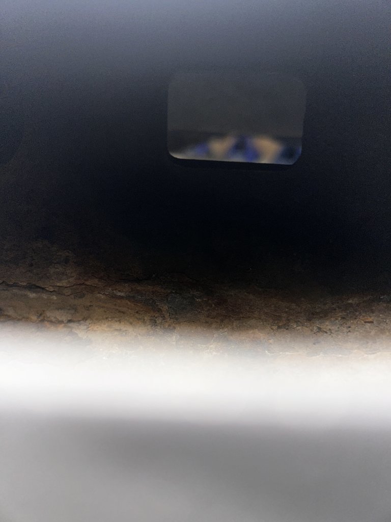

    Hunter gatherer
    Hunter gatherer Well-Known Member
    Aug 25, 2013
    #111142
    603
    Andy
    Lillooet B.C.
    13DC4X4BaseModel
    The last pic looks a little concerning. Personally I would seriously consider unloading that truck and looking for a cleaner one. It’s not bad now so it’s probably still sellable for s decent dollar.
